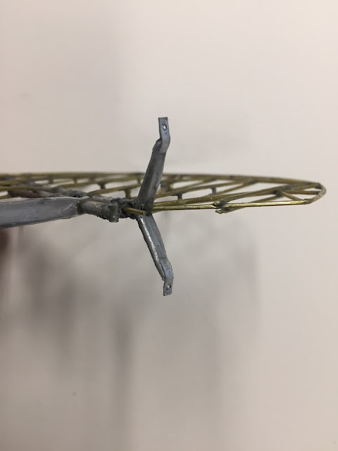

Bil Posted October 30, 2017 Author Posted October 30, 2017 (edited) RUDDER & FIN - Details For the rudder I added the hinge components and the leading edge fairing, which is shown cut out of thin aluminum and shaped in this image: I also added the rudder wire connection tabs to the rudder horn, I did round the ends off later, this image shows the base construction: A test fit of the rudder and fin hinge connections: For the fin I added the support wire bracing lugs (just beneath the top rib) and the leading edge fairing.. note that the fin leading edge fairing in this image is not the final, I was dissatisfied with it, ripped it off and remade the fairing.. second try was MUCH better. Finally a coat of gray primer was given to both the fin and the rudder and they were joined together, for no other reason than I was curious as to how they would look. Note that this will not be the final color, that will be chromium oxide green. I do still need to add the tail light with wire conduit and the trim tab to the rudder. The hinge rod is only held in by friction, I want to be able to remove the rudder for additional painting/detail work later. The real thing: Bil Edited October 30, 2017 by Bil Sparzanza, KiwiZac, Trak-Tor and 5 others 8

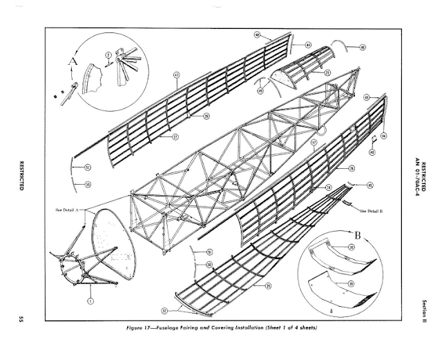

Bil Posted November 3, 2017 Author Posted November 3, 2017 I have been working on the fuselage frame recently, some reference drawings: After completing one side of the frame my progress looks like this: Looks nice I think.. however after completing my read through of Airscale's Spitfire Race 80 thread I came to realize that I've been taking too many shortcuts and have been too cavalier with the build quality.. so I am going back to the drawing board on this and will be rebuilding it with a closer attention to detail this time... and better planning. I doubt I will ever be at Peter's skill level (but who knows? ), but I can at least learn from him and pay closer attention to the details. More later after I regroup and try again. Quality without compromise, eh? Bil Sparzanza, sandokan and 109 3
