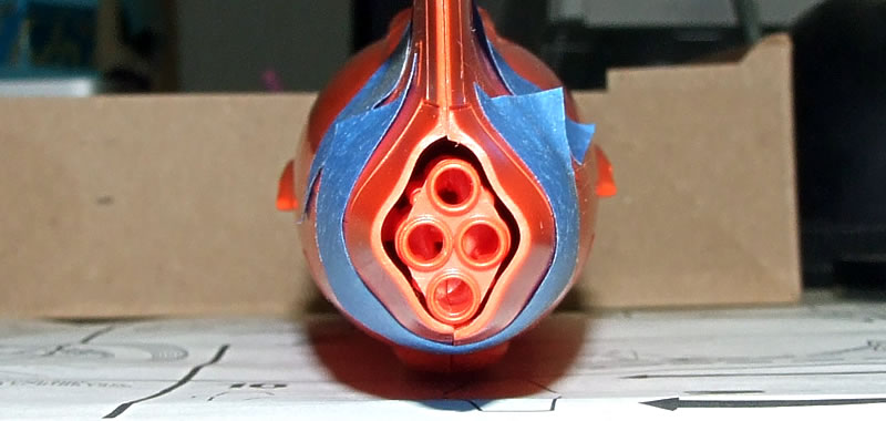

ollieholmes Posted August 8, 2016 Posted August 8, 2016 Well next on my bench is this kit. Im awares its rather basic and there are fit issues with the nozzle part at the rear. This is part 1 of my 2 part build of record breaking mini group build. Part 2 will be the X15. Hubert Boillot, F`s are my favs and paul fisher 3

LSP_Kevin Posted August 8, 2016 Posted August 8, 2016 Nice choice, Ollie. Check out Eric's build for some inspiration. Mine's still stuck at the nozzle doesn't fit stage. Kev
ollieholmes Posted August 8, 2016 Author Posted August 8, 2016 Nice choice, Ollie. Check out Eric's build for some inspiration. Mine's still stuck at the nozzle doesn't fit stage. Kev Kev Have you got a link to Erics? Ive seen your thread and ive got an idea for a way around it myself.My plan is to scrap the kit bulkhead and make my own from plastic card and then open out the holes for the pipes.

Theo Posted August 9, 2016 Posted August 9, 2016 Hi, Ollie just build this, ready for paint. Paint is FS 12300, I bought Tamyia X-6, it is close but could need a bit more brown in it. It is a basic kit, just need all panellines to do as they are raised. And Yes the end of the rocketengine does not fit. I cut all engineexhausts of and made a new backend from Evergreen sheet. Should be piece of cake, good luck. Zero77 1

paul fisher Posted August 9, 2016 Posted August 9, 2016 Might be able to adapt the back plate from my X-1A kit? trim it to fit inside the opening? Have to build one of these my self to go with the X-1A Paul Zero77 1
