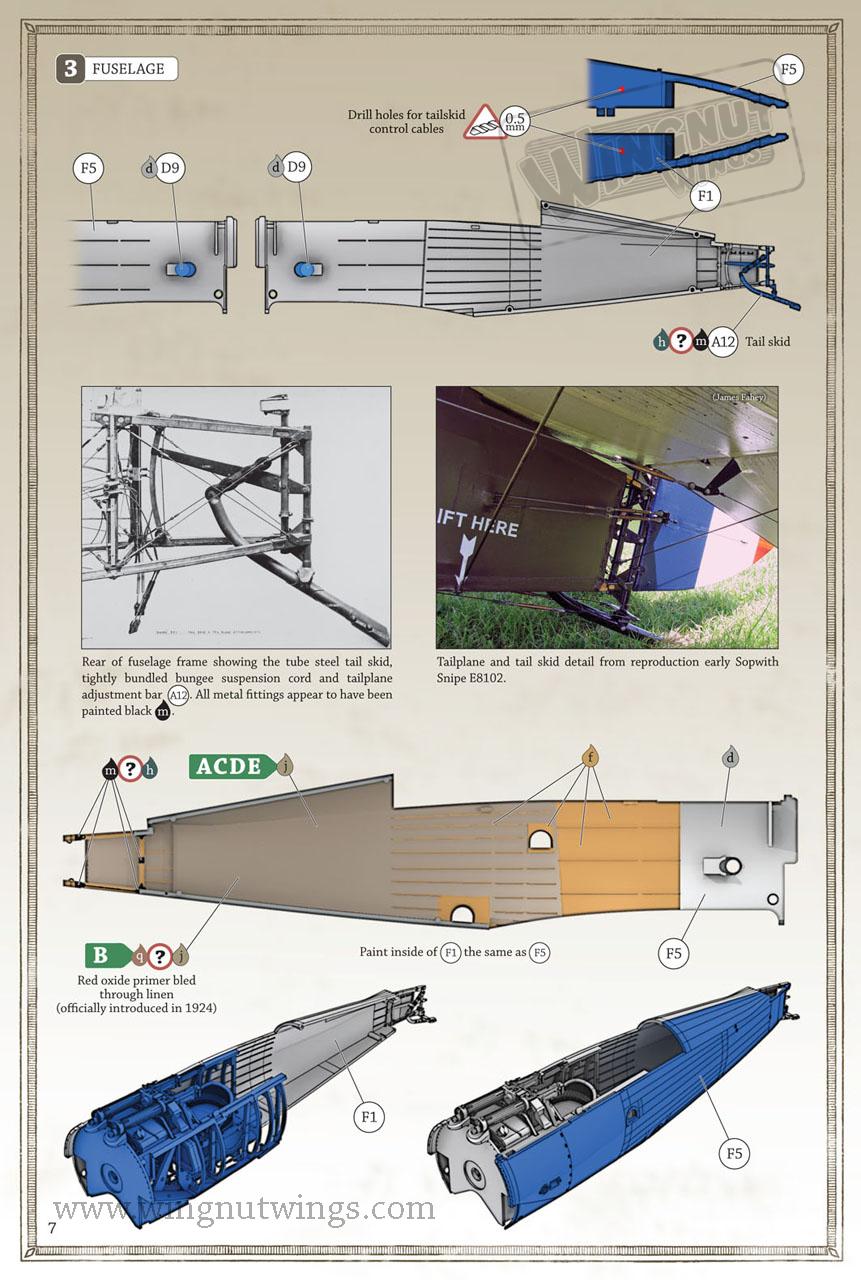

Out2gtcha Posted July 5, 2014 Author Share Posted July 5, 2014 (edited) On to progress then! Sorry its been so slow on that front, but modeling time is at rarity these days, (hence starting this build) and Id rather my time be spent building than devoted to R & D. Part of the reason progress is so slow, is the first stages on this build entailed prepping and painting a bunch of wooden surfaces. This is one reason I do like the oil over acrylic wood grain method, is yes the decals look great, and I like them for certain applications, but in certain circumstances they just aren't practical, if not impossible to use. This is one of those times...................... The wood grain is on things like the fuselage/cockpit ribs, as well as the instrument panel, and wooden ribs between primed fabric. All of these areas would make using wood grain decals almost impossible. Using the oil/acrylic method here to simulate wood will also get me a chance to better match the wood grain on things like the IP and fuse ribs, to larger flat surfaces like the inside of the fuselage walls. The instructions call out for the red oxide primer coming into production in 1924, so my air-frame is the only one that seemed to qualify for this, so that is what I went with. You can see here how my masking went over a coat of red oxide primer, and the areas Im painting wood: The disadvantage of the oil over acrylic method is the wait time for the oil to dry. I have solved this to my own personal satisfaction when I started to thin the oils with Japan Drier. Mostly, you are supposed to mix the JD with oil thinner, but I skipped right to the punch, and found the thinning w/JD only takes the wait time for the oils from what seems like a week or two (and sometimes IS!) to just a day or two. After the masking was applied over the red oxide, I laid down a coat of XF59, and started going over it with the oil, mainly using burnt Umber, and in two sections you can see for tonal difference, burnt Umber lightened with some white. Using a cocktail stick I also incorporated a few knots and variations in the wood for some visual interest even though I know its likely not accurate (you'll have to excuse the cat hair) : The cockpit framing, IP, seat, floor boards, were all done with straight raw Umber: MORE................... Edited July 5, 2014 by Out2gtcha Uncarina and Whitey 2 Link to comment Share on other sites More sharing options...
Out2gtcha Posted July 5, 2014 Author Share Posted July 5, 2014 (edited) I put the XF59 on late in the afternoon on Wed, and let that dry 24 hrs. I then put on all of the oils in the afternoon on Thursday, and today I went down and all of the oils were dry, and I was able to spray a very light coat of MM flat lacquer clear over the wooden parts to tone the sheen down. The tonal differences are still evident even after the flat clear, just like I wanted: I left work early on Thurs, and had the 4th of July off, as well as today, Sunday and Monday too. I plan on getting as much work done on this thing as I can in that time, so I will hopefully be progressing more on cockpit getting the detail painting started on all of this, and will be able to unmask the inside of the fuse. I MAY even get around to foiling the inside of the fuselage in the appropriate areas. Cheers till next time gents! Edited July 5, 2014 by Out2gtcha Uncarina, Mal_Belford and Whitey 3 Link to comment Share on other sites More sharing options...
