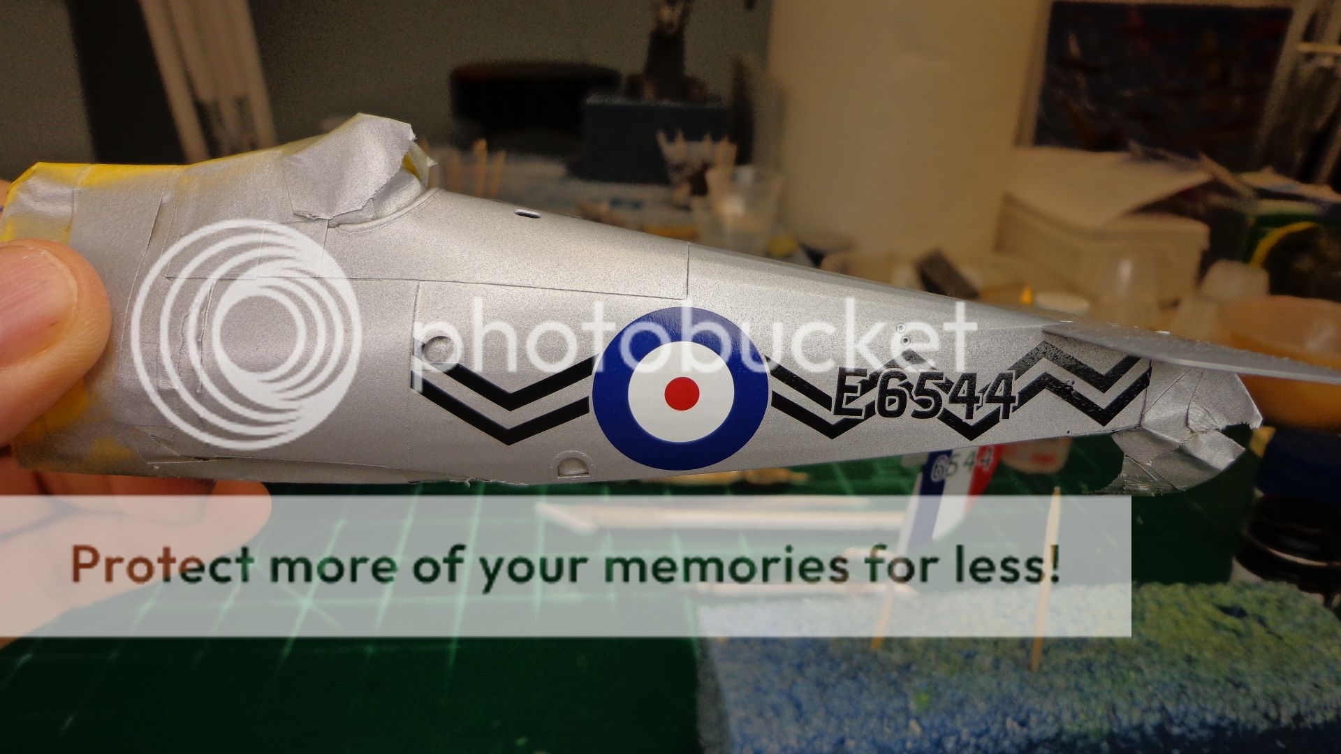

Out2gtcha Posted July 19, 2014 Author Posted July 19, 2014 Once I had fettled around with the wooden stuff for a day, and the clear had a chance to harden off for 24 hrs, I got to work on some of the fun stuff.....................DECALS! Normally I like to use paint masks, but Ill make an exception for Sir Peter! These decals are by Cartograf and are EXQUISITE. If you have never used WnW decals they are in fact similar to magic. What I mean is they go on exactly like what you would hope all decals go on like..............they are VERY strong when needed, but yet still thin, they are always in perfect register have barely ANY carrier film, and what is there almost always disappears over a clear coat. For the most part they snuggle down VERY well to their surroundings, but I still like using some Micro-sol on them, as I feel the SOL seals any edges (like by the control surfaces) and makes the decal more permanent, and takes care of any minor areas where the decals didnt want to snuggle down as well as I like. These WnW Cartograf decals were no exception to the rule, and went on like a dream....................WnW even give you little "notches" in the decals for the wing roundels, so they are just about idiot proof from a placement perspective: Tiz all for now ladies and germs......................Im back off to apply a semi-gloss sheen over the silver dope and decals. They l'll likely finish wiring the engine, and try to maybe assemble and paint the under carriage and wheels at some point as well. Cheers! Iain 1
Guest Peterpools Posted July 19, 2014 Posted July 19, 2014 (edited) Brian Your decal and wood grain work is the benchmark of perfection! Totally enjoying each update and always looking forward to the next. Keep 'em coming Peter Edited July 19, 2014 by Peterpools
LSP_Kevin Posted July 19, 2014 Posted July 19, 2014 Excellent progress Brian. You're turning out a great looking Snipe! Kev
