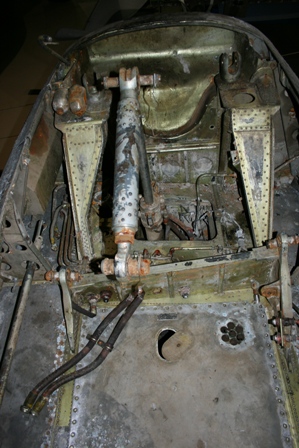

Astro32 Posted November 4, 2008 Posted November 4, 2008 Cool! Excellent shots. Another question: The main gear wells- are they finished similarly to the inside of the fuselage, or were they primed in 02? Thanks again Guttorm... these are tremendously valuable references for us! Steve McC 1

junkers88a1 Posted November 4, 2008 Author Posted November 4, 2008 the main wheelbay has the same gold colour ( looks like anodised but its not the same process as anadiose..as its electrolite process..not sure of the correct english word on that ( electrolyzed ? ) the large flat panels inside the wheelbay is grey..the rest are goldcolour and you are quite right..it does look like a spitfire on the main compass..hehe
