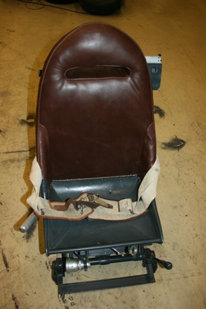

junkers88a1 Posted November 3, 2008 Author Posted November 3, 2008 maybe the pilotseat.. ?? whiskytngofxtrt and mpk 2

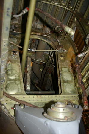

junkers88a1 Posted November 4, 2008 Author Posted November 4, 2008 the tailwheel area has not been restored but here is two pictures of the tailwheelbay i will in the future use a photobucket so i can upload high resolution pictures the fist picture is seen towards the front whiskytngofxtrt 1
junkers88a1 Posted November 4, 2008 Author Posted November 4, 2008 towards the back the big tube that goes up in the roof ( fueldump system has been taken out..you can see part of the tube on the picture towrads the front..this goes back into the fueldump whiskytngofxtrt 1

Astro32 Posted November 4, 2008 Posted November 4, 2008 Thanks for those tail wheel well shots, Guttorm! Awesome! It should be noted that the greenish color that's visible isn't 02 Grau. It's a special anticorrosive coating / treatment similar to anodising. The color is rather similar to what's found on the insides of tuna cans and the like. And it appears that the outer skin of the fuselage doesn't have that coating, just the stringers & bulkheads and such. I believe it is such because all the bulkheads and other structural formers are heat treated after forming, and require some extra anticorrosion treatment. I'd imagine the color could be made with a mixture of clear blue, green, and perhaps smoke, over a base of Alclad Duralumin, followed by a clear satin or flat. And for Pfuf: I followed your link on your '110 build. Excellent! It's given me inspiration for my own effort on that kit. Superb work!
junkers88a1 Posted November 4, 2008 Author Posted November 4, 2008 you are quite correct about the caoting..its anodised and the pictures lieas alittlebit regarding colour..its really a goldcolour when looking at it and you are also correct about the stringers and outer skin !! i tired the link on the 110 but i couldent get it to work GF
