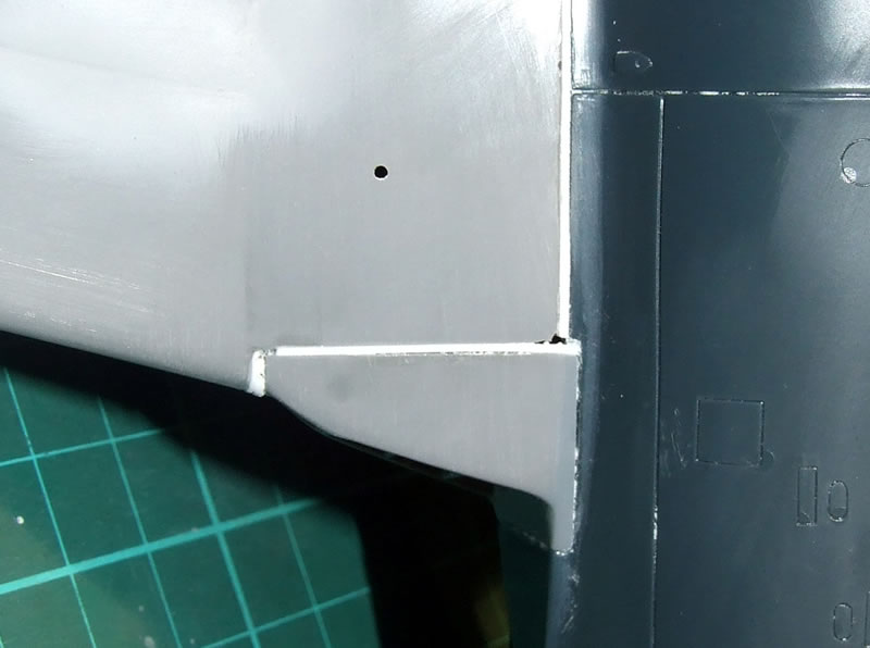

big matt Posted September 27, 2008 Posted September 27, 2008 It looks like you have your hands full with this kit but it is turning out nicely. That shim job is really clean. Did you trim it to fit before or after cementing it??? My attempts to do the same thing usually end up with lots of smeared plastic to repair. Matt

LSP_Kevin Posted September 27, 2008 Author Posted September 27, 2008 It looks like you have your hands full with this kit but it is turning out nicely. That shim job is really clean. Did you trim it to fit before or after cementing it??? My attempts to do the same thing usually end up with lots of smeared plastic to repair. Matt Hi Matt, For joints like that wing root one, I usually try to cut the shim to fit before cementing it. The secret to achieving a nice clean result is in finding a shim that produces a snug fit. I wedge it into place and then run liquid cement (Tamiya Extra Thin) along the join. After a couple of seconds the plastic begins to soften, and I force it down into the join until it's flush. Of course, it's not so simple for joints featuring compound or longitudinal curves, so I'll trim excess bits after the fact in those cases (and end up with lots of smeared plastic to repair!). Kev

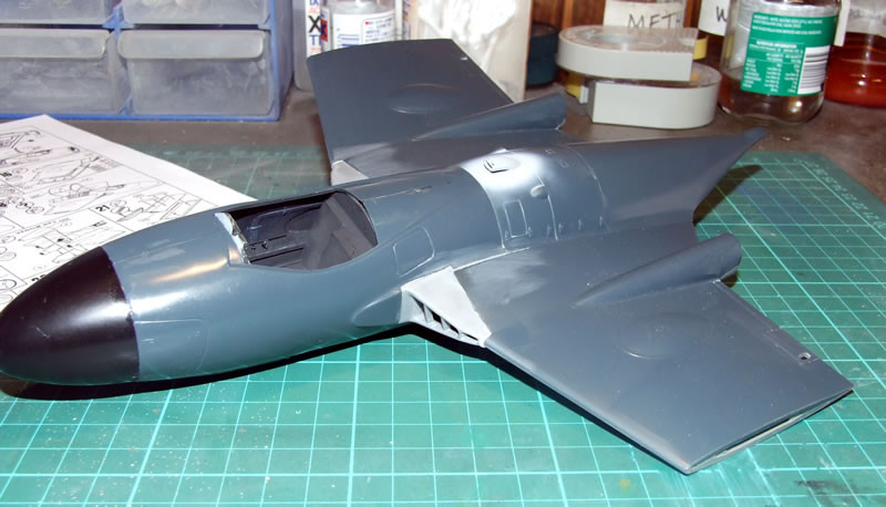

LSP_Kevin Posted September 28, 2008 Author Posted September 28, 2008 OK, time for another update (they're thick and fast at the moment). I've got all the fuselage bits assembled now: Yesterday's dodgy intake has been shimmed after its refit: As you can see, this method doesn't free you of the need to use putty, but its advantages should be obvious. I fashioned an insert for the arrestor hook cover to reduce the gap around the tail pipe and make it look a little more like the real thing: I still need to deal with the gaps where the upper and lower rear fuselage parts meet, which I'll attempt to cover with some sheet styrene. After that all the joints will get a dose of Milliput. I figure it would be easier to deal with that before the tail booms went on, even though they'll need similar treatment. Thanks for looking! Kev tomv87 1

LSP_Kevin Posted September 30, 2008 Author Posted September 30, 2008 Kev, She's looking Venomous! I have on occassion, used liquid glue to "soften" old glue joints; it works well with Tamy extra thin. apply a little, and just a little twist and shout, and ..... That's not a bad idea Mike; I hadn't thought of that one. I used nail polish remover (Cutex) and let it soak in to the joint for 5 or 10 minutes. I was lucky enough to be able to get a knife blade fully between the intake and the fuselage (that's how bad the fit was!) and wriggle it around a bit. I then scored the join to the wing and applied the NPR once again. The thing that really pulled it off, literally as it happens, was using a small pair of rounded pliers to grip the inlet vanes and twist and pull it loose. Gently does it, obviously, and luck appeared to be on my side too. Haven't had any time for modelling the last day or so, but hoping for an update soon. Kev
