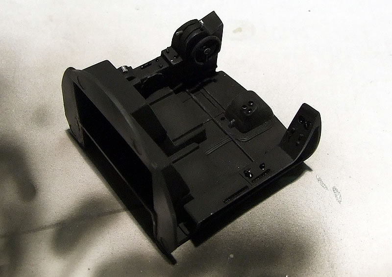

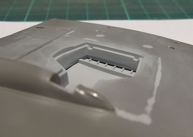

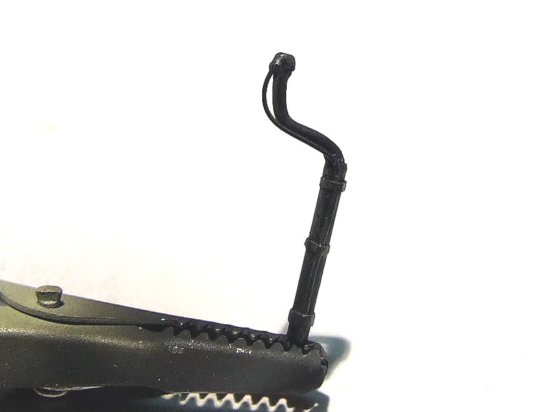

LSP_Kevin Posted September 22, 2008 Author Posted September 22, 2008 OK, last update for a little while (could be a long while if I get stuck into the Zeros). Cockpit painted, detailed with gloss black and silver, washed with straight black oils and dry brushed with white: Man, it's so hard to make an all-black cockpit look interesting! Hard to photograph too. I'm hoping the instrument panel with the MDC decals will lift the whole thing and provide a focal point. Also, I haven't done any work on the seats yet, so once they're detailed, painted and installed, it should improve things a bit. I'm hoping they'll be a drop-in fit once the fuselage is assembled. The control column received much the same treatment: The wheel well side walls were extended with strip styrene, to help fill the yawning gap between them and the upper wing: The wheel wells are provided as insert panels to accommodate the two types (Venom vs Sea Venom), and the fit is only average, leaving typical Matchbox panel line trenches around them. Problem is, there are no panel lines in this area, so plenty of filling and sanding fun there. I inadvertently fill the rear join on one wing, failing to realise at the time that it is the flap hinge line. I hollowed out the air intake, attached it to the engine cover, and faired it in with Mr Surfacer and the no-sand technique: Thanks for looking! Kev tomv87 1

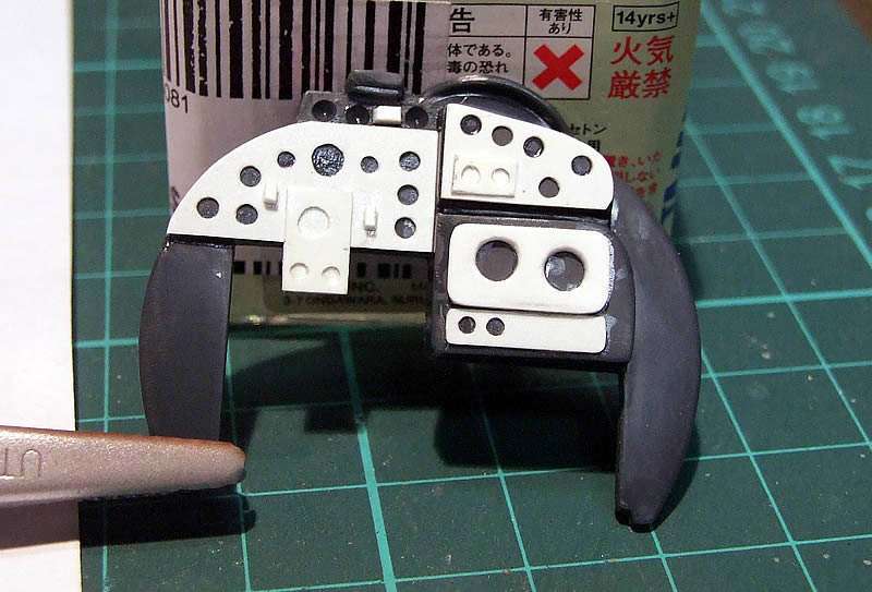

LSP_Kevin Posted September 24, 2008 Author Posted September 24, 2008 A quick update to show where the instrument panel is at. I've finished added all the scratched bits, and it's kinda looking OK. The MDC instrument decals arrived today, so my next job is to paint it all up and get it ready for them. It's not especially accurate, but will hopefully look suitably busy when it's done. More soon! Kev tomv87 1
EPinniger Posted September 24, 2008 Posted September 24, 2008 Great work with the scratchbuilt cockpit detail! I also have this kit (also an ancient Matchbox example, not a Revell reissue) and will keep a note of your build for when I start mine. Man, it's so hard to make an all-black cockpit look interesting! Hard to photograph too. Some light metallic chipping/scuffing would add a lot to the appearance. The black paint on RAF cockpits of this era (particularly on the seats + floor) tended to get worn + battered after a while; most museum examples have very worn cockpit paint, although for an aircraft which has only been in service a few years you'd need to tone down the effect a bit!
LSP_Kevin Posted September 25, 2008 Author Posted September 25, 2008 Thanks for the kind words EP. I'll try to add a bit of subtle chipping to it and see how it goes. In the meantime, I've finished the instrument panel. It probably didn't come out quite as well as I'd hoped, but a lot better than if I'd simply painted up the kit part. It tried the floor polish method with the decals for the first time, but only had mixed success. It looks a little untidy in that extreme close up, but should be adequate once buttoned up in the fuselage and viewed with the naked eye (in the dark, from 40 feet away, by a blind person looking in the other direction...). I think I probably should have made it 'busier' too, as the real thing doesn't have a lot of blank space on it. Apologies once again to purists, rivet counters and Sea Venom fans! Kev tomv87 1

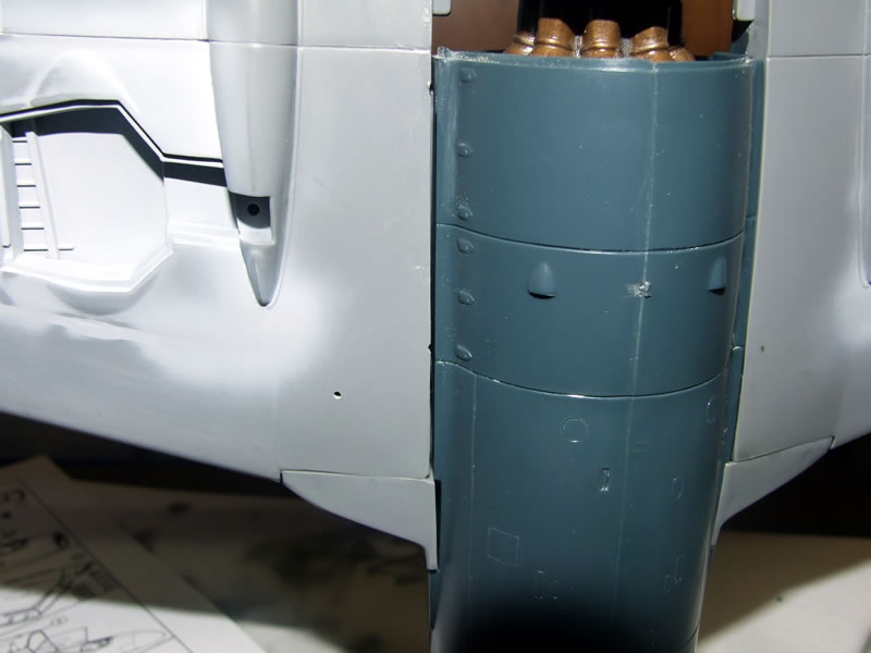

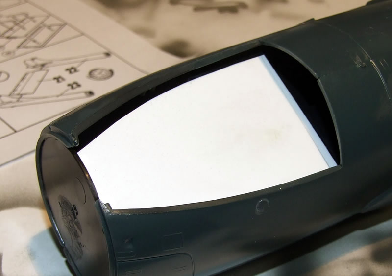

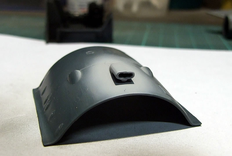

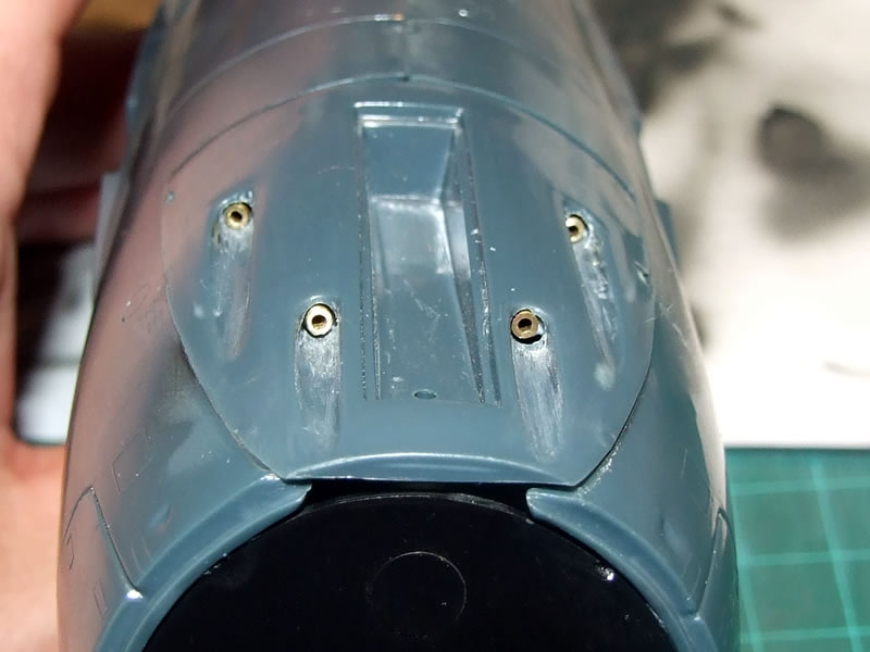

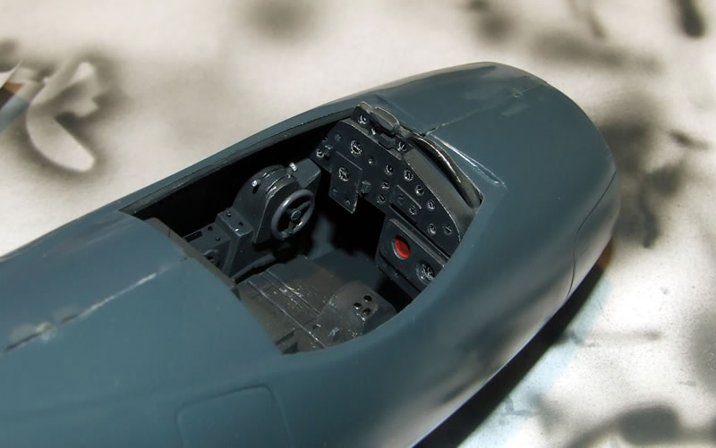

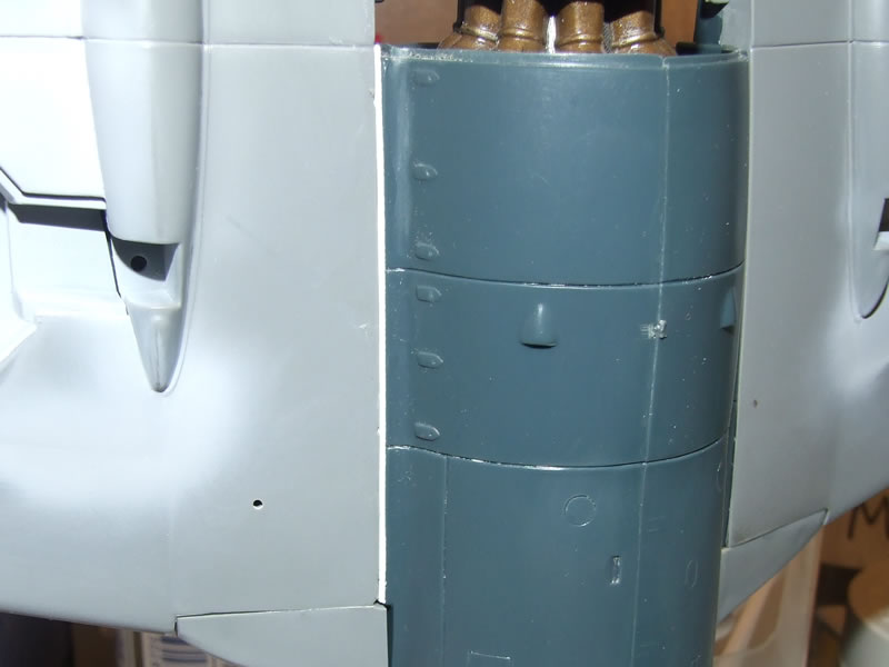

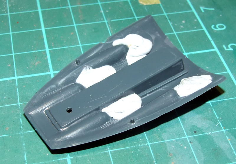

LSP_Kevin Posted September 26, 2008 Author Posted September 26, 2008 Some significant progress in recent days. I've got the fuselage together and the inner wing sections attached. First job though was to extend the cockpit floor to blank off the wide open space forward of the cockpit: I decided next to use a little bit of artistic license and make the gun barrels visible through the gun ports (I don't think they actually were visible on the real aircraft). I cut the barrels from brass tube (finally getting the rolling-under-a-knife-blade technique to work!), and secured them with Blu Tac: Here's what it looks like from the outside: Here's the cockpit in place: I'll leave the control column out until the end, and I have yet to touch the seats. The next task was to attach the wings. One side fit like a glove, the other, well, perhaps a picture will better explain it: The gap at the root doesn't bother me as much as the really poor fit and alignment of the intake part on that side. I'll get a shot of that for the next update, but suffice it to say that it looks appalling, and I'll probably have to snap it out and refit it. I haven't seen anyone complain about this in other builds of this kit, so I'll put it down to my usual fists of ham. Initialise putty sequence and prepare to launch... Kev tomv87 1
LSP_Mike Posted September 26, 2008 Posted September 26, 2008 Kevin wrote: Initialise putty sequence and prepare to launch Kev, My first thought is to use plastic to shim the seam, or try the classic "Glue the upper wing, and then fit the lower wing thing" I see you're using the tulip, for your piccies.
LSP_Kevin Posted September 26, 2008 Author Posted September 26, 2008 Kevin wrote:Kev, My first thought is to use plastic to shim the seam, or try the classic "Glue the upper wing, and then fit the lower wing thing" I see you're using the tulip, for your piccies. Yeah Mike, tulip all the way. My camera actually has a super tulip mode, but it's usually not necessary. I'll definitely be shimming the wing root gap. Unfortunately the previous owner had already glued the wing halves together, so I didn't have any choice there. I may go that route with the outer panels though. Still considering my options for the dodgy intake, but will probably attempt to pry it off. I think I'll have to shim the wing first to maximise the strength of the join, otherwise I risk pulling the whole wing off. Kev

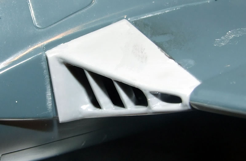

LSP_Kevin Posted September 27, 2008 Author Posted September 27, 2008 Here's a shot of the errant intake I was talking about: I'm currently trying to prise it off, but I don't really like my chances. I've shimmed the wing root gap too: Shimming gaps with styrene is my preferred method of dealing with them, as it makes the join stronger, and fills like with like. You usually still have to smooth things out with a bit of putty (or Mr Surfacer) afterwards, but the photo above should say all that's necessary about how effective this method can be. Kev tomv87 1
LSP_Kevin Posted September 27, 2008 Author Posted September 27, 2008 Sheesh. Methinks I unleashed a monster with the whole 'tulip' thing... You're making really nice progress Mate! You'll sort those ill-fitting bits I'm sure. Thanks Dave. I did manage to get the intake off, and have re-glued it so that it's flush with the fuselage and matches the wing profile. Of course, now I've got huge gaps on the lower wing-to-intake join, but they'll be fine after some shimming. More soon! Kev
