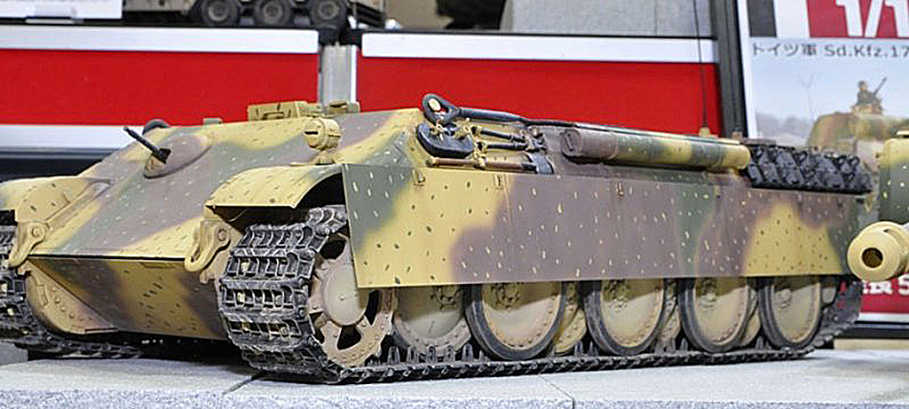

josebagasteiz Posted September 24, 2020 Posted September 24, 2020 Hi Ryan, my name is Jose and as you know I am building the same tank as you but in an early version. About your Panther I like what I'm seeing at the moment, it seems to me a very clean construction. On what Uncarina says about enlarging the axle holes to rotate, I have a question. If the holes are enlarged, will the shafts not rotate upwards due to the weight of the tank and it will be sunk on itself? It should be remembered that the model's torsion bars are made of plastic and when twisting them by turning they do not return to their original position since it is plastic and not steel, which when twisting it tends to return to its original position, which is the twisting of a steel shaft. Don't you think it can be like that? Greetings and encouragement with the montage that I follow with interest. LSP_K2 1
josebagasteiz Posted September 24, 2020 Posted September 24, 2020 (edited) Quiero decir esto: Source Trumpeter Edited September 24, 2020 by josebagasteiz
Ryan Posted September 24, 2020 Author Posted September 24, 2020 (edited) Hello Jose. What a disaster of a build that is, I think the builder has inserted the road wheel arms upside down. Your logic is sound and the suspension will likely sag over time. (but nowhere as much as the lowrider in that pic) I'll probably glue in place after playing with it for a few mins. Thanks you for checking in and I will search out your work. Ryan Edited September 24, 2020 by Ryan
LSP_K2 Posted September 24, 2020 Posted September 24, 2020 1 hour ago, Ryan said: Hello Jose. What a disaster of a build that is, I think the builder has inserted the road wheel arms upside down. Your logic is sound and the suspension will likely sag over time. (but nowhere as much as the lowrider in that pic) I'll probably glue in place after playing with it for a few mins. Thanks you for checking in and I will search out your work. Ryan That's a solid idea. On my Jagdtiger, I foresaw the exact same possibility, so intend to epoxy the torsion arms in place, once I have the 'sit" adjusted to my liking. Ryan 1
