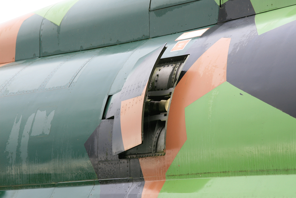

JMcD Posted April 8, 2021 Posted April 8, 2021 (edited) 5 hours ago, red Dog said: This is the only Viggen example I know that has open fuselage speed brakes. I have gone through all my archives to find another one, but none. Neither operational nor display aircraft, not a single one and that goes for all variants. I remember having read somewhere that these were very rarely used and Saab even totally deactivated them on JA37s. Anyone to publish an operational Viggen image with those brakes open is sure to receive a few dozens of likes here Edited April 8, 2021 by JMcD Landrotten Highlander, Derek B, mattcour and 2 others 5

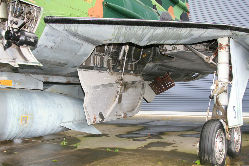

JMcD Posted April 8, 2021 Posted April 8, 2021 6 hours ago, red Dog said: This landing gear well cover, too. Only the display aircraft have them open, no operational aircraft have them open when parked. Again, anyone to povide opposite visual reference will be highly and loudly applauded Violator1991, mattcour and Derek B 3

Rainer Hoffmann Posted April 8, 2021 Posted April 8, 2021 Well, the main landing gear doors could be opened for maintenance, of course, but I've never seen them open on parked operational aircraft (and I've looked at lots and lots of pics when I researched the Viggen for my build ...) One thing with museum Viggens that always baffles me is the fact, that on most of them the arm/disarm lever of the ejection seat is in the "armed" position. When parked, it should of course be in the "disarmed" position. Rainer JMcD and Derek B 2

JMcD Posted April 8, 2021 Posted April 8, 2021 The cad drawings on their website show the brakes openable but looking at the aft fuselage part, Jetmads too seem to have changed their mind. Landrotten Highlander, mattcour, Derek B and 3 others 6

Matti Posted April 8, 2021 Posted April 8, 2021 1 hour ago, JMcD said: The cad drawings on their website show the brakes openable but looking at the aft fuselage part, Jetmads too seem to have changed their mind. We’ll see about that. The red parts are / were still in production phase at the time the picture was released. Derek B 1
JMcD Posted April 8, 2021 Posted April 8, 2021 29 minutes ago, Matti said: We’ll see about that. The red parts are / were still in production phase at the time the picture was released. Yes, I know that. The airbrakes seem closed and integral to the part now, for only the panel line is visible. Othewise there would be a recess with some details if it was designed openable, and with a separate cover of course. Derek B 1
Matti Posted April 8, 2021 Posted April 8, 2021 12 minutes ago, JMcD said: Yes, I know that. The airbrakes seem closed and integral to the part now, for only the panel line is visible. Othewise there would be a recess with some details if it was designed openable, and with a separate cover of course. Yes, airbrakes seem to be in closed positions. I hope it’s not too late to redesign that...
JMcD Posted April 8, 2021 Posted April 8, 2021 14 minutes ago, Matti said: Yes, airbrakes seem to be in closed positions. I hope it’s not too late to redesign that... I like open canopies, dropped flaps etc so open airbrakes would look good however that would not be accurate as all photographic references show them closed. As I mentioned, they were even cancelled on the JA37s, which must be why Jetmads revised their design, if that is the final version of the part. There's nothing wrong with it being closed and in fact it is more accurate this way.
