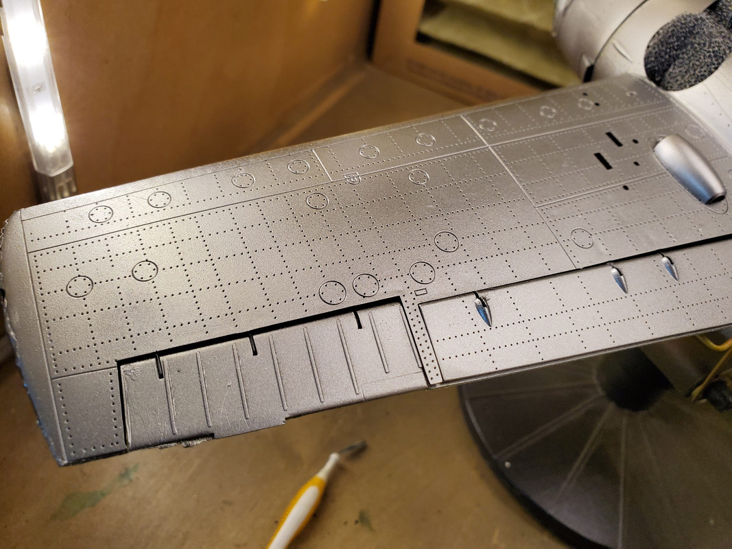

Wings on. As has been mentioned in other builds of this kit, the wing to fuselage installation is suboptimal.  There is a small tab that doesn't really support the wing well or hold the dihedral properly.  It is also not sized exactly right.  After struggling with it for a bit, I decided to cut the tab off and attached the wings with superglue.  This did leave a bit of a gap which came up later...

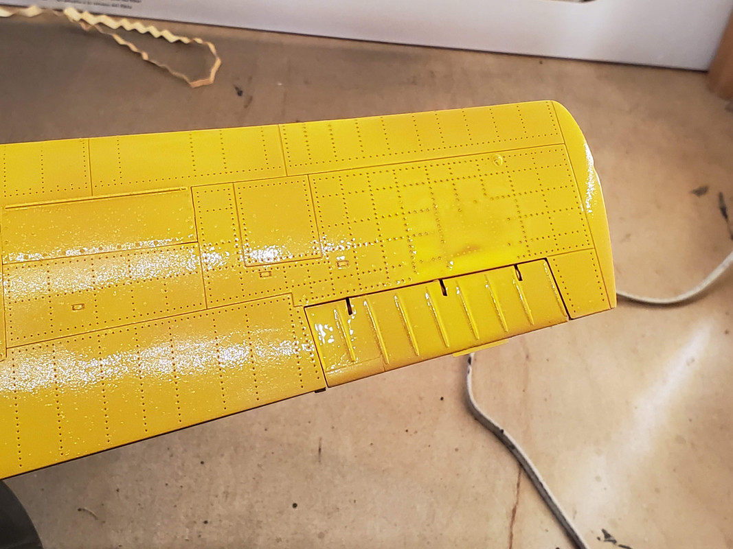

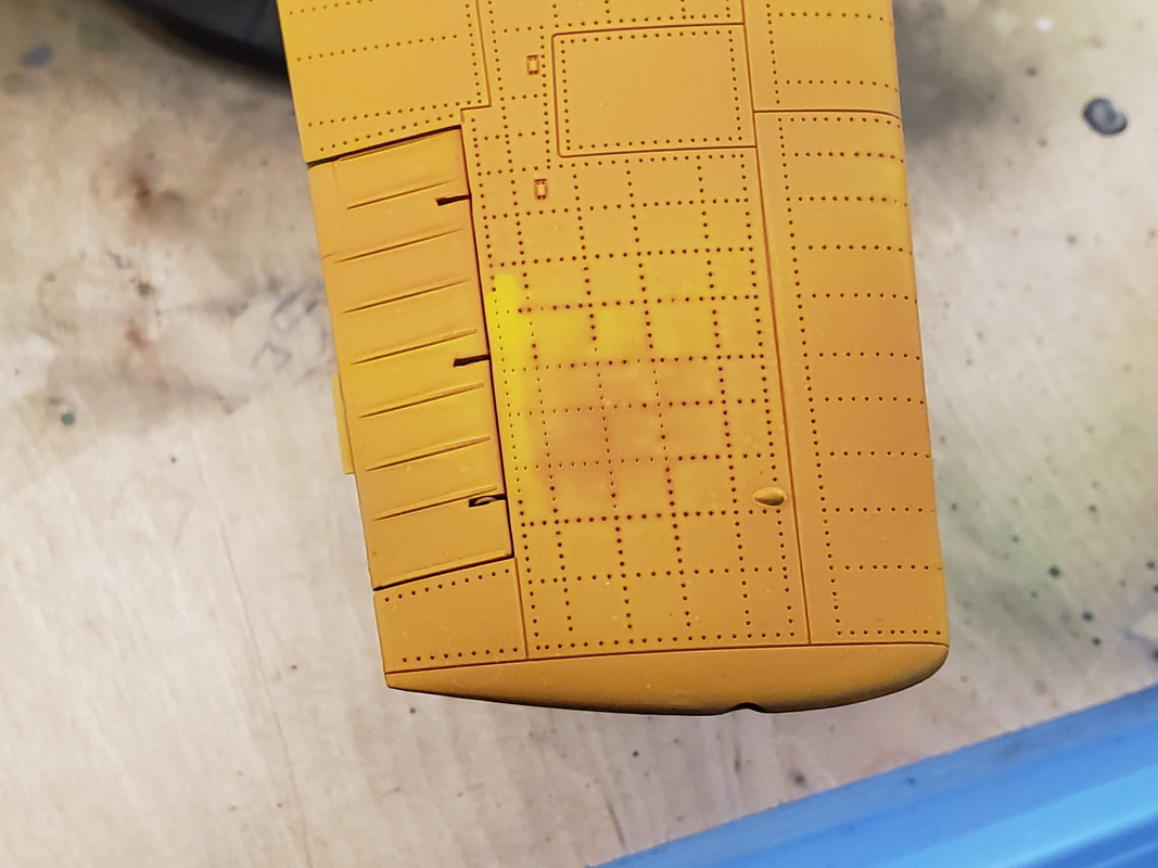

It takes a lot of patience to get yellow built up.  There's a run on the starboard wing where I wasn't quite patient enough.

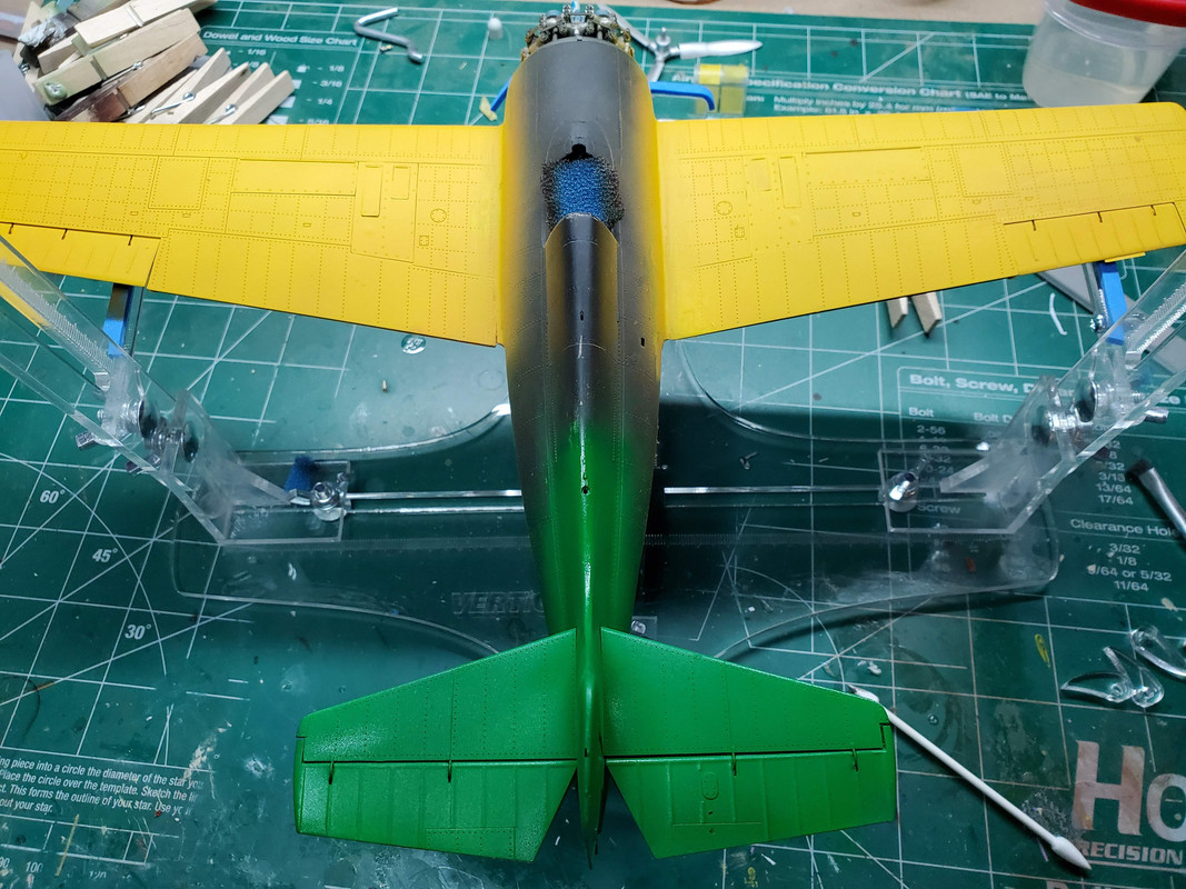

Tail empenage was painted with Testor's square bottle gloss green enamel, which I thought came out well.

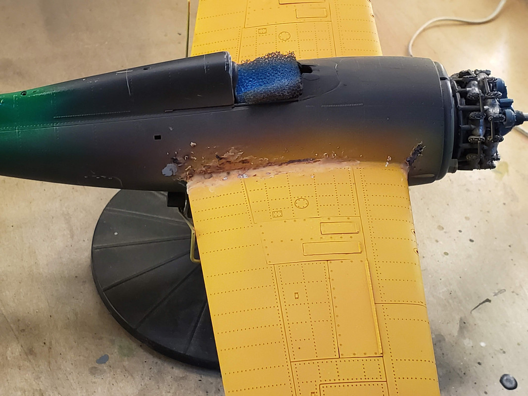

I decided to cover the wing root gap with Squadron white putty, which I'd never used before.  Unfortunately, I thought it was a water soluble putty, so I slopped it on in the hopes of wiping it down with a wet cloth.  Once I smelled it though, I knew that it wasn't, and in fact is really hot.  This made a really sloppy joint that I was never able to clean up to my satisfaction in spite of a lot of time sanding and wiping down with lacquer thinner.
Wet sanded this spot and went back over with yellow

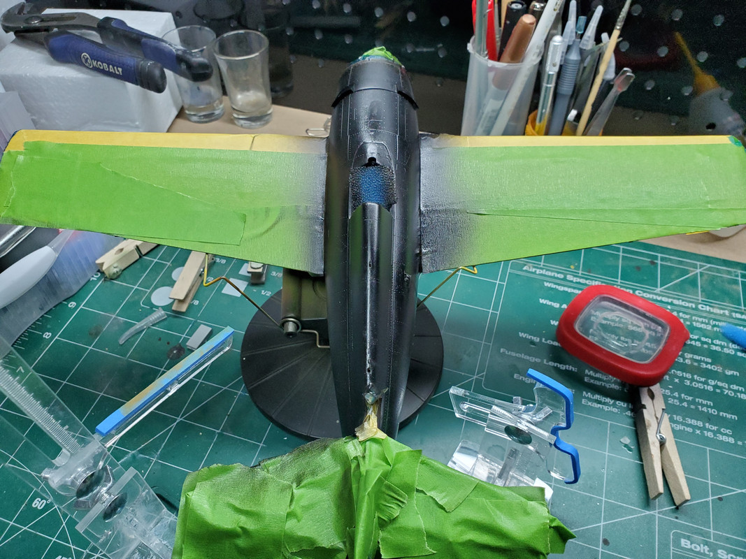

Masking on and Mission Models gloss black applied.  I really liked this as a basecoat for metal.

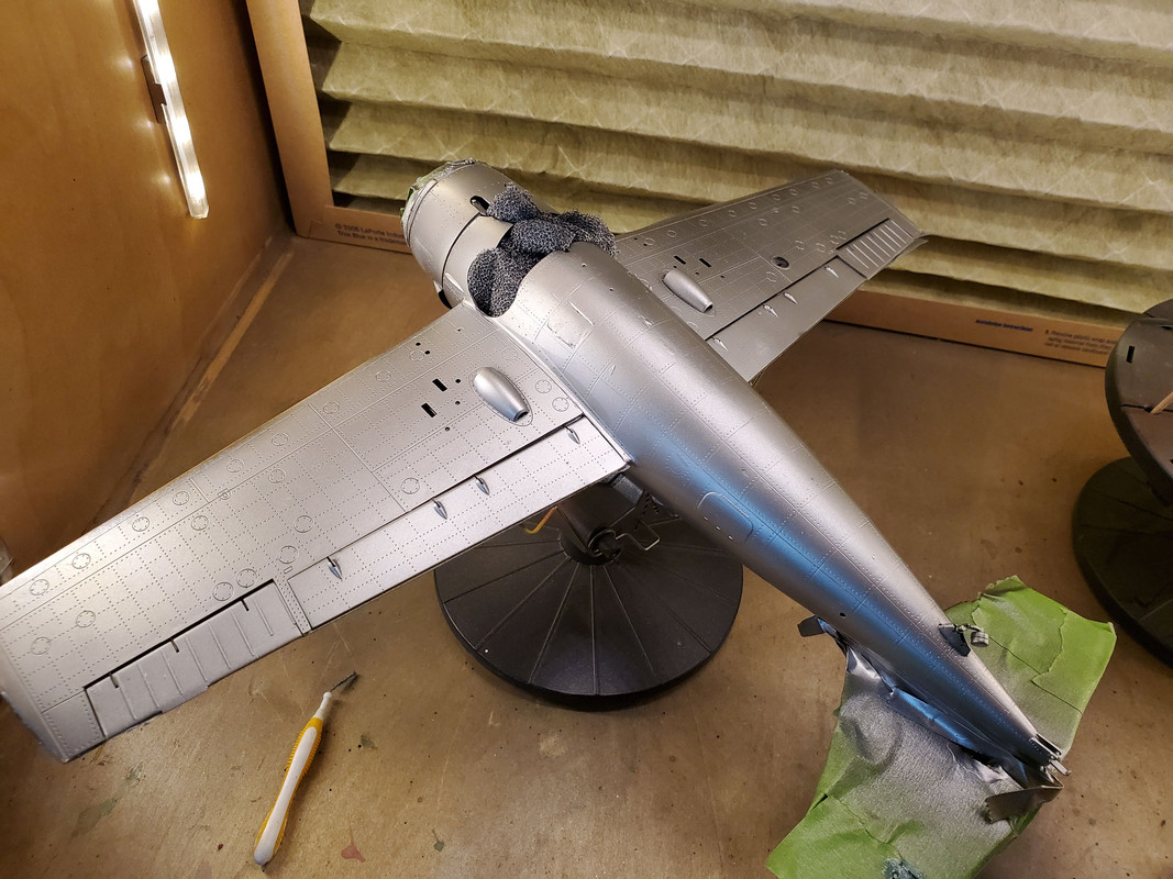

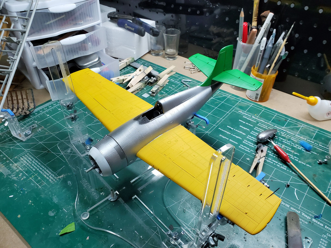

First coat of MRP super silver.  This plane was painted aluminum lacquer, so I'm looking for a painted silver effect more than a NMF, and I think it looks well.

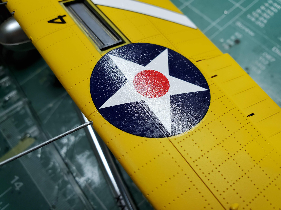

Decals on this kit were really a dream.  Strong enough to futz around with, as was necessary for the stripes, but really melted right into the panel lines and surface details, even without MicroSol, although it was better with an application.
Something really off about the texture of the finish before the decals went on.  It seemed fine to touch and to appearance, but once the decals were on I could see these minor surface imperfections, which really showed up under the decals.  Sadly, as I was trying to put another gloss coat over it this morning to smooth things out, I spilled the bottle of Alclad Aqua Gloss onto the model.  I dabbed off the huge puddles of it and tried to put another smooth coat over.  We'll see how it turns out.  Finished except a little weathering.  There will be very little on this plane.
