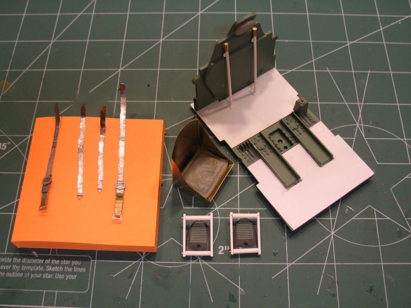

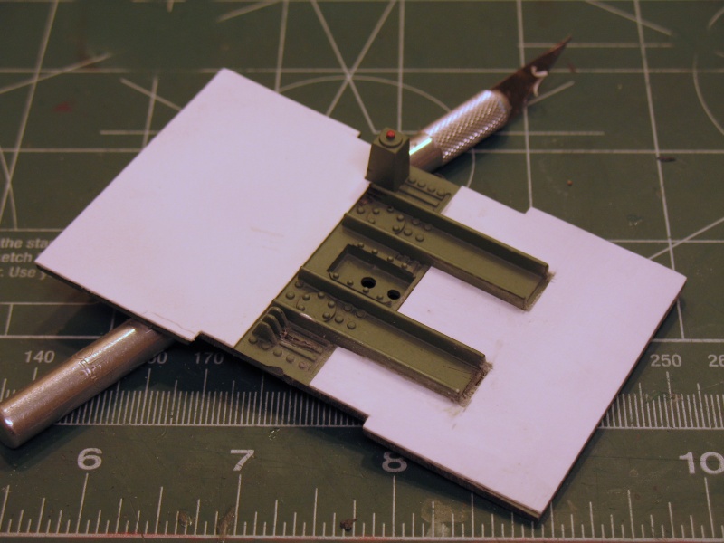

ChrisS Posted January 10, 2011 Author Posted January 10, 2011 Turns out this "F-47N" actually downed a Mustang! I'll post details of that a bit later. Progress on Cockpit. I used the kit's cockpit almost stock. While it's not the greatest cockpit in the world, it does the job. I added solder wiring here and there, and throttle handles. Side walls: Floor, seat and side walls test fitted: Next up is IP and rudder pedals, then the PIT will be done and I can start to tackle the wing modifications. Comments and critiques welcomed! Cheers~ TaffyMan and Girlscanplay2 2
