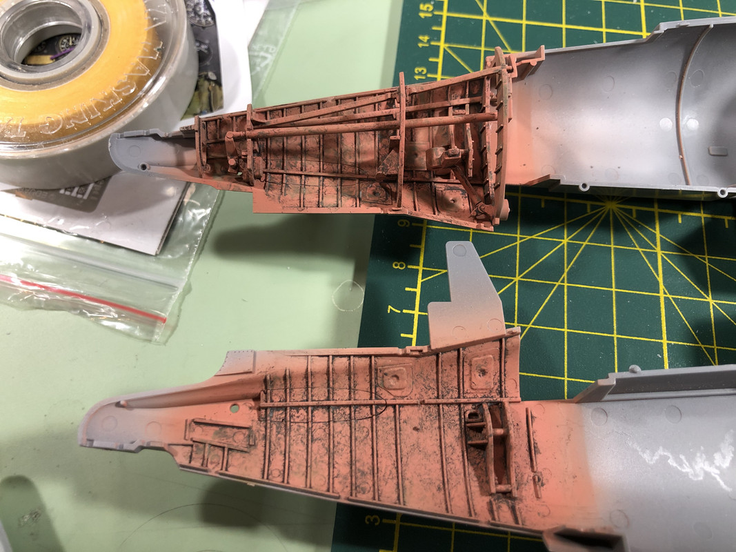

Neo Posted December 16, 2020 Posted December 16, 2020 (edited) Looking good. Weathering looks perfect to me Maybe a touch of that sand you have at the bottom of the pit in the back bottom of the seat Edited December 16, 2020 by Neo AlbertD 1

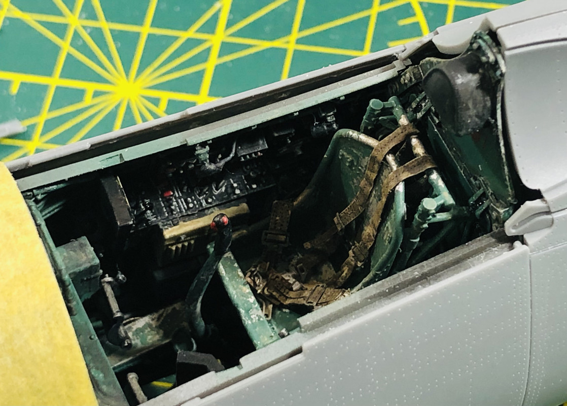

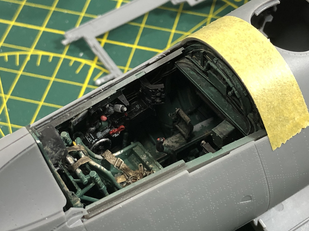

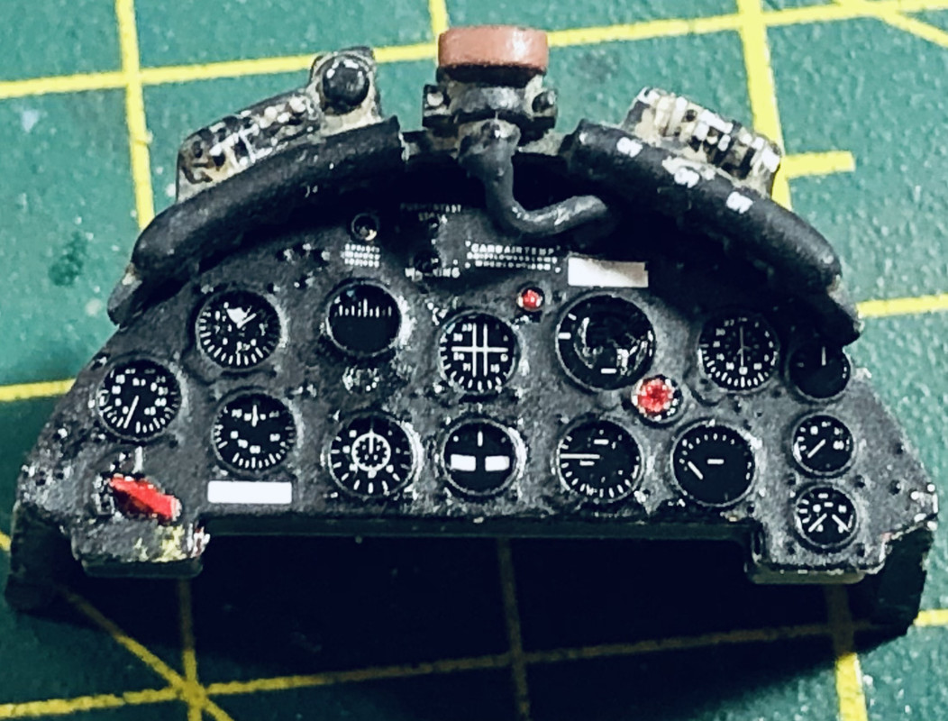

AlbertD Posted December 20, 2020 Author Posted December 20, 2020 The cockpit is finished and fitted. The fitting to the fuselage was very easy. It was just a matter of removing the ribs from the inside of the fuselage sides and it closes right up. When you hear people say that these newer Tamiya kits are the best they have ever build you can believe them. The detail and fit are amazing. Here are the latest pictures. Greg W, LSP_Kevin, Dpgsbody55 and 7 others 10

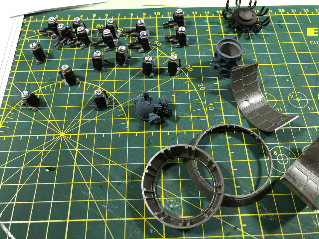

AlbertD Posted December 28, 2020 Author Posted December 28, 2020 A little progress to show. Did I say this is a Fantastic kit? I was afraid to mess up one of these Tamiya kits so they sat in the stash waiting until I had more experience but there was no reason. Not that it's a simple kit, it's not. But as long as you take your time and follow the instructions it goes together with absolutely no trouble. The Eduard cockpit and engine are really nice but I almost wish I didn't bother. The kit parts are just fine and have plenty of detail. All they would need is some wires and little extras to spuce them up a bit. Greg W, LSP_Kevin, Brett M and 6 others 9
AlbertD Posted December 28, 2020 Author Posted December 28, 2020 For anyone who has this kit in their stash or plan to build it in the future don't waste your time and money on the Eduard engine set. It has great detail but really no better than the kit engine. Assembly is also kind of a pain in the rear end. The cylinders need to be lined up absolutely perfectly front and back because there are tiny clips on the cowl parts that need to precisely need to line up with tabs on the cylinders. I couldn't get it done so put it aside to use the kit engine. It's way easier and to me looks just as good. Once it's wired up its gonna look fine. The Eduard cockpit was a different story as far as fit goes. It builds up easy enough and does add more detail. Is it enough to justify it? Probably not. I have the F4U-1A in the stash and it will be OOB except for decals, wheels and little add on's like wiring. misha71, jeroen_R90S, Alex and 3 others 6
Anthony in NZ Posted December 29, 2020 Posted December 29, 2020 3 hours ago, AlbertD said: For anyone who has this kit in their stash or plan to build it in the future don't waste your time and money on the Eduard engine set. It has great detail but really no better than the kit engine. Assembly is also kind of a pain in the rear end. The cylinders need to be lined up absolutely perfectly front and back because there are tiny clips on the cowl parts that need to precisely need to line up with tabs on the cylinders. I couldn't get it done so put it aside to use the kit engine. It's way easier and to me looks just as good. Once it's wired up its gonna look fine. The Eduard cockpit was a different story as far as fit goes. It builds up easy enough and does add more detail. Is it enough to justify it? Probably not. I have the F4U-1A in the stash and it will be OOB except for decals, wheels and little add on's like wiring. Good to know Al...thanks for the tip! AlbertD 1

Dadeo911 Posted January 12, 2021 Posted January 12, 2021 That cockpit looks amazing. Sorry to hear the Eduard Engine is not worth it, the pictures make it look pretty good. Happy modeling, Chris
Alex Posted January 12, 2021 Posted January 12, 2021 On 12/28/2020 at 6:47 PM, AlbertD said: For anyone who has this kit in their stash or plan to build it in the future don't waste your time and money on the Eduard engine set. It has great detail but really no better than the kit engine. Assembly is also kind of a pain in the rear end. The cylinders need to be lined up absolutely perfectly front and back because there are tiny clips on the cowl parts that need to precisely need to line up with tabs on the cylinders. I couldn't get it done so put it aside to use the kit engine. It's way easier and to me looks just as good. Once it's wired up its gonna look fine. The Eduard cockpit was a different story as far as fit goes. It builds up easy enough and does add more detail. Is it enough to justify it? Probably not. I have the F4U-1A in the stash and it will be OOB except for decals, wheels and little add on's like wiring. Yeah, it's hard to see what you would really replace with AM on one of these high-end Tamiya kits. I'm adding scratchbuilt stuff to my Mustang, but things you can't buy AM anyway. The only direct replacement I'm going to use is resin wheels/tires. The cockpit weathering looks good BTW. I especially like the appearance of the worn paint on the sidewalls - really looks like it's been abraded down to translucence, showing a primer coat underneath. It's a nice effect. AlbertD and Anthony in NZ 2
AlbertD Posted January 13, 2021 Author Posted January 13, 2021 9 hours ago, Alex said: Yeah, it's hard to see what you would really replace with AM on one of these high-end Tamiya kits. I'm adding scratchbuilt stuff to my Mustang, but things you can't buy AM anyway. The only direct replacement I'm going to use is resin wheels/tires. The cockpit weathering looks good BTW. I especially like the appearance of the worn paint on the sidewalls - really looks like it's been abraded down to translucence, showing a primer coat underneath. It's a nice effect. Thanks Alex. The thinning paint effect was what I was after. Looking at pictures of these planes they were pretty beat up operating from islands with the abrasive coral sand. As far as aftermarket I agree that resin wheels are a good thing to change on the Tamiya kits. I'm not a big fan of the kit rubber tires.
