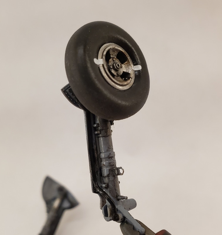

Bstarr3 Posted July 18, 2019 Author Posted July 18, 2019 (edited) A little work on landing gear last night. MRP medium sea grey, Molotov liquid chrome, with a little weathering from brown and black colors, followed by panel line wash. The tires are the kit parts, seam lines scraped and weathering completed with fine sanding stick. I think the tires look quite good, although hard to give a weighted appearance. A final dullcoat was given after these pictures were taken. Edited July 18, 2019 by Bstarr3 TAG, LSP_Kevin, Biggles87 and 3 others 6
Bstarr3 Posted July 19, 2019 Author Posted July 19, 2019 Thanks, Gary! They're going to get some mud, too, before all is said and done
Biggles87 Posted July 19, 2019 Posted July 19, 2019 Very convincing undercarriage legs and wheel. John Bstarr3 1
Bstarr3 Posted July 19, 2019 Author Posted July 19, 2019 1 hour ago, Biggles87 said: Very convincing undercarriage legs and wheel. John Thanks. I was quite happy with how they came out

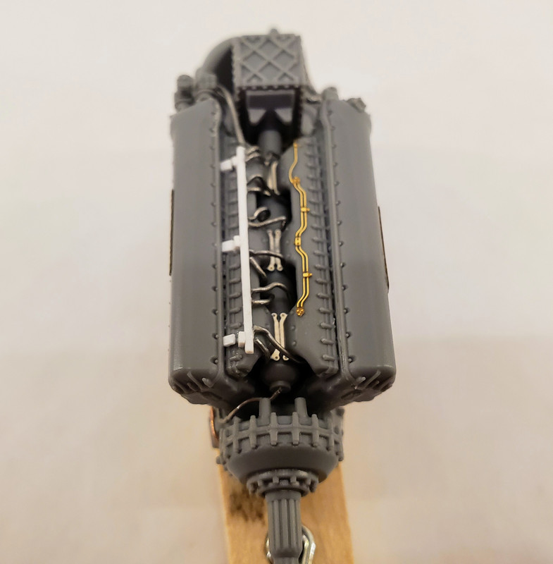

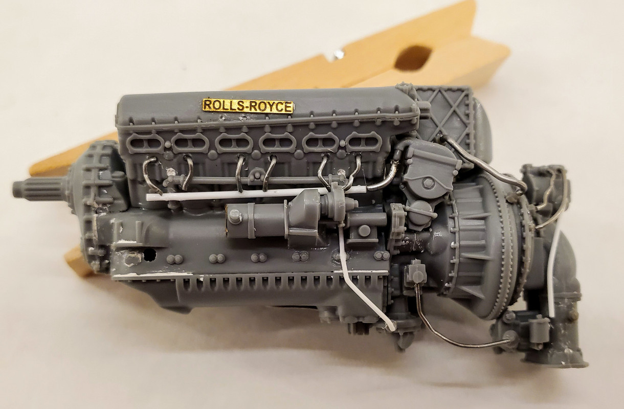

Bstarr3 Posted July 23, 2019 Author Posted July 23, 2019 (edited) As anyone who's built one of Tamiya's big Spitfires, Mustangs, or Mosquitoes knows, their Merlin is very impressive right out of the box. It's got a tremendous amount of detail (fifty parts just for the engine, not including engine bearers, firewall, and additional plumbing) and is very faithfully rendered. I scratched up a little extra detail using various sizes of solder, copper wire, styrene rod, Meng hex bolts, and a couple parts from the Eduard PE set. I only used the Eduard bits for the fuel priming lines (I was really happy to find this in the kit because scratching it was very fiddly and didn't turn out great when I did it on my Mossie) and the RR nameplates. Flat PE ignition wiring just doesn't look right to me if it's bigger than 1/72. I did skip the mechanical linkage on the port side magneto, done beautifully by Wolf on his build. One part I have experimented with but have not yet done to my satisfaction is the return pipes between the coolant tank and the heads, right on the front here. Since I'm going to be displaying with the engine open, I want to have this rather prominent part, but I haven't been able to build anything that looks right to my eye. Suggestions? Edited July 23, 2019 by Bstarr3 Gazzas, Fanes, LSP_Kevin and 2 others 5
Dpgsbody55 Posted July 23, 2019 Posted July 23, 2019 (edited) Nice work so far. I built a pair of such hoses for my MkXVI from either 1.6 or 1.2mm rod (I can't remember which) by heating a section of rod over a candle and bending, then cutting to length. I did this only after fitting the header tank. From all the pictures I've seen, these hoses go between the header tank and each inlet manifold. Here's a picture. You can just make them out, but worth adding, I think. Hope this helps, Michael Edited July 23, 2019 by Dpgsbody55 USMC Herc and MikeC 2
Bstarr3 Posted July 23, 2019 Author Posted July 23, 2019 Thanks, this is just what I was looking for. Do you happen to have a picture of your work from above?
Dpgsbody55 Posted July 23, 2019 Posted July 23, 2019 Sorry, nothing that shows any more than that, I'm afraid. Michael
Bstarr3 Posted July 23, 2019 Author Posted July 23, 2019 3 hours ago, Dpgsbody55 said: Sorry, nothing that shows any more than that, I'm afraid. Michael Thanks anyway. I like your idea of just using 2mm rod. I tried some 2mm copper tube and also tried scavenging some parts from other kits but couldn't find anything that looked or went together right.

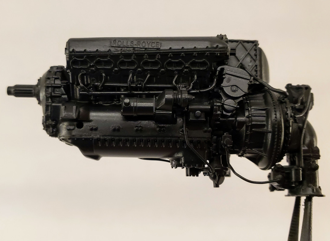

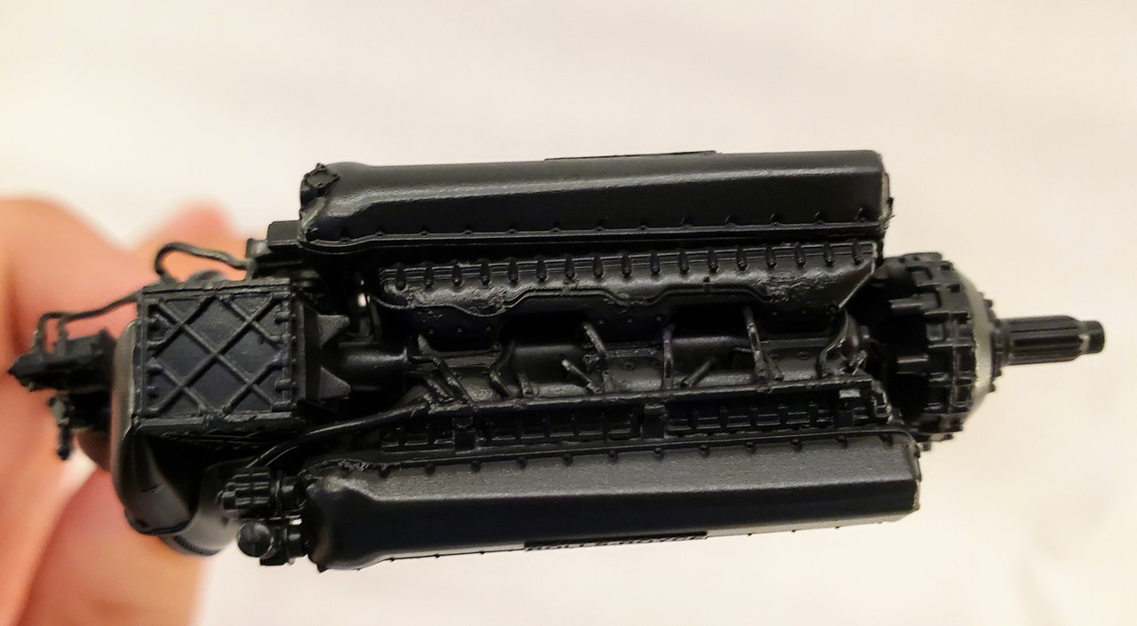

Bstarr3 Posted July 24, 2019 Author Posted July 24, 2019 Small update - first coat of paint on the engine. Light coat of grey stynylrez, followed by two light coats of MRP AMT-6 black. It's a nice "off-black" like NATO black, and like all MRP colors dries to a nice satin finish. Next is getting some color on the firewall and engine bearers, then detail painting. Tamiya has the oil and radiator pipes in interior green, but I'm planning to do them in copper. Theres only so much monochrome one can do before making an aesthetic consideration Gazzas, Out2gtcha, LSP_Kevin and 2 others 5
