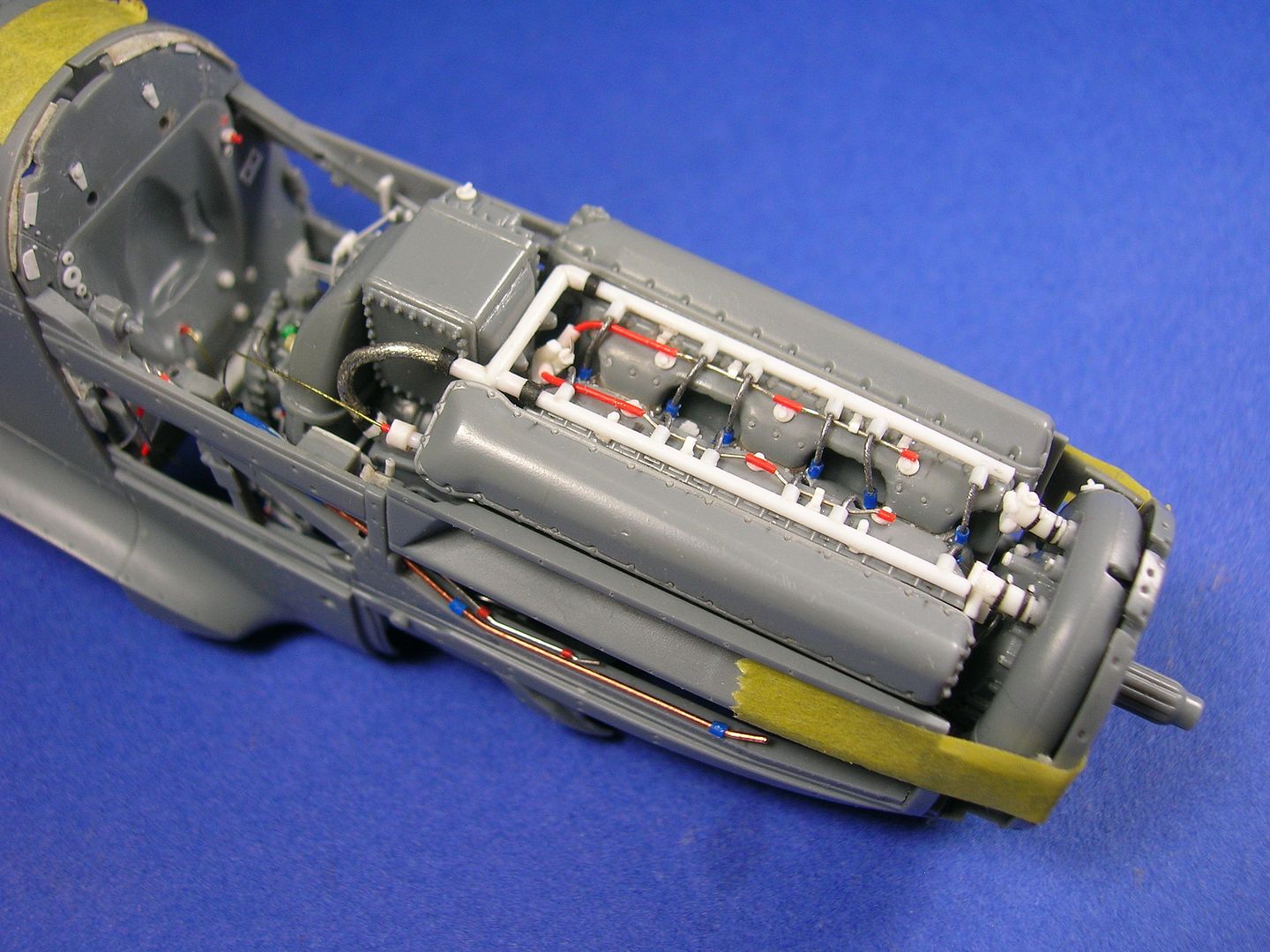

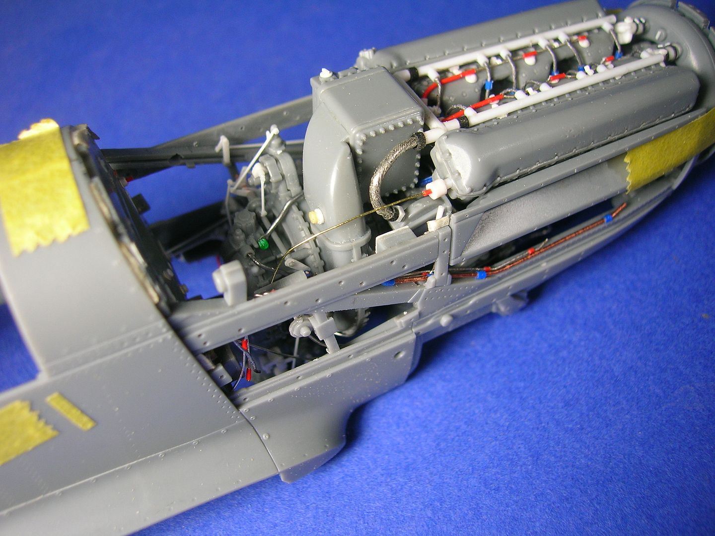

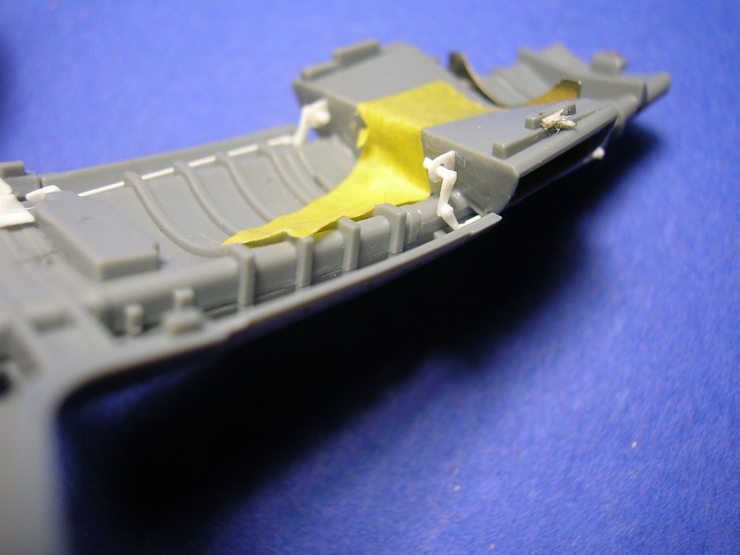

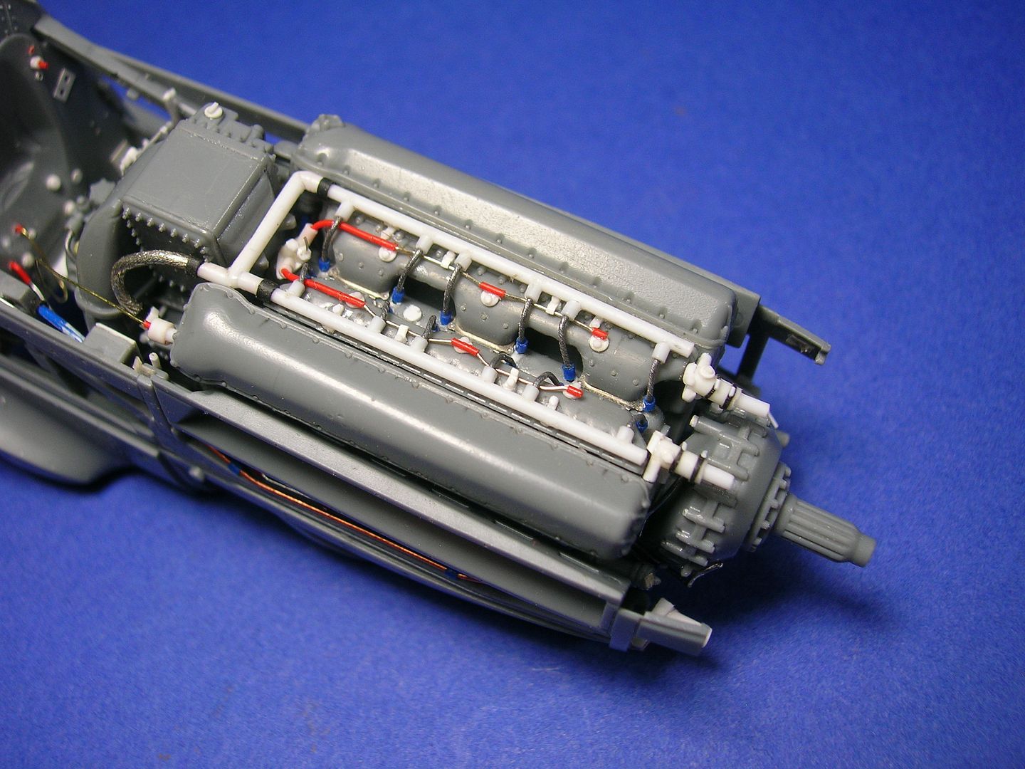

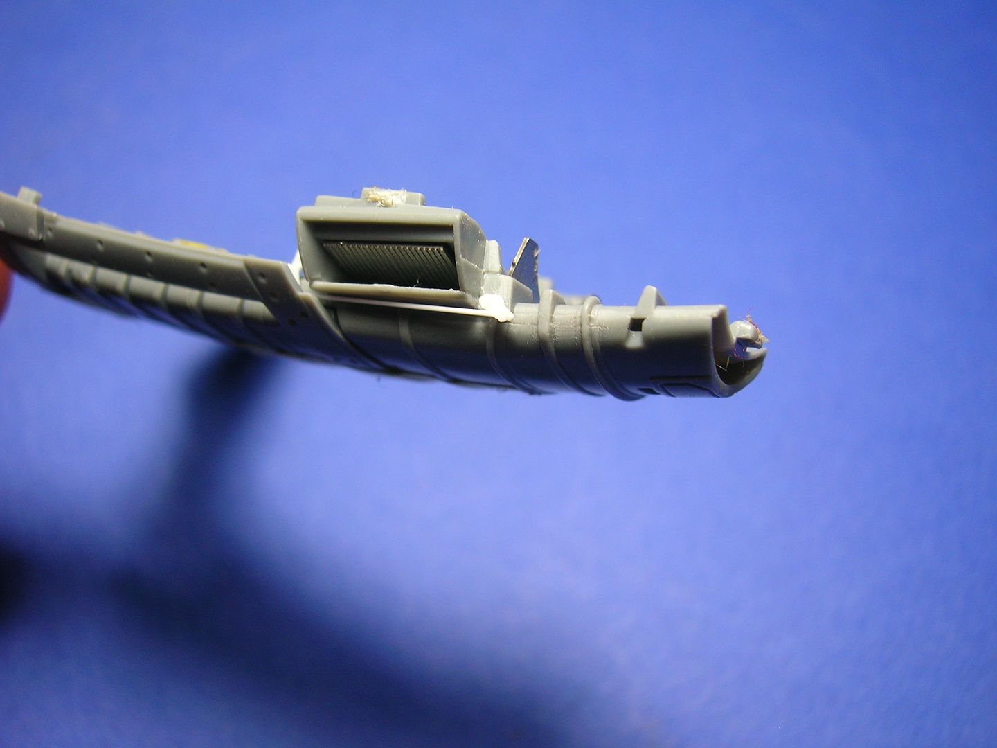

dodgem37 Posted January 27, 2015 Author Posted January 27, 2015 Still working in the engine compartment. Added the right side Filtered Air Door link. The forward engine-bearing structure curves down and touches the top of the duct. This interferes with the ability to bridge this space with rod. Link similar to left side. Same here. The white burned-out blob on the coolant line is the Oil Temperature Bulb (Resistance Type). That's weird, this is a coolant line. I'll double-check, but it is the only line in the neighborhood. Anyway, it is supposed to curve upward, not downward as I have it. I'll just look into this further. The connection into the right rocker head is the Tachometer Generator. Also, I removed the yellow Tamiya tape I had used as connections and cut and spliced heat-shrink tubing and applied it wherever I had the tape. Here it is on the Magneto/Distribution Conduit connections. Just under the Tachometer is a white rod, that is the hex rod to which the Manifold Pressure Line inserts. Eagle eyes will notice I lost a few linkages. Oh well. I worked on all of the previous junk while I was figuring this out. These are the coolant connections for which Wolf provided imagery. Thank you, Brother. The front of the connection has a rod projecting from it. This ties into the holes I drilled into the tank, thus pin-mounting the location for structural support. Went wild and added cut heat-shrink tube with strip band connectors. Those with eagle eyes will notice some white toward the bottom front. The kit pin connection broke off and I had to make a new one. Not a fun chore. Alignment was ridiculously critical. Last but not least, all together now. Thank you one and all. Sincerely, Mark Tomek, KiwiZac, Mal_Belford and 3 others 6
