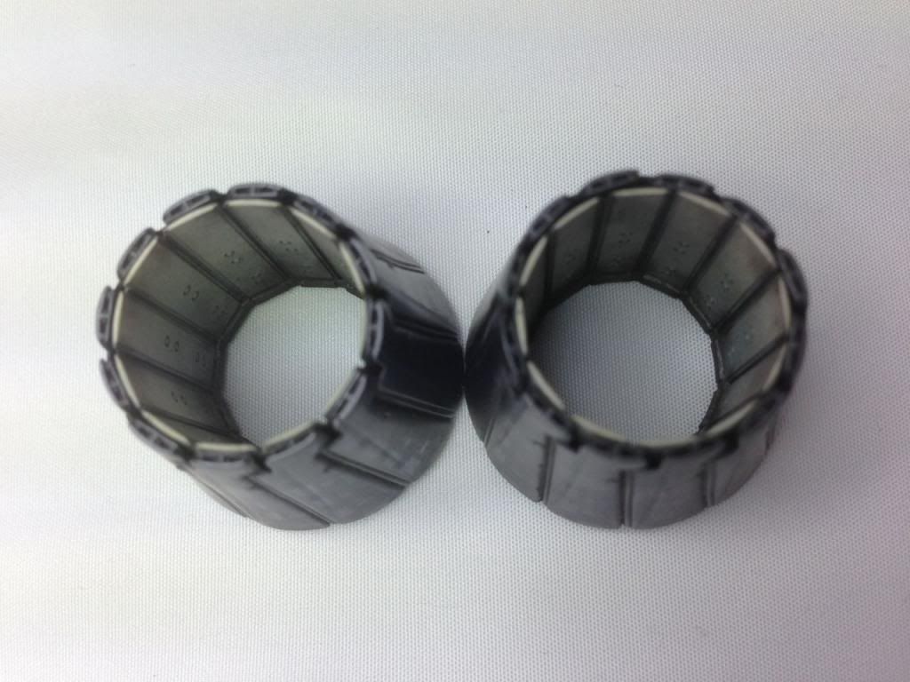

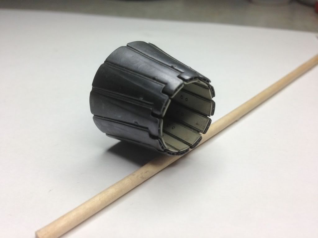

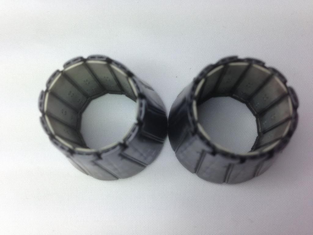

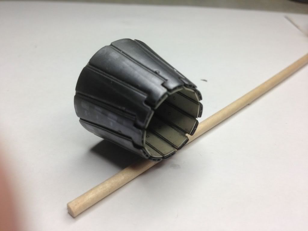

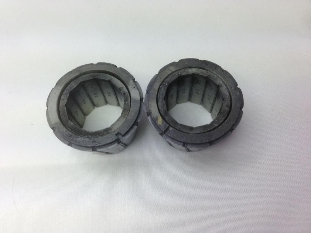

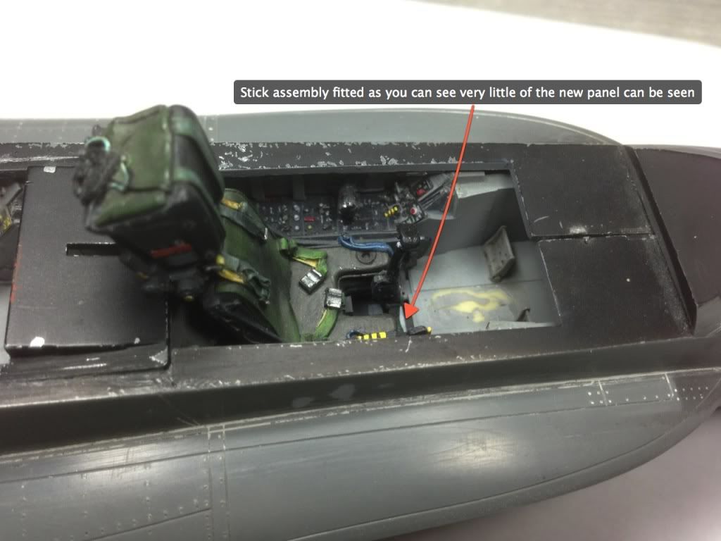

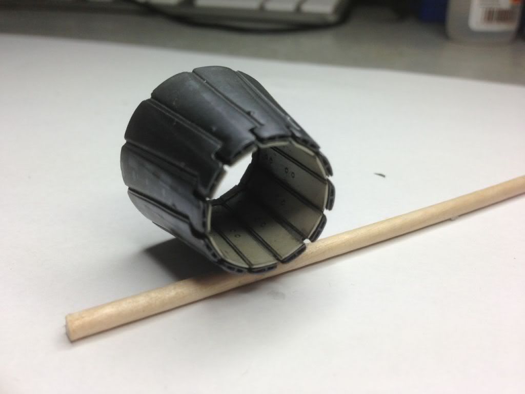

crobinsonh Posted January 21, 2013 Author Posted January 21, 2013 (edited) Thanks for your comments. Jake the seat issue is a real bummer as I made the mistake of "presuming" they where right as they came with the Blackbox cockpit for the F-18D. I have to be honest with the slow rate of my modelling and the fact that these are wrong I moved away from doing a super detailed Hornet (save that for the Buccaneers and Lightnings in my stash) and justing doing more of a OOB. I have made some more progress today with jet exhausts which I did my best to copy from the DACO book - in particular page 47 top RH photo. This included the heat stain markings you can see on each of the external petals. They are still not final as they need some oil spot blending on the external petals to provide some additional hues. These where not the easiest of items to photograph (at least now with my limited skill set). This if from the other side! I need to get better shots as I actually do not think these do justice to the exhausts. Next is the U/C and main U/C bay etc. Edited January 21, 2013 by crobinsonh
crobinsonh Posted January 21, 2013 Author Posted January 21, 2013 Ok. Here are a couple of hopefully better shots of the exhausts.

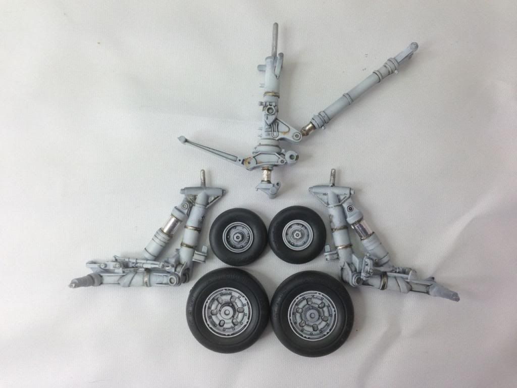

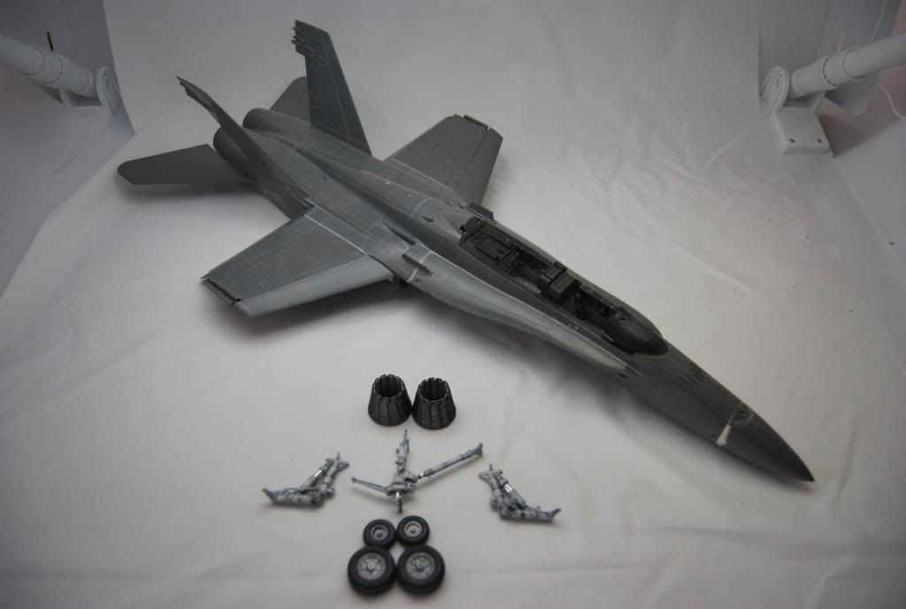

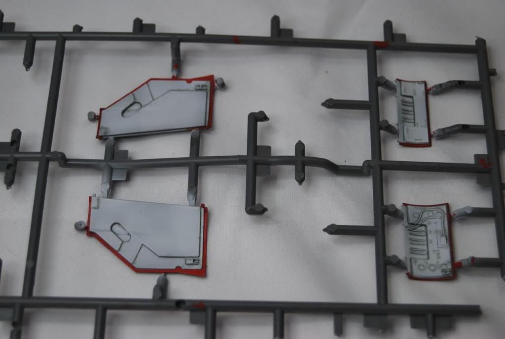

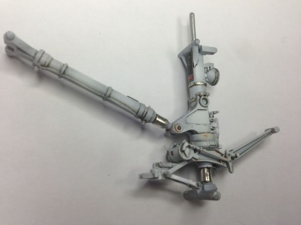

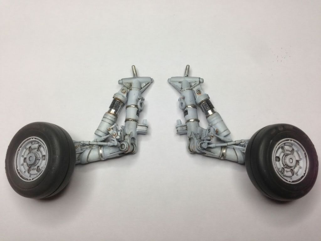

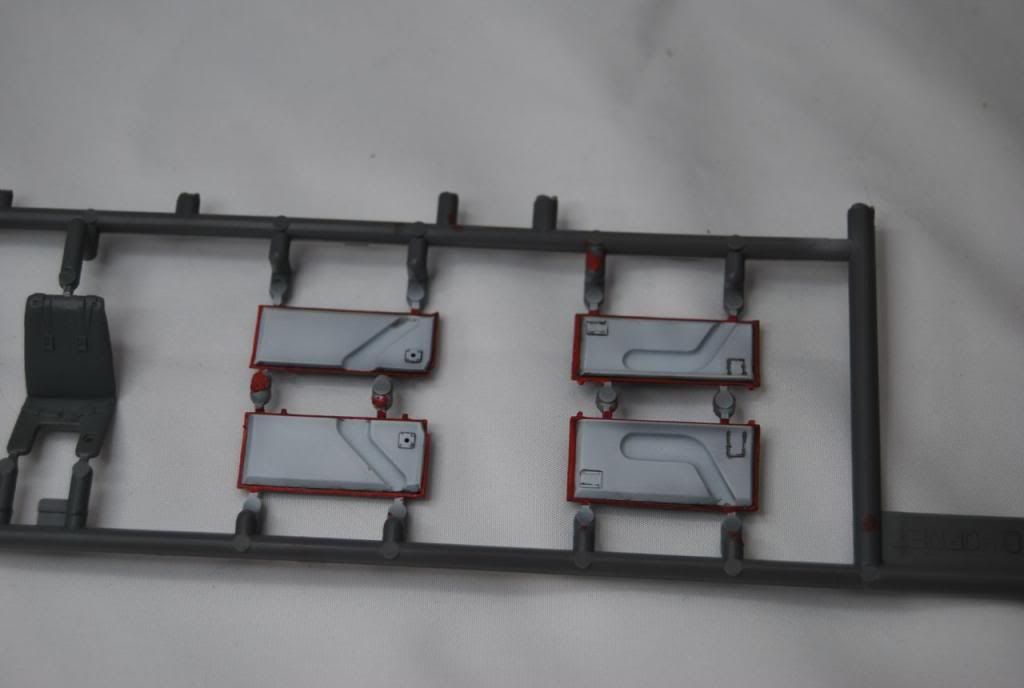

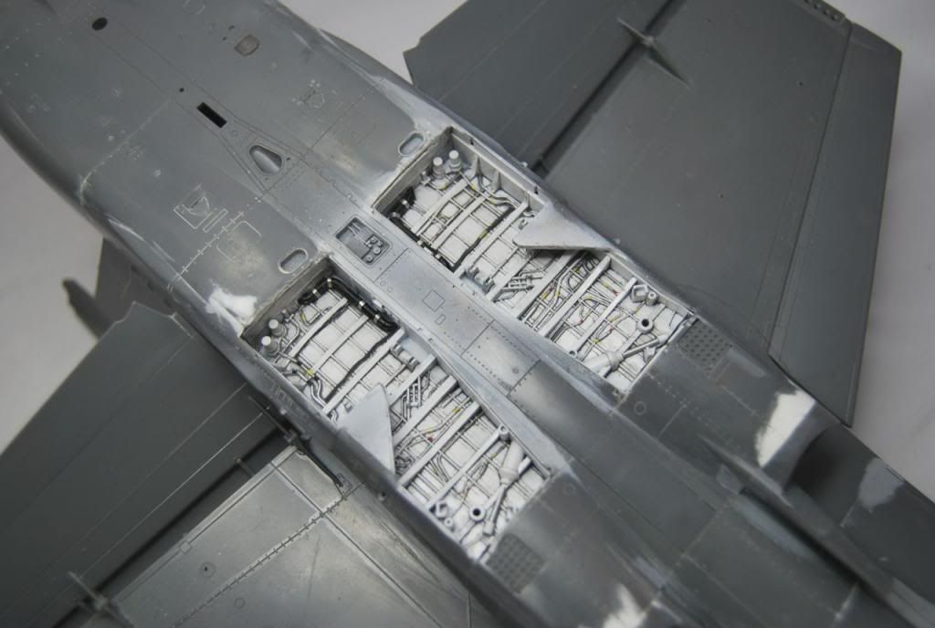

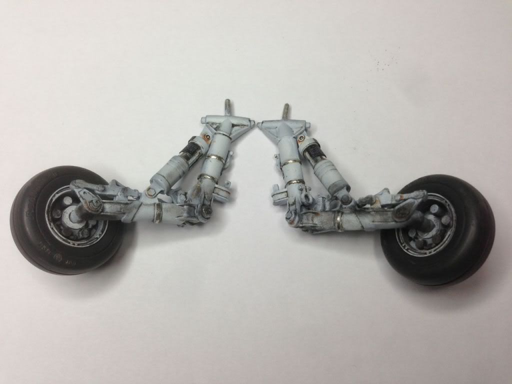

crobinsonh Posted January 22, 2013 Author Posted January 22, 2013 A few more updates for today. As I had decided not to super detail the model after getting the ejection seats wrong I did not go with the Aires resin for the main U/C bays but just used the Eduard set for detailing the kit supplied bays. I decided not to use the resin Contact Resin wheels I bought years ago as they are flattened to a very unrealistic fashion - in fact most of the shots in the DACO book show very little flattening. The tyres are not weathered and there is still a few details to be picked out. I then started the nose and main U/C. Again I did not add any extra detail but just went with the kit supplied parts. There is still assembly still to do and a round of weathering looking again at the DACO book. For the main shocks I used BareMetal foil (my first time ever) and whilst it worked ok I did find the material a bit of a pig to get used to. That said it did get better as I understood more about the properties of the material. Here is everything together And last but not least the U/C doors etc. Spot the mistake - yeah I painted too much red. I realised this when checking the DACO book. Back to the spray booth for some touch ups tomorrow (if it is warm enough to spray) Hopefully more updates tomorrow. Whitey 1

AnthonyWan Posted January 27, 2013 Posted January 27, 2013 That looks excellent! Out of curiosity, what brands/shades of metalizer and other paints did you use on your exhausts? I really like the finish...

crobinsonh Posted January 27, 2013 Author Posted January 27, 2013 Thanks to everyone for your comments and advice. Scotsman thanks for your comments and advice. The gear is the SAC metal gear as I had read on so many build reviews about the relative weakness of the U/C over time. With regard to the intakes I took the hard way whereas I would encourage anyone else to get hold of some seamless intakes for a much easier ride. I have noticed that one of the gear mounts has started to give and crack after one test fitting - certainly a job for 5 minute epoxy. AnthonyWan I used Gunze paints for the exhausts - Dark iron and Iron for the outside and sail colour for the interior. The best paints IMHO. Stocky Pete That would be a huge help. I will PM you.

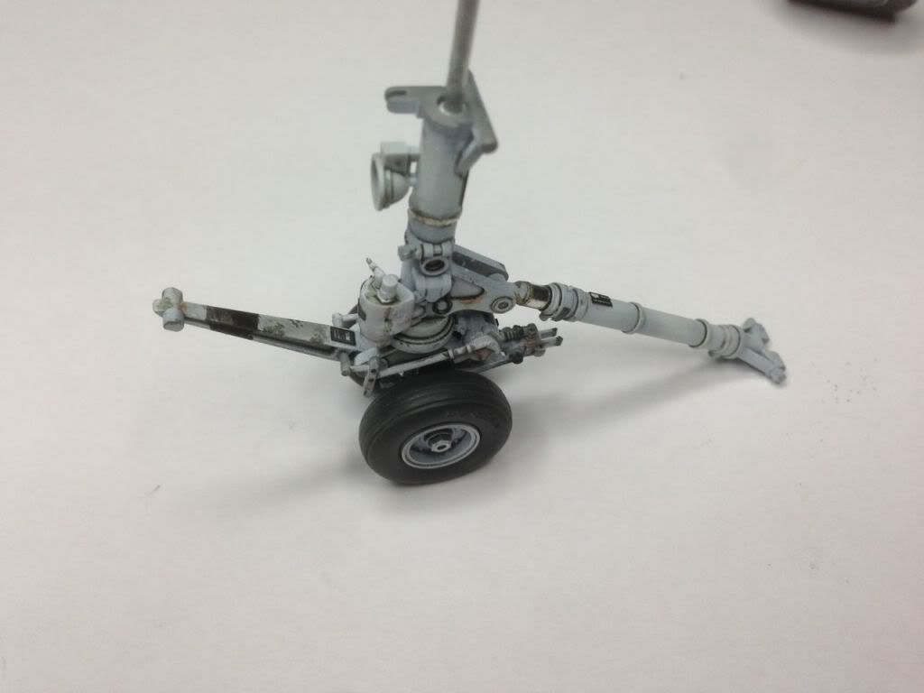

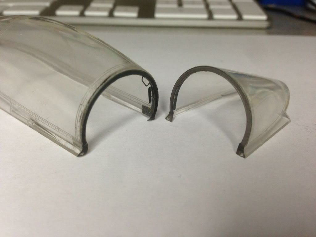

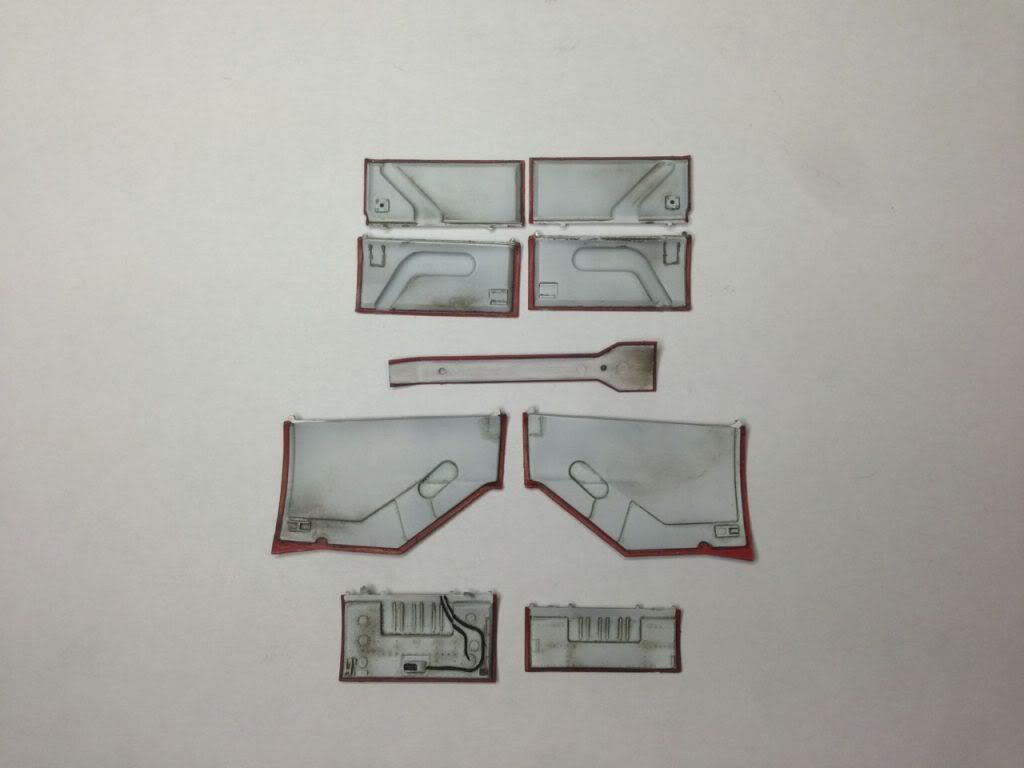

crobinsonh Posted January 27, 2013 Author Posted January 27, 2013 (edited) Updates from the last couple of days. Here is the nose U/C with the eduard F-18 Placards set. A little thick but still nice. I then used MIG pastels - as I said earlier I am a Pastel virgin until this build. I have seen many comments on the use but could never quite work out how to use them. Have now amassed around 20 or so of the MIG pigments and used them on the jet exhausts and U/C I now have a much better understanding of the value in weathering and finishing models. I then moved onto the main U/C and then the gear doors - still some work to tidy up. I then moved onto the windscreen and main canopy - I have to admit I have had a nightmare time with these parts. The Future finish has "waves" (first time this has happened to me) and had to be stripped and then the glueing the etch was an absolute nightmare. I certainly needs 6 pairs of hands! I also have the Eduard external weapons etch which as far as the main pylons goes is pretty much useless as most of the etch does not fit. Edited January 27, 2013 by crobinsonh
LSP_Kevin Posted January 27, 2013 Posted January 27, 2013 Wow, that undercarriage looks amazing! So lifelike. A shame about your canopy issues, but I'm sure you'll triumph in the end. Kev
AnthonyWan Posted January 28, 2013 Posted January 28, 2013 Thanks to everyone for your comments and advice. Scotsman thanks for your comments and advice. The gear is the SAC metal gear as I had read on so many build reviews about the relative weakness of the U/C over time. With regard to the intakes I took the hard way whereas I would encourage anyone else to get hold of some seamless intakes for a much easier ride. I have noticed that one of the gear mounts has started to give and crack after one test fitting - certainly a job for 5 minute epoxy. AnthonyWan I used Gunze paints for the exhausts - Dark iron and Iron for the outside and sail colour for the interior. The best paints IMHO. Stocky Pete That would be a huge help. I will PM you. You have the paint #'s for those? I can't seem to locate a "dark" iron, only burnt. Are you using the lacquers or acrylics? Found sail color though! Thanks
Guest Peterpools Posted January 28, 2013 Posted January 28, 2013 Fantastic work on the gear ... the weathering is spot on and looks terrific. Keep 'em coming
crobinsonh Posted February 17, 2013 Author Posted February 17, 2013 AnthonyWan - Apologies for the delay it is Mr Color 214 (lacquer) Dark Iron and Mr Color 212 (lacquer) I have a some update on work from the last 2 weeks.
