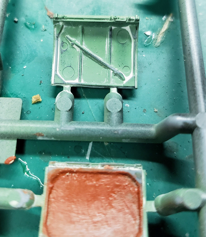

For some unknown reason, Tamiya have chosen to leave very prominent defects in this door.  After trying unsucessfully to fill and sand them, I scraped away the detail, smoothed it over with some Bondo, and re-added the detail by scratch.  The open door below shows that in progress.

Here's my door.  Need to clean it up a little still.  Waiting on a new bottle of MRP RAF interior green.  The crowbar has yet to be built, but I am thinking that I'll whittle it out of styrene strip.
