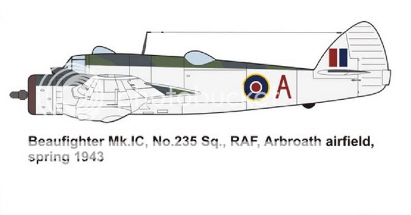

So I decided without hesitation to surf through the www and I really found a nice colour scheme reducing the giant size of the kit a bit I hope:
MKM14435%20Beaufighter%20Mk.IC_camoBIG_z
its copied from the backsite of a 1/144 kit:
MKM14435%20Beaufighter%20Mk.IC_camo_zpsm
What are your tips, hints and tricks for her?
I've never dealt with the "doubleB" :wicked:
I played a bit with MSpaint - so it possible to do something like this to the kit?

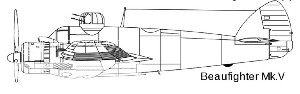

Updating to Mk V with a quadrogun turret - but keeping the engines rotray? - they look so nice :whistle:
Bristol_BeaufighterTF%20Mk_V_zpsejbbgpal

To the camouflage scheme:
I found this Picture of a Czech Lib  LV343 at Beaulieu in July-43 with this nice "waves" between grey/green and white
- is this allowed to add to a B²?
 Czech%20Lib%20%20LV343%20at%20Beaulieu%2
I saw a  Wellington Mk.VIII in later Coastal Command colours, showing the ASV Mk.II radar antennas on the side and top of the rear fuselage. And I like this - but have there been some addid into a B² ?? This because I am not shure if I want to built a "Torpedo Attacker" or some "Electronic Warefare" - both are so intresting - the colouring of the tin-fish on the one hand and the intesting look of the antannas.

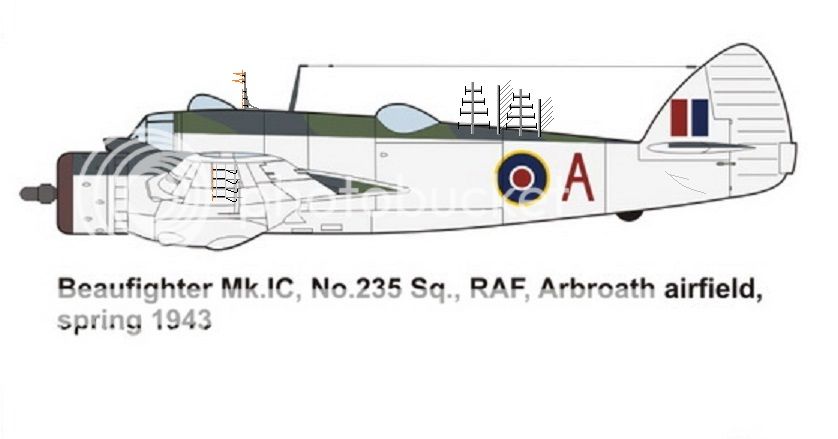

Here my first doodling scetch of antannas with bare copper surfaces:
Antenna types :
Barreal Abor
Feather
Fir Tree

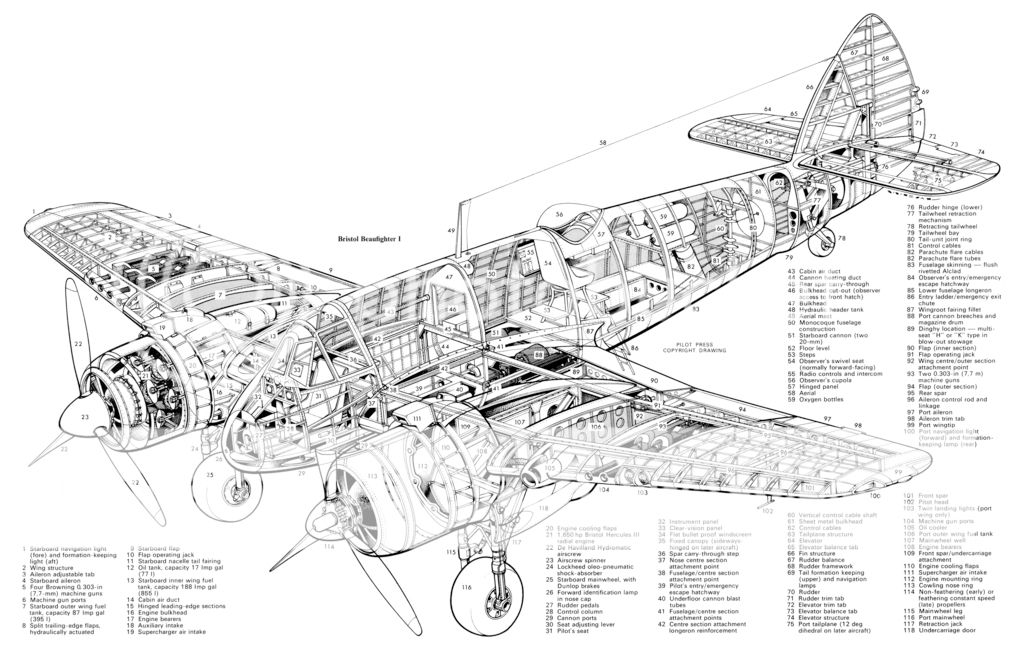

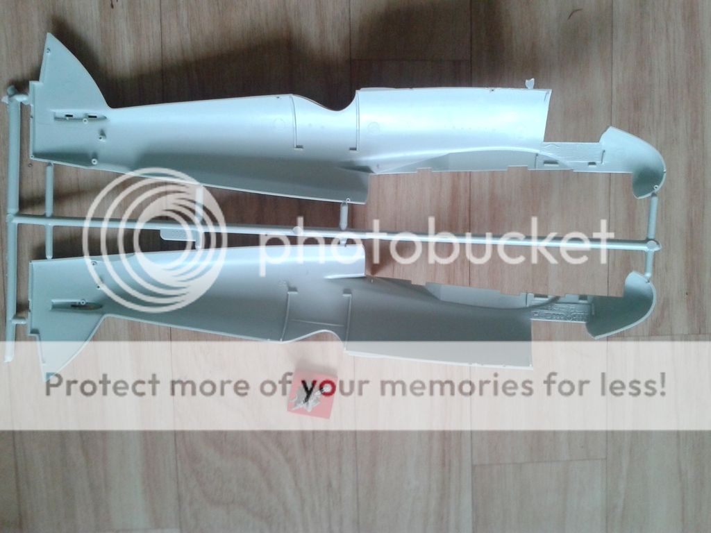

Now the question - what to do with the inner side of the kit:
Compaded to the cutthrough:

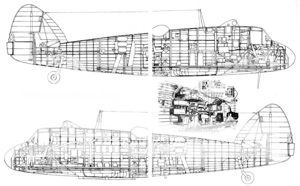

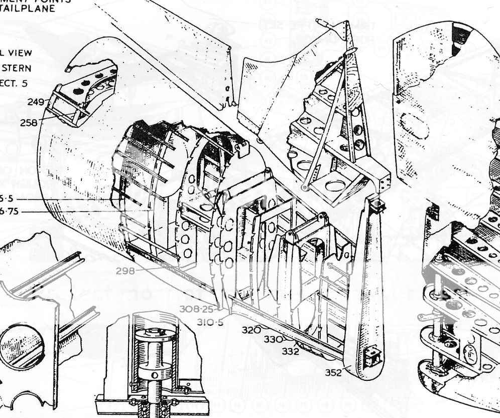

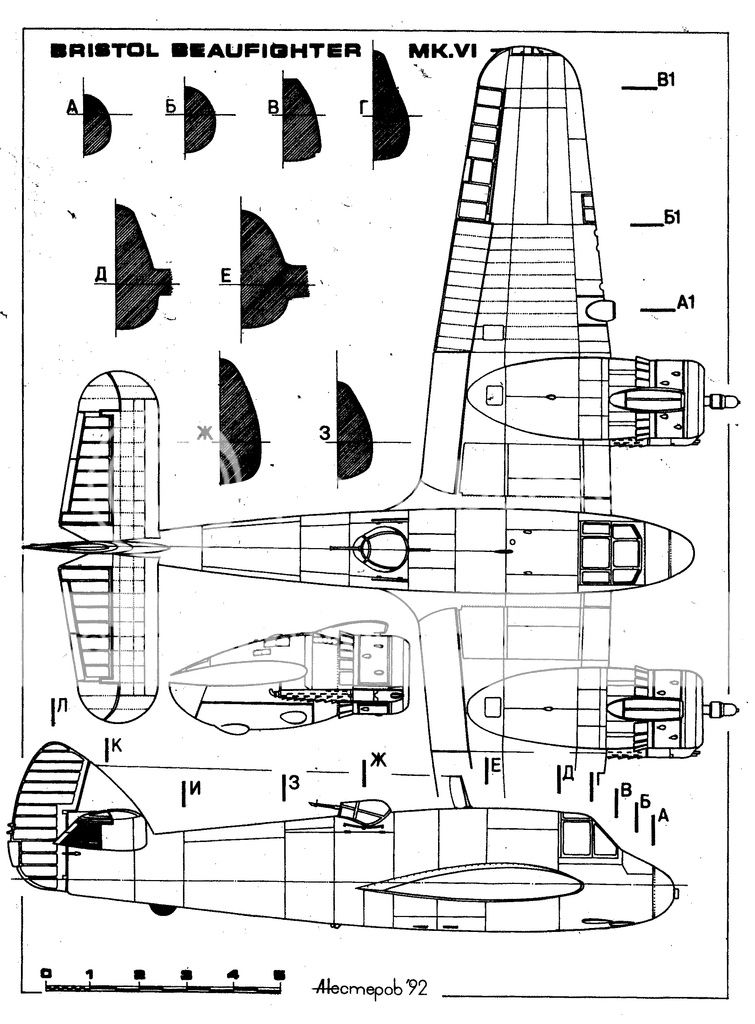

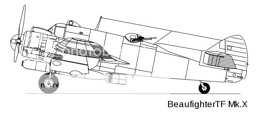

Here some technical drawings I figured out to get some idea of the inner structure of the  fuselage.:
Bristol-Beaufighter-Cutaway-Drawing_zpsb
A good overview so we can say the No.47 "Bulkhead" is right in the Revell kit... but with this everything ends...

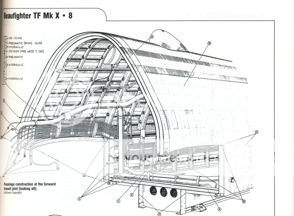

Something about the hydraulic, pneumatic and electip piping and wireing.
Interesting: Detailling of the tail

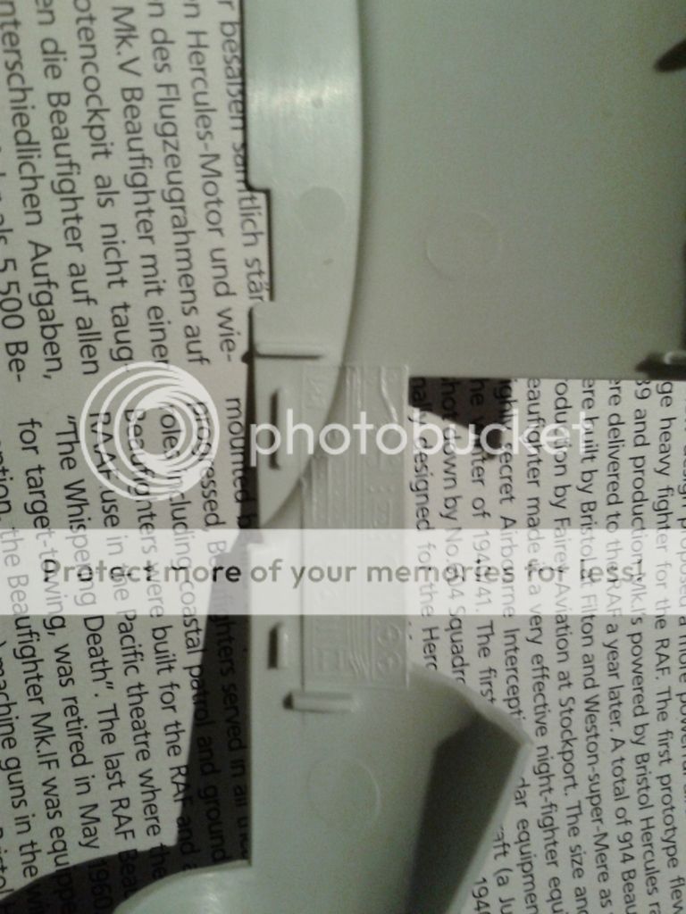

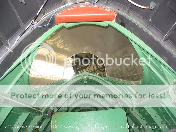

Very important for me is the L-form of the  longitudenal straces:
Can this hacht stayed opel for the installation of the new(ish) equipment under the copula?
Looks like it is opened tothe right side.

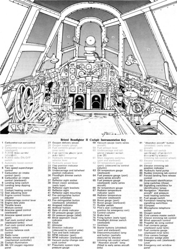

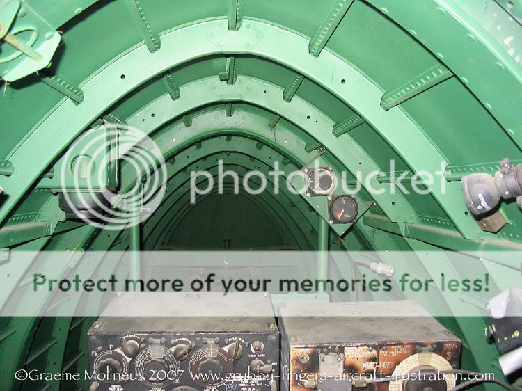

Also I found this walk around - and NOW I'm completly confused what is the right shade of green for the cockpit inner colour: Revell says "C" what meens mixing 33%  Yellow matt No. 15 + 33% sea green 48 + 34% stone grey matt75"
So what green is right the ugly bright A or the greener B? Or shall I believe in Revell?
But the walkarround shows several shades of green! Look: http://www.grubby-fingers-aircraft-illustration.com/beaufighter_walkaround.html
Veryimportant are the bulakheads here for the shape of the fuselage.
Here the Cockpit (Australia has an other shape of green???)
look arround!
 Beaufighter_A8-39_13_med_zpsof22ews3.jpg Beaufighter_A8-39_12_med_zpsdvawx8kl.jpg

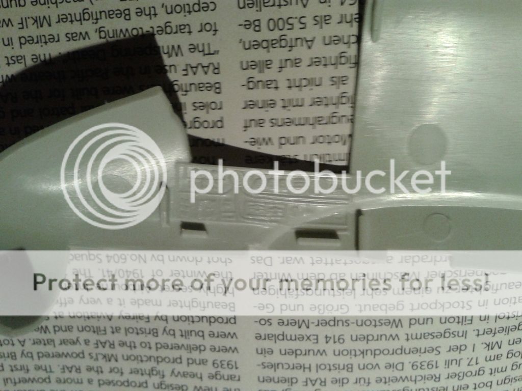

Some bad jokes made by Revell in 1974:
That's a pitty but now I know where the equipment is to be placed. I think about building the single parts individually from wood, odds and ends by visceral. Or are there any measurements. Can I write to the museum in Australia to get some of the measurements or pictures?

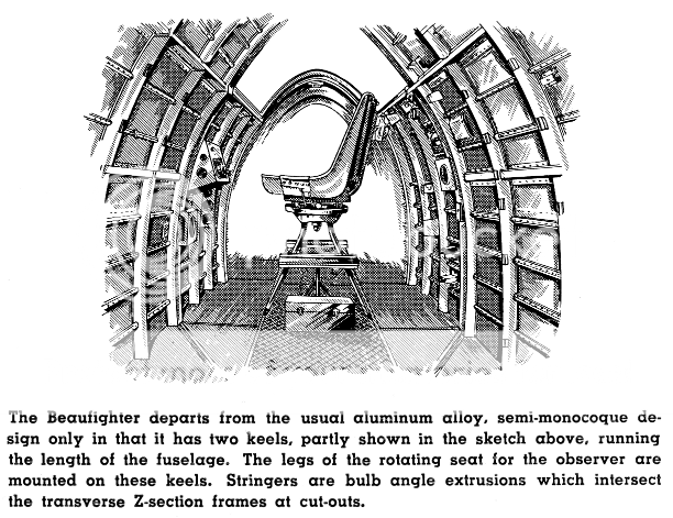

I was able to find some evidence for the opening in the fuselage I wrote about above:
Beaufighter_Av_4112_sk_seat_p121_W_zpsgd
It is obviouse that there is a plenty of room in the fuselage to add my EEEs.
So I'll have to change a lot in the kit because the kit hase not really hat the real fuselage was like.
II.
Starting with the bulkheads I'll try to catch the inner line of the visiable stanchions inside also.
But first I'll have to figure out the bulkhead/frames's lines and the stanchion's openings in the bukheads and frames.
