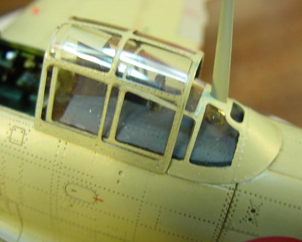

Juggernut Posted September 28, 2009 Posted September 28, 2009 ...but the upshot is, A6M2s were painted in what I think is best described as a "pistachio green" color. Apparently the old chestnut that they were light grey comes from the fact that this paint, when exposed to strong UV light and salty air for an extended period tends to get chalky (and thus appear grey). But the actual color, as widely noted on J-aircraft and many other places, is most decidedly a green shade. To my eye it looks a lot like RLM 02, but slightly greener. The attached image has been shown to several people who have done research on this color, and they're in agreement that it's pretty close (as close as one can get with RGB colors on a computer monitor). Tamiya makes a spray can of this color that came out at the same time as their 1/32 A6M2 kit. J No, pistachio green is not the correct color..it's far too green. The paint that Tamiya calls out (XF-76?) is not correct for either make of A6M2 Model 11 or 21. The correct english interpretation of the color is olive-grey and the absolute color changes between Mitsubishi and Nakajima built aircraft. The correct color has a distinct olive hue to it. I don't have the Japanese color reference at hand but Greg Springer has developed paint mixes for the Tamiya colors to accurately reflect the extant relics. Your chosen aircraft was built by Mitsubishi. If you want absolute accuracy, then you will have to mix paints to get the correct shade. To answer your question; yes, White Ensign Models Colourcoat paints are available online from White Ensign Models in the UK. Below, I've listed the Tamiya color mixes that will produce the correct color (Mitsubishi) of the zeros that flew over Pearl Harbor. These mixes were developed by Greg Springer and are absolutely based on relic evidence from crashed A6M2's that were evaluated at Pearl. Without further ado: Mitsubishi Airframe Paint mix: XF-2 (White) 100 drops XF-8 (Yellow) 24 drops XF-1 (Black) 11 drops XF-7 (Red) 7 drops You'll have to multiply the formula by 3 or 4 to get enough to airbrush the entire airframe (minus the control surfaces) Mitsubishi Cloth Covered Control Surfaces: XF-19 (Sky Grey) 105 drops XF-49 (Khaki) 20 drops XF-25 (Lt. Sea Grey) 15 drops The formula above will yield enough paint to spray the cloth covered control surfaces the correct color. The cowl on Mitsubishi aircraft will be a blue-black color, not X-18 as called out in the instructions. CAVEAT: These colors are only for a Mitsubishi built aircraft and are not valid for a Nakajima built A6M2 Model 21. This is the color that you'll end up with, see how the olive shows through in the first picture while in the second, it seems more green. The difference is the lighting...
DMunne Posted September 28, 2009 Author Posted September 28, 2009 No, pistachio green is not the correct color..it's far too green. The paint that Tamiya calls out (XF-76?) is not correct for either make of A6M2 Model 11 or 21. The correct english interpretation of the color is olive-grey and the absolute color changes between Mitsubishi and Nakajima built aircraft. The correct color has a distinct olive hue to it. I don't have the Japanese color reference at hand but Greg Springer has developed paint mixes for the Tamiya colors to accurately reflect the extant relics. Your chosen aircraft was built by Mitsubishi. If you want absolute accuracy, then you will have to mix paints to get the correct shade. To answer your question; yes, White Ensign Models Colourcoat paints are available online from White Ensign Models in the UK. Below, I've listed the Tamiya color mixes that will produce the correct color (Mitsubishi) of the zeros that flew over Pearl Harbor. These mixes were developed by Greg Springer and are absolutely based on relic evidence from crashed A6M2's that were evaluated at Pearl. Without further ado: Mitsubishi Airframe Paint mix: XF-2 (White) 100 drops XF-8 (Yellow) 24 drops XF-1 (Black) 11 drops XF-7 (Red) 7 drops You'll have to multiply the formula by 3 or 4 to get enough to airbrush the entire airframe (minus the control surfaces) Mitsubishi Cloth Covered Control Surfaces: XF-19 (Sky Grey) 105 drops XF-49 (Khaki) 20 drops XF-25 (Lt. Sea Grey) 15 drops The formula above will yield enough paint to spray the cloth covered control surfaces the correct color. The cowl on Mitsubishi aircraft will be a blue-black color, not X-18 as called out in the instructions. CAVEAT: These colors are only for a Mitsubishi built aircraft and are not valid for a Nakajima built A6M2 Model 21. Thanks Tim C, I'll go with these. Is the Mr. Color cowling color the right shade of blue-black? Can you confirm if the rear faces of the prop blades are brown and not black as Tamiya suggests? Are there any other color mistakes in the Tamiya directions I need to look out for? Now, if you'll excuse me, I've got some mixing to do. And I do sincerely thank you for allowing me to pick your brain, and for sharing your knowledge. Sincerely, Crash Uncarina 1
Juggernut Posted September 28, 2009 Posted September 28, 2009 There is loads more that you can do to the kit to make it more accurate but that will take you outside the realm of OOB. FWIW, the cockpit should be a shade of green very close to FS 34102 and your wheel wells and gear doors (both sides) will be the same color as the underside of the aircraft. Again, this is only for Mitsubishi built aircraft.
Juggernut Posted September 28, 2009 Posted September 28, 2009 I'll have to do some research on the color of the propeller, I painted mine black. You may be right that the color should be brown..... Stay tuned. Latest: yes, the backs of the propellers should be painted a dark brown. see here Also, Pearl Harbor zeros were relatively new and would still have a glossy, unfaded finish. However, in 1/32 scale, a gloss finish looks like a waxed dance floor. Use a semi-gloss final coat and that will take care of the finish. Oh, and I'm not sure if you're aware but if you already are, please forgive me; Mr.Color paints are lacquer based and do not brush well at all...they need to be sprayed or they'll attack the plastic (unless you've put a really good primer underneath it.)
