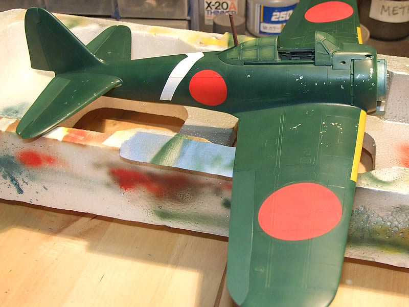

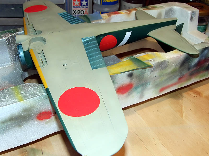

LSP_Kevin Posted October 23, 2009 Author Posted October 23, 2009 Thanks fellas. Good to know someone's getting something out of my backasswardness. She's looking pretty crazy at the moment: I cut the original masks for the hinomarus large enough to encompass the normal white border, and then cut a smaller circle large enough to cover just the area that's supposed to be red. Since this model will represent a machine that's had its white borders over-painted with a dark green colour, the rings have been sprayed Tamiya NATO Black and the outer masks removed. The theory is that when the green goes down, the black rings will darken the top coat enough to show through, but look like the darker green they're supposed to be. This is really just my way of not having to mix paints, and also to not have to do any more masking than necessary! Anyway, we'll see how it pans out... Kev
spacewolf Posted October 23, 2009 Posted October 23, 2009 Hey Kev Totally confused, but gonna sit down, shut up, watch and try to learn something ! Cheers Vaughn
LSP_Kevin Posted October 23, 2009 Author Posted October 23, 2009 Hey Kev Totally confused, but gonna sit down, shut up, watch and try to learn something ! Cheers Vaughn I hear ya mate...I suspected my attempt at explaining what I'm trying to do was as clear as mud. Being stubborn, I'll have another go: Rather than mask, paint and re-mask what should be dark green borders around the meatballs, I've decided to paint the borders black, and then paint the IJN green right over the top in the hope that they'll show through the IJN green as a dark ring. We'll know soon enough! Kev

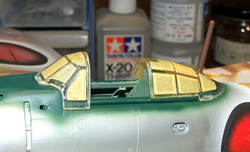

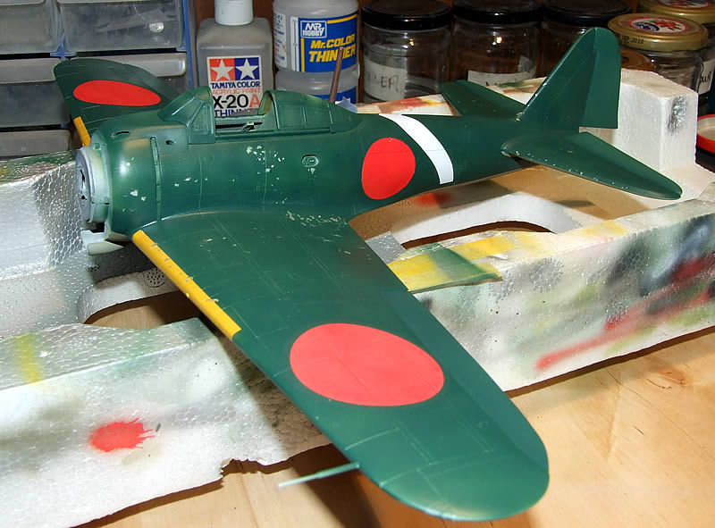

LSP_Kevin Posted October 24, 2009 Author Posted October 24, 2009 Yet another update as I march towards getting the camouflage coats on. I've masked and attached the canopies: I almost always attach canopies prior to the main painting, as it allows me to blend them in properly, and then paint the frames along with the rest of the airframe. The fit of the canopies on these old kits is never gonna allow you to simply paint 'em up and plonk 'em on at the end. I've attached them with CA and I'm using white glue to blend them in. I'll paint in the inside frame colour before doing any more of that though. Here's the yellow wing leading edges, sprayed, chipped and ready for masking: I used Brian's suggested refinements to the salt technique this time, and it certainly is easier to put the salt where you want it, and be a bit more targeted and precise. I did have trouble getting the salt to stick, however, without pre-wetting the model. The bulk of it blew away as soon as I pointed the airbrush at it! Still, probably a good thing, as it might well have been overdone otherwise. I can always add more chips later. Kev
spacewolf Posted October 24, 2009 Posted October 24, 2009 Hey Kev Looks good and the chipping is often overdone. Being that I'm going to be doing a Zero shortly I've been doing research and while most models you see make the aircraft look like there was more metal than paint, what I've found is a lot of pics of aircraft with paint in very good condition with minimal chipping or peeling....even into 43 and 44. I think what you've got there is a good level of wear.. just my 2 cents worth. Cheers Vaughn
LSP_Kevin Posted October 24, 2009 Author Posted October 24, 2009 Hey Kev Looks good and the chipping is often overdone. Being that I'm going to be doing a Zero shortly I've been doing research and while most models you see make the aircraft look like there was more metal than paint, what I've found is a lot of pics of aircraft with paint in very good condition with minimal chipping or peeling....even into 43 and 44. I think what you've got there is a good level of wear.. just my 2 cents worth. Cheers Vaughn Thanks Vaughn. I'm not a fan of the over-weathered Japanese aircraft thing either, as I think it's largely a self-perpetuating myth. However, I'm going to deliberately go a bit overboard with this one, partly so I can experiment with some weathering techniques, partly to add visual interest, and partly to distract from all the things I haven't quite pulled off! Kev

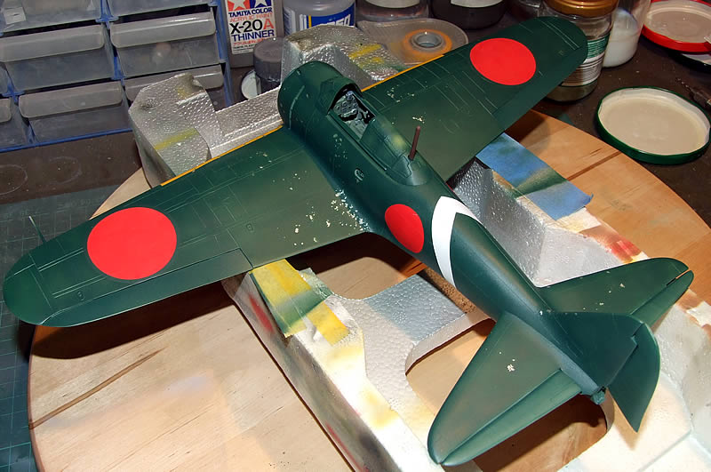

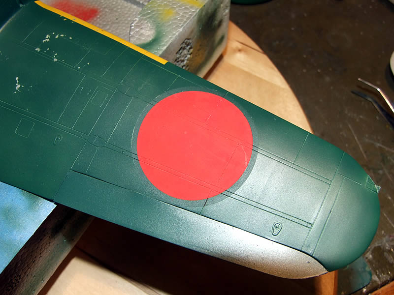

LSP_Kevin Posted October 25, 2009 Author Posted October 25, 2009 Looking forward to the next update Buddy! And here it is! The canopy was painted with acrylics like the rest of the model, so a bit of a soak in Windex and a light scrub afterward took care of that. I gave it about 3 separate dips in floor polish to try to restore some clarity and shine to it, but it was never a great canopy to begin with. It's now breezing gently through "it'll do". OK, so I've got all the major painting done now. The paint chipping turned out to be much less extreme than I was originally planning. This was partly timidity on my part, but I also found laying all the salt pieces down rather tedious, and just gave up once I had a few points of interest covered. I'll add a few more by a combination of scratching/scraping and silver pencil. Photos: Here's a close-up of what I was trying to achieve with the whole hinomaru border thing: Still a way to go though! Next up will be applying a few of the Hobbydecal stencils, then some more paint chipping. Then a gloss coat, decals and a lot more weathering! Kev

spacewolf Posted October 26, 2009 Posted October 26, 2009 Interesting effect, I understand what you were trying to say now. Your chipping looks really good, much more believable than some I've seen. Looking good Kev Cheers Vaughn
