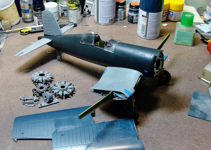

Now for some update pics.
 I have the fuselage all closed up and, painted, sanded, painted, buffed out with an old T- shirt and it will get one more wet coat for blend it all back in.  :mental:
I have also assembled the tail surfaces and they are just dry fit as is everything else in the pic at this point.

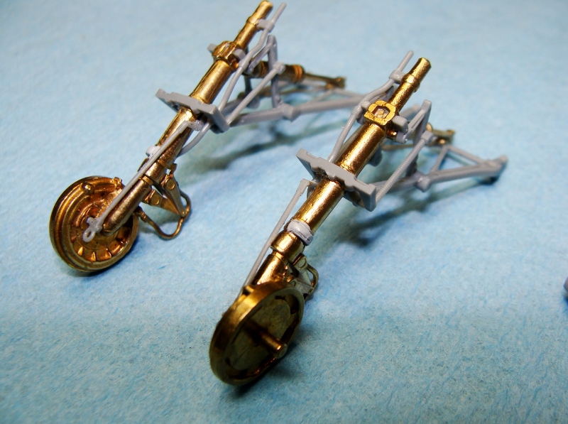

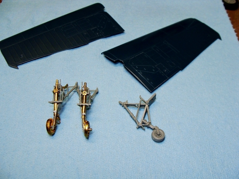

 Here are the landing gear, G Factor brass struts,Tamiya kit parts. The G Factor Gear cleaned up nicely with a small bit of file work and a wire brush in the Dremel. The plastic kit parts and the brass mate up just fine.
I used Tamiya AS-8 on the outer top wing panels just because, I will use the lighter blue of this color as a base coat for the follow on wet coat to match Custom GSB( mixed from Gunze paints)  I already have on the fuselage. AS-8 is WAY to bright for a late war GSB Corsair in my opinion.
The airplane I'm modeling and most from the squadron were new issue, and only had the last 3 mos of the war to get through. They were in great shape and very little weathering can be seen on the aircraft. I used the Tamiya AS- 8 and sanding with various grades to leave a slightly different "texture" on the fabric areas of the wing and tail surfaces.
The whole aircraft will be all one color blue, and this should help the fabric areas stand out just slightly.

The cockpit decals really bring the pit to life. We get so much choice, now, on how to add details to pits. The G factor legs, are the details that much better than the kit parts?
Don
Hi Don, Im glad you enjoyed the cockpit stuff!  The details on the brass gear are identical to the plastic. I used the G Factor gear legs for strength, I know I am going to pick this thing up a lot once its done, its to cool  a model not to.  :)  I want to make sure every time I put it down it's on solid gear. The kit gear would be fine for those of you who dont occasionally take a model out of its case just to look at it...a lot. lol
