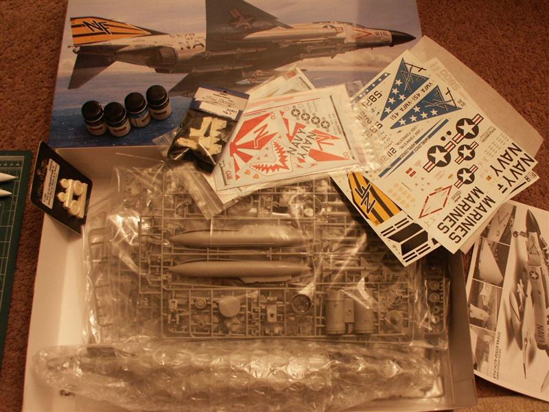

ruzlkampf Posted November 16, 2008 Posted November 16, 2008 Realized I haven't built an American marked aircraft since I joined this forum, AND I still have a 'jet bug' that won't go away! Finishing off the A4-G tomorrow, so I got the Tamiya Phantom fuse outta it's bubble-wrap to play with. Whoohoo! I'm tired of white/gull grey, so this will be painted in the 4-tone Heater-Ferris camo with low-viz markings. Got some True-Detail seats, my usual MasterDetails pilots, and some resin wheels,,,,but meh, they're Air Force rims so I'll go with the kits stuff. Gonna be making my own decals again, and I'll be scratching up some slats. Here's what I'm starting with; Showtime 100 1

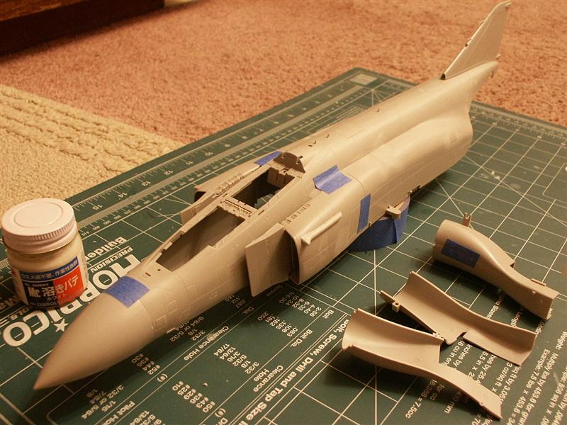

ruzlkampf Posted November 17, 2008 Author Posted November 17, 2008 Bwhahah! Actually Bozzaroo, there IS a motive to my madness. Glad ya liked the A-4, I've got more Aussie projects planned for this new year! The A-4G was completed today, along with the Me-109G-6. Weathered them together while I had everything out. Everything came to a screeching halt when I attempted to take some gallery shots in daylight. I MUST have better lighting, so I'm going shopping for something to improve my photography. I only have 3 weeks into the XF5-U, and I'm planning on finishing it during/before the end of December as I have a lot of 'holiday time' and it's over 1/2 way done. Sooo,...until then I'm gonna have fun with this here Phantom. Got 9 days off for Thanksgiving, so I should be able to make a dent in this thing, eh?! he he. After the 1st of January, I'm going to go large and fast with a scratched SR-71 and XB-70 Valkyrie. Amongst other 'things'. Lotsa Reno air-racers probably.(I do like to chop engines off and modify things!) It's going to be a good year methinks. But I digress; After throwing up my hands in anguish trying to take gallery shots, I went ahead and shaved off all the raised panels/battle damage patches/whatever they are and rescribed and 'riveted' everything they were covering. I counted 23 of these 'interesting phenomenon', if ya include the 2 on the tail-fin. Hmmmm, because of my camo scheme....I need smooooth.(and I didn't see ANY of these on a real AC) Here's some crappy pics., There were 5 in these areas alone. All gone now....heh heh. Showtime 100 1
ruzlkampf Posted November 17, 2008 Author Posted November 17, 2008 Moving on to the intakes. Ain't gonna get any fancy resin stuff, cause I've got plan A-B-and C. All are 'out of the box', 'non-linear' thinking train wrecks,...but it promises to be mucho fun! Parts laid out for pondering what I'm going to hack on first. Oh yeah, if anybody tries to open those holes for the AN/APS-127 DECM bumps on the intakes....they're in the wrong place. Front hole needs to be a mite lower, or it sticks up at an un-natural angle. Also need a shim under that hatch on the spine, or it sits too low in the fuse, BTW. PS, I'm going to be using MasterDetail pilots, and I'm kinda leaning toward the head that has a face that looks like it's 'cuckoo for cocoa-puffs'. Dunno yet. More pics as things progress. Russ Showtime 100 1

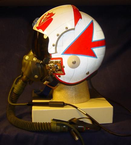

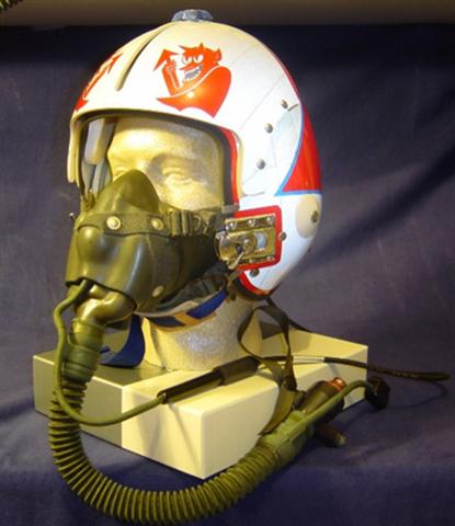

ruzlkampf Posted November 17, 2008 Author Posted November 17, 2008 Whoooo, Aussie P-40 is gonna be a gnarly cool project! I'm tap dancing on the ceiling right now, cuz I just figured out how I'm going to paint my pilots helmet. Whoohoo! Searching for VF-301 helmet designs, I found out that collecting helmets and ejector seats is a big sub-cult. Big bucks!!! Anywho, I've decided to model a 1/1 scale ejector seat for my computer chair. Maybe a Martin-Baker MK-7 like in this Phantom? Hmmm, the possibilities. And I wonder why I'm not married. Here's how VF-301 helmets looked in the time frame of the camo I'm painting. Circa 1982-84. I must have one of these for my own personal amusement. Believe it's an APH-6D style helmet/mask. Go well with my new computer chair, yes?! Bwhahah! Showtime 100 1

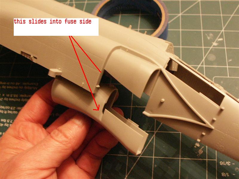

ruzlkampf Posted November 18, 2008 Author Posted November 18, 2008 Ooooh yes, you are a devious wretch, Matt! The marmot eyelash paint-brush is now obsolete,...I have been designing a new brush using nano-strand technology and I must cultivate the strands in a petri dish under laboratory conditions. I've been looking for somebody who 'ties fishing flies' to get it on the end of a brush, but they won't talk to me until I can grasp the pebble from their hand. Sigh. Okay!!, Young Master Derek has thrown down the gauntlet, and won't be appeased until I show him how to make some seamless intakes for this thing,....using only rounded creek rocks, a tube of toothpaste, a jar of peanut butter, and a hammer. Can you feel the tension? So, I've already started 'Dereking' the hell outta this at the start of day 2. Whoohoo! For those of you who don't have the kit,...here's what ya get. Showtime 100 1
ruzlkampf Posted November 18, 2008 Author Posted November 18, 2008 Problem is, when you put the outer nacelle on and look into it. Whooo, not good. The splitter plate hides most everything on the side towards the fuse, but the other side? Words fail. This is what ya get when it's dry fitted. Let's start chopping. Martinnfb, Paul in Napier and Showtime 100 3
