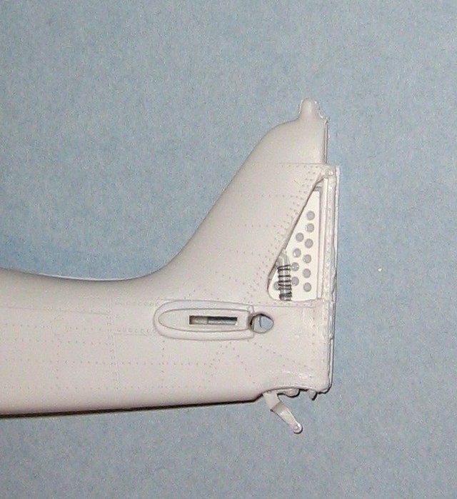

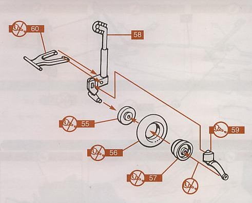

Hacker Posted February 18, 2008 Author Posted February 18, 2008 Hey Dave your getting quite good at this Seriously mate thats a great job your doing there and it's mighty impressive. Graham. Fantastic work man, that is absolutely great scratchbuilding you are doing there. Thanks guys always like to hear what you have to say Still working on the Wheel wells but in between l been doing the tail as well. Airfix gives you a good representation of the tail wheel. all the parts that need to be there are there. The only thing is the wheel well lack detail.
Hacker Posted February 18, 2008 Author Posted February 18, 2008 here is what l got so far. l may decide to alter it by cutting off the kit hydralic jack and replacing it with a brass one but the jury still out on this but its leaning heavily towards doing that
Hacker Posted February 18, 2008 Author Posted February 18, 2008 l build the interior to better represent what you would find when the access door of the tail is opened. Using drawings l have l was able to construct this as prototypical as l could l kept checking to see if the tail wheel assemble fits properly l even dry fitted the other fuselage half on to make sure everything fit and it looks proper Well back to the wheel wells. Hopefully l will have those done and move on to the wing gun bays. later

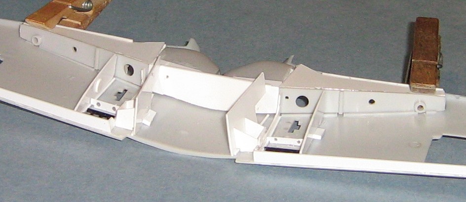

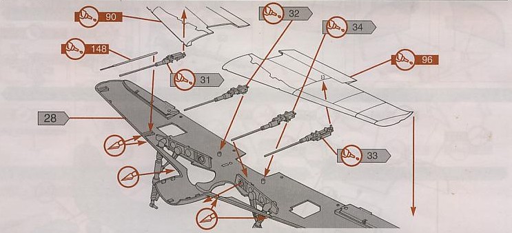

Hacker Posted February 19, 2008 Author Posted February 19, 2008 Just some posting of some of my progress before l call it a night The cannon installations in the wings are well void of any details. The cannons are nicely detailed but that about it.
Hacker Posted February 19, 2008 Author Posted February 19, 2008 here is my scratch build details for the upper gun bays. l notice in the pics there is one or two mistakes l have to rectify in the morning but all in all l think it came out good. Well thats all for now later
