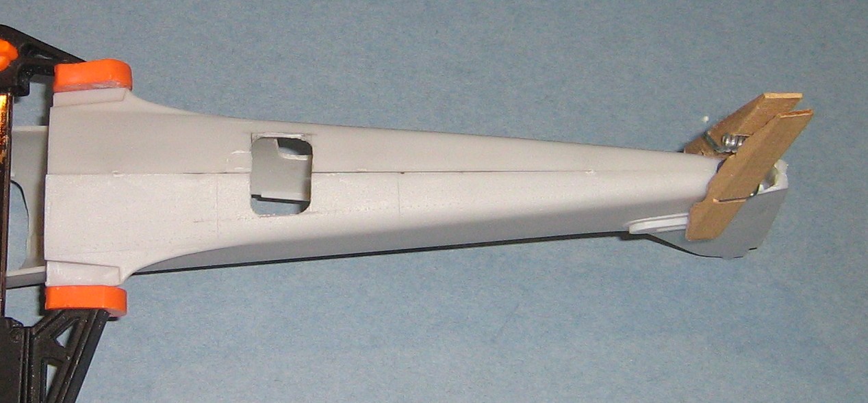

CharlesMetz Posted February 15, 2008 Posted February 15, 2008 Rear fuselage....lack of any detail which is OK if you build OBB but l am opening up the access panel on the side so this will area will be detailed with scratch build items. the bottom hatch is missing here as well so this will have to be scratch build and the hole for the stand will have to be filled in I've always felt that the cross-section of the kit's fuselage is a bit too rectangular just ahead of the tail. Does anyone else have an opinion on this? Charles Metz

Hacker Posted February 16, 2008 Author Posted February 16, 2008 Wow, ambitous project!Jerry Rutman has some resin for this kit including cockpit, FYI. l see that but l decided to go scratch build here. so the hacking begins first off we marked off in pencil what we intend to remove here we have cut off an extra panel on the nose and opened the panels for the rear fuselage and the vertical stabilizer We also at this time marked out were the access panel on the lower rear fuselage is suppose to be and cut this out as well

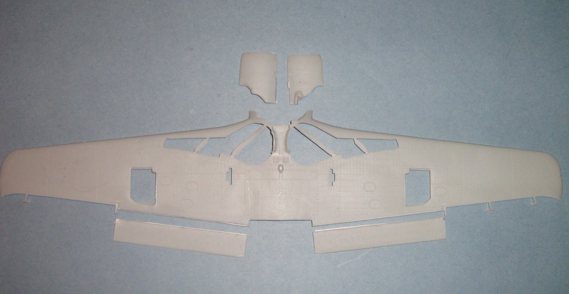

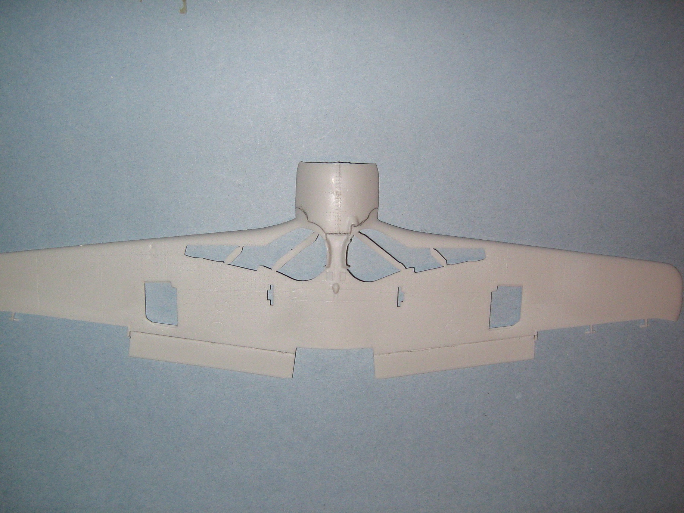

Hacker Posted February 16, 2008 Author Posted February 16, 2008 On the lower wing half l marked off the flaps that need to be cut out and the nose panels as well so there is the lower wing as it stands now. l am currently in to process of making a new fire wall and starting the process of redoing the cockpit so stay tune

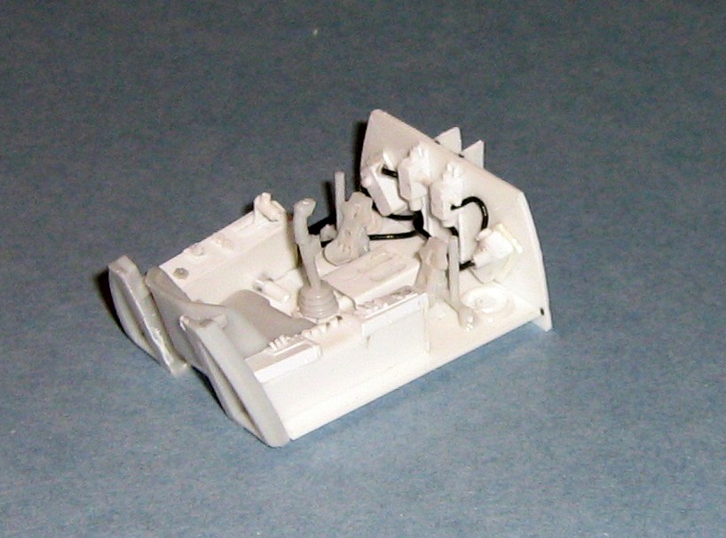

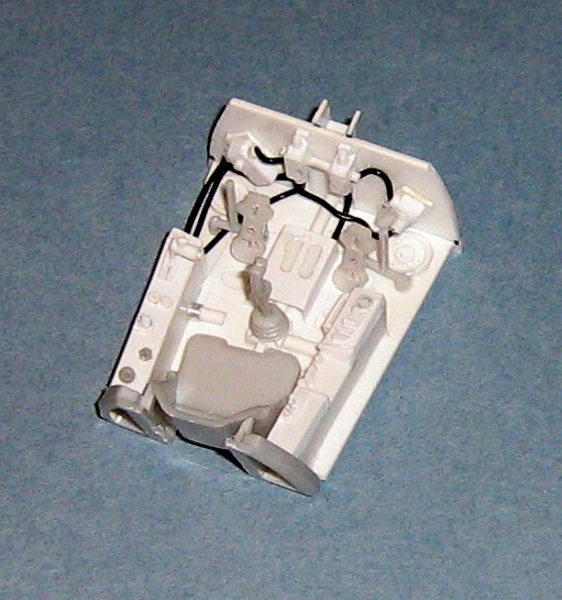

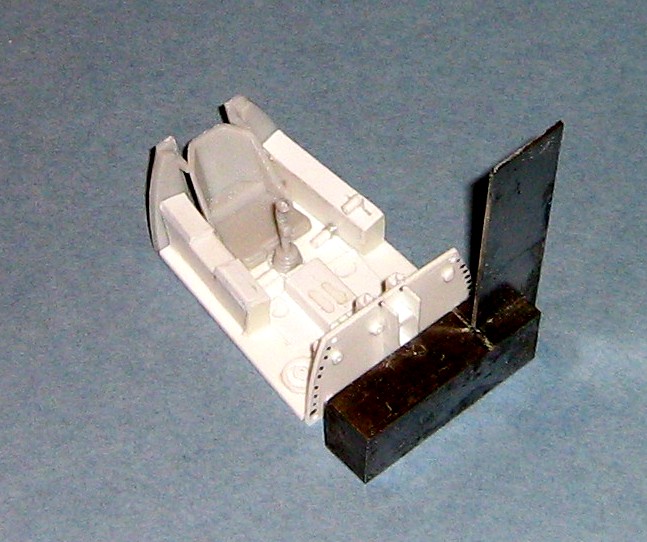

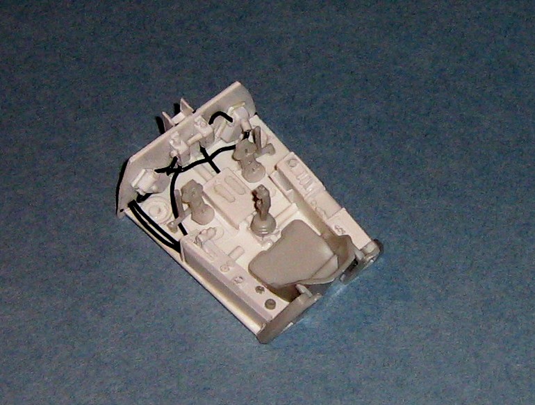

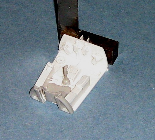

Hacker Posted February 16, 2008 Author Posted February 16, 2008 Well yes we are mad and l will tell you why l had a look at the cockpit and decided to toss the thing it was just not working for me neither was the firewall. so l toss the cockpit and l cut the ammo boxes off the fire wall and toss it too. At this time too l decided to toss the upper gun deck as well
Hacker Posted February 16, 2008 Author Posted February 16, 2008 In with the new scratchbuild cockpit and fire wall. l kept the back of the kit part but l cut the center of out it and glued it to the new cockpit. l kept the seat and the joystick. this is how much l got done so far. l think it is a vast improvement on the old one. Need some more detail work but hey thats half the fun here all for now later
Hacker Posted February 17, 2008 Author Posted February 17, 2008 just some last minute pictures before bed of what l have done since my last posting

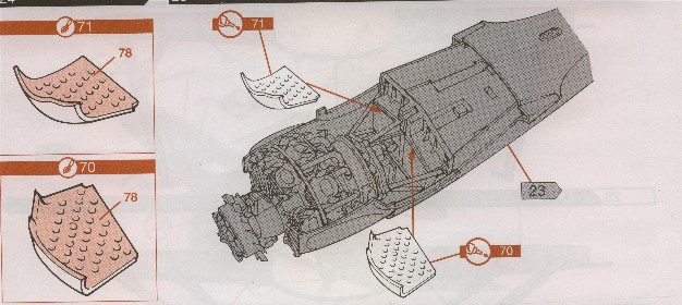

Hacker Posted February 17, 2008 Author Posted February 17, 2008 Here is the instructions for the wheel wells on the kit. Showing you the instructions is much easier here. As you note not much details is there. So l been building new wheel wells using the kit wing spar and the perforated inserts
