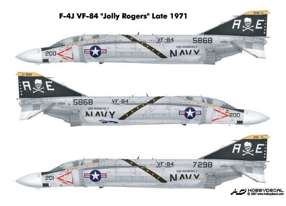

DaveJ Posted November 13, 2007 Author Posted November 13, 2007 A small update tonight with a bit of a Woo Hoo! Milliput rocks. The nasty gaps have been filled with almost no sanding required. This makes me very happy... With just a tiny bit more to completely clean-up the panel lines and rivets I can move on with this kit. My next challenge is getting the tail ready to paint and add markings. The crossbones tail art is a very large dry-transfer and I'm not about to try to apply it after the tail is glued in place so I need to make sure the fit will be seamless. This will also allow me to bail and revert to some other scheme if I screw the dry-transfer up beyond repair.

Ian Aylmer Posted November 13, 2007 Posted November 13, 2007 Hi Great looking filling, my biggest headache!!! It always seems to go concave when I do it? You seem to have gaps where I don't, weird. Lucky me Good work, can you post a picture of the decals you are going to use? Thanks Ian
DaveJ Posted November 13, 2007 Author Posted November 13, 2007 Hi Great looking filling, my biggest headache!!! It always seems to go concave when I do it? You seem to have gaps where I don't, weird. Lucky me Good work, can you post a picture of the decals you are going to use? Thanks Ian Oops! I thought I had posted the scheme back at the beginning. I had to go looking to see that I hadn't. The markings come from HobbyDecal and are really amazing, there are just a ton of them. The data stencils alone will take forever, especially since they're dry-transfers. Everything down to panel numbers is included.
