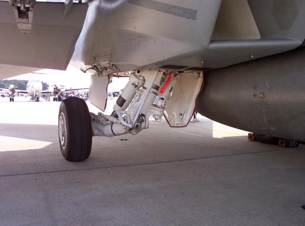

DaveJ Posted August 30, 2007 Author Posted August 30, 2007 A question of accuracy vs 'looks cool' for you all: Many Phantoms have the red primer around doors, inside the flaps, etc. I think that adding that on model Phantoms really dresses them up, but in the photos I've found of the actual bird I'm planning it seems like this wasn't there. So what do you guys think? Go for the accuracy? Or go with what I think looks cooler? Thanks in advance for your opinions!
DaveJ Posted August 30, 2007 Author Posted August 30, 2007 Good work Dave, glad to see you're able to get going on it again. I'm intimidated by PE myself, so I'm already impressed! Kev Thanks Kev! These turkeyfeathers were super simple to install but I have been intimidated by some of the microscopic PE bits also. I just pick and choose the bits I want to use rather than sweat over one tiny bit that the Carpet Monster is likely to eat anyway.
LSP_Ray Posted August 30, 2007 Posted August 30, 2007 A question of accuracy vs 'looks cool' for you all: Many Phantoms have the red primer around doors, inside the flaps, etc. I think that adding that on model Phantoms really dresses them up, but in the photos I've found of the actual bird I'm planning it seems like this wasn't there. So what do you guys think? Go for the accuracy? Or go with what I think looks cooler? Thanks in advance for your opinions! I don't think it is red primer, I believe it is a Navy warning paint of finger/arm pinching areas. At least it shows in most Navy a/c of the 60's-70's. Not sure when they stopped the practice, but they don't have it now. So probably depends on the timing of your scheme. I'm thinking it left the same time as the white/light grey scheme, but not positive.
Mark B. Posted August 30, 2007 Posted August 30, 2007 Dave, Great work on the PE on the cans. It makes all the difference in the world to the kit parts. Oh and Ray, I don't think it is red primer, I believe it is a Navy warning paint of finger/arm pinching areas. At least it shows in most Navy a/c of the 60's-70's. Not sure when they stopped the practice, but they don't have it now. So probably depends on the timing of your scheme. I'm thinking it left the same time as the white/light grey scheme, but not positive. While you're right about the red edges being a warning marker your wrong about them being phased out. So you should include them Dave. A super simple way to do the red edge is to "draw it on" with a fine tip red Sharpie pen. Check these super bug doors:
DaveJ Posted August 31, 2007 Author Posted August 31, 2007 Dave, Great work on the PE on the cans. It makes all the difference in the world to the kit parts. Oh and Ray, While you're right about the red edges being a warning marker your wrong about them being phased out. So you should include them Dave. A super simple way to do the red edge is to "draw it on" with a fine tip red Sharpie pen. Check these super bug doors: Yeah, I think the red is in. The pics I have are all from a distance so I couldn't be 100% certain either way. In retrospect I think it might've been even better to paint the cans before adding the PE. As it is now I'll be priming and painting metal in order to attempt to make it look like, well, metal.
