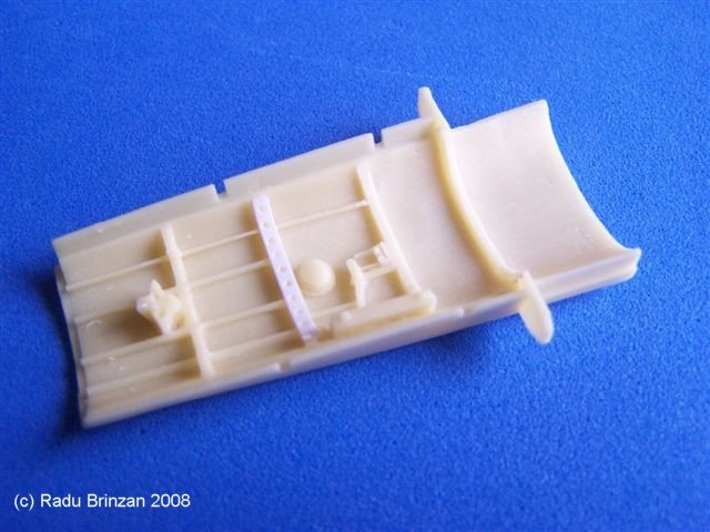

I started to modify the Aires cockpit. I did not like the way they depicted the rudder bars and the floor boards. To me, one of the most interesting things about the Spitfire cockpit is the "hollow" look of the floor. The Aires floor is too solid for my liking.
Here is a photo of the Aires parts, taken from the review on LSP.
Photo: http://www.largescaleplanes.com/reviews/Af...t/images/02.jpg
Review: http://www.largescaleplanes.com/reviews/Af...Aires_2061.html
All that detail was removed with a dental burr. I already started to detail it with the perforated strip.
More photos soon.

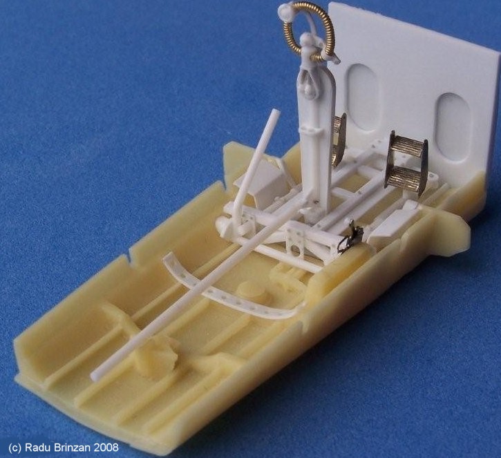

Anyway, back to business now. the cocpit floor is finished. here are a couple of pictures.

The rudder pedals are from the Aires set and the other metal parts for the drop tank (on the side of the floor) are from Eduard. All cables and pipes will be added after painting.
The conrol column grip is piece of guitar string. Other than that, the rest is all plasticard and Evergreen rod. I did some work on the other parts of the cockpit. More photos soon.
So far, I must say that I do not think this is Aires' best effort overall. I have been a fan of their work for years, and I know that they are capable of stellar work, but this set is almost as if it was outsourced to someone else... The absence of the front wall/firewall is impossible to understand. Without it, you can see through the wheel wells. Actully, more issues will become obvious when you see the other work I needed to do to fix what the "update set" was supposed to fix. And this is not me being a fusspot or a perfectionist...I could live without a cable, a lever or a box...but things such as a firewall are things that are conspicuous by their absence.
