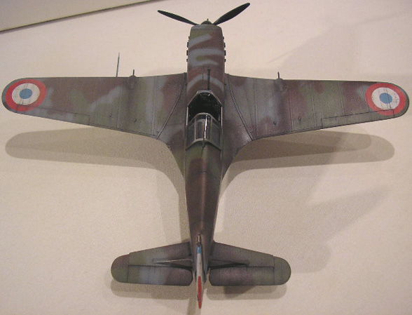

Anders_Isaksson Posted March 12, 2020 Posted March 12, 2020 Anyone know how to get in touch with Gustave regarding his build of this beautiful MS 406? I have tried direct messaging and seeing that he was last online here back in 2011 I don't have high hopes for getting a reply. Just curious about exactly he modified the windscreen and created the glass portions. Thanks for any help!
alain11 Posted March 12, 2020 Posted March 12, 2020 hi the issue is not the windscreen that looks too narrow , but rather the fuselage that is too wide , so it needs some surgeries .. I can advise you to contact " waroff " he is the expert with a big E , he will explains you how to get a correct MS 406 Alain https://www.google.com/url?sa=i&url=https%3A%2F%2Fwww.largescaleplanes.com%2Farticles%2Farticle.php%3Faid%3D1879&psig=AOvVaw2VQaqTxbW8PBTMbxX30tVi&ust=1584122224098000&source=images&cd=vfe&ved=0CA0QjhxqFwoTCPiZ2KjBlegCFQAAAAAdAAAAABAg
Anders_Isaksson Posted March 13, 2020 Posted March 13, 2020 14 hours ago, alain11 said: hi the issue is not the windscreen that looks too narrow , but rather the fuselage that is too wide , so it needs some surgeries .. I can advise you to contact " waroff " he is the expert with a big E , he will explains you how to get a correct MS 406 Alain Many thanks Alain! I see that I have some work cut out for me if I want to make a more accurate 406. Will have to ponder this project some more...
alain11 Posted March 13, 2020 Posted March 13, 2020 4 hours ago, Anders_Isaksson said: Many thanks Alain! I see that I have some work cut out for me if I want to make a more accurate 406. Will have to ponder this project some more... I built some years ago the Azur kit without the needed surgeries , I remember I cut the front windscreen part , glued the two lateral parts in place ( tricky !!) and glued another front part cut into a clear CD box , yes , I agree , a bit too thick... the end justifies the means .. doesn't it Alain
Anders_Isaksson Posted March 14, 2020 Posted March 14, 2020 23 hours ago, alain11 said: I built some years ago the Azur kit without the needed surgeries , I remember I cut the front windscreen part , glued the two lateral parts in place ( tricky !!) and glued another front part cut into a clear CD box , yes , I agree , a bit too thick... the end justifies the means .. doesn't it Alain Good info, thanks! I may try to reduce the width of the forward top fuselage by at least 2 mm instead, because where I'm sitting anything sounds easier than having to rebuild the windscreen.
alain11 Posted March 14, 2020 Posted March 14, 2020 hi rebuild the windscreen is not that hard to achieve , you only have to take care of the two lateral parts in order to get a nice " square " front part . if you intend to reduce the top fuselage , you will have to rework the whole cockpit width : IP , floor etc , if you don't you will met issue to close the fuselage ... hope I 've been clear Alain my 406 ... not the ideal , or accurate , but it's works for me in any case , the kit has its flaws here and there , it depend how far you will go in accuracy here is how to rework the top fuselage ( Waroff advises) : remove more or less 1mm in front of the windscreen , and 5mm at the other side corsairlada, Landrotten Highlander and Anders_Isaksson 3
Anders_Isaksson Posted March 15, 2020 Posted March 15, 2020 17 hours ago, alain11 said: hi rebuild the windscreen is not that hard to achieve , you only have to take care of the two lateral parts in order to get a nice " square " front part . if you intend to reduce the top fuselage , you will have to rework the whole cockpit width : IP , floor etc , if you don't you will met issue to close the fuselage ... hope I 've been clear Alain here is how to rework the top fuselage ( Waroff advises) : remove more or less 1mm in front of the windscreen , and 5mm at the other side I see, and your windscreen looks very good as you have done it. Great work! And yes, I understand the work needed to modify the interior bits, but it still looks like a manageable solution. Many thanks for the overhead photo of the nose, that clarifys the modification needed. Excellent stuff!
