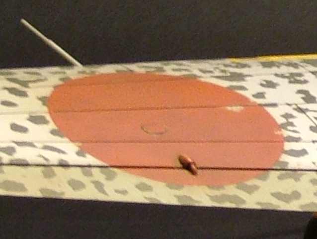

G'day Ango. Is this the sort of thing you are talking about (piccy attached)?
The big (AFAIK) good quality hino decals provided with my re-popped Hase Ki43 had the same challenge of forming decal over aileron actuators.
The way I tackled it (in my ignorance of any more advance modelling techniques) was to place decal, then apply, re-apply and then re-apply again etc. a decal solvent/setting solution - in this case Mr MarkSoftener. (I've now obtained some Microsolve and Microset which I hope will be easier.)
Anyway, I worried the hell out of/worked the offending area with my softest small brush throughout the process. Gradually (very slowly) the little bugger softened (almost melted) and I was able to form it up over the actuator and tuck it into the recesses with the brush.
On one side it did tear, but against a base NMF this is passed off as "scratching on raised paintwork" and looks acceptable as such. IIRC I may have even added a touch of red paint to "correct" my hamfistedness.
