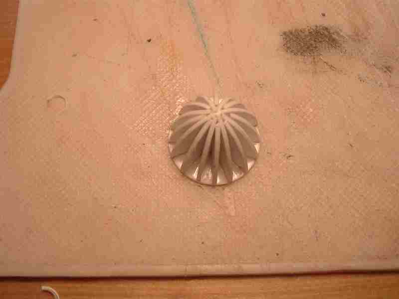

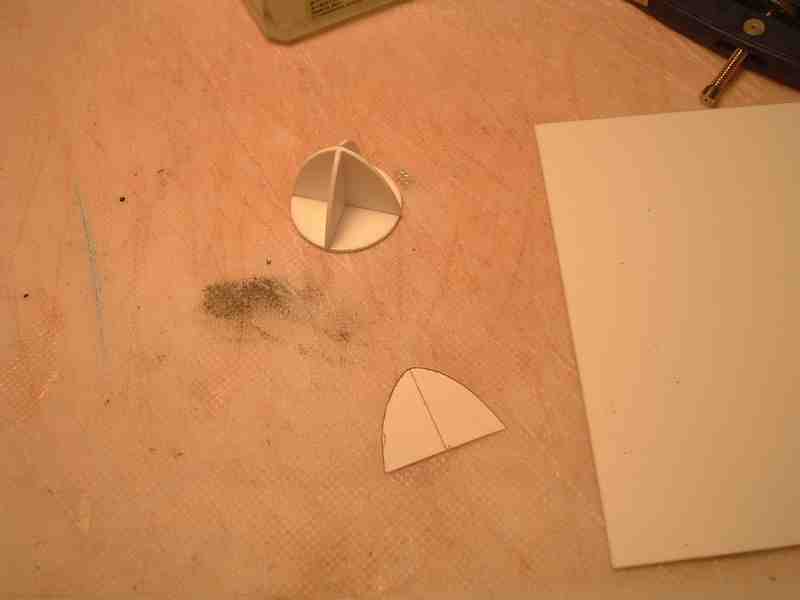

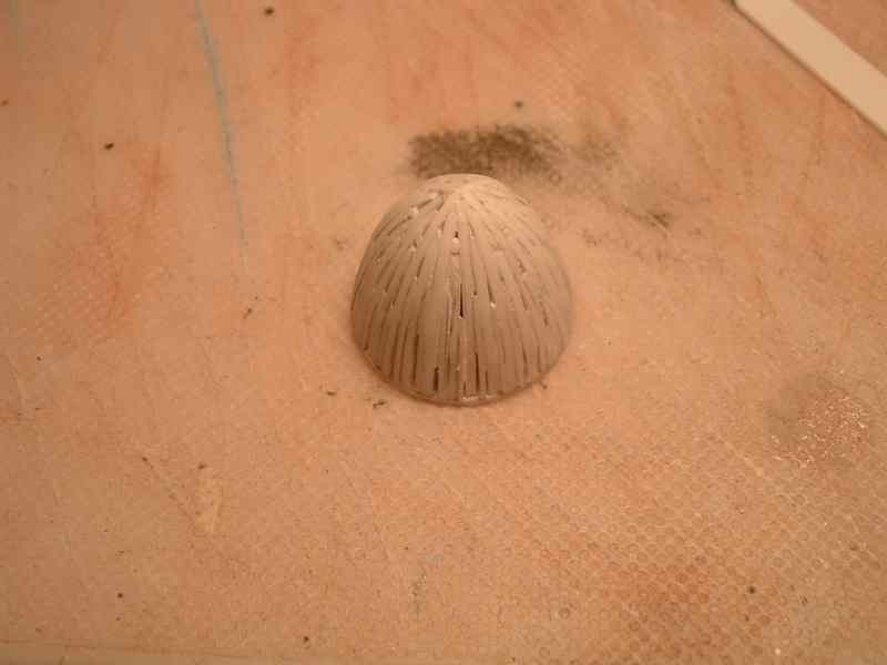

spacewolf Posted July 14, 2010 Author Posted July 14, 2010 Been doing a lot of thinking about how to do things and what to do next. I was thinking of vacu forming the spinner but being the impatient type didn't feel like building the thing yet so I set out to do it this way... this is not for the faint of heart...but perhaps the weak of mind ! First thing was to cut a disc for the back plate. Then using the spinner outline I cut out the shape, then two half parts and glued 'em on. Then more half shapes trimmed to fit.... Then more half shapes using thinner sheet.... Then even more and scraps to fill holes

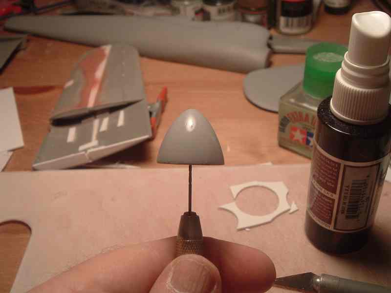

spacewolf Posted July 14, 2010 Author Posted July 14, 2010 Finally the holes and gaps are mostly filled and everything is sanded to shape. Several coats of super glue, sanding between coats filled the holes and gives a smooth surface. Shot with primer it looks pretty good. There is more to do to smooth this down to where I want it but I'm rather happy with the way i'ts turning out.

Derek B Posted July 14, 2010 Posted July 14, 2010 A 'grunt' ?... not familiar with that term (except pertaining to infantry ) Vaughn Ah, Kev is correct...that would equate to 'Ummmph' in terms of engine power... Brilliant Spinner Vaughn, I love it (my kind of scratch building!). Derek
