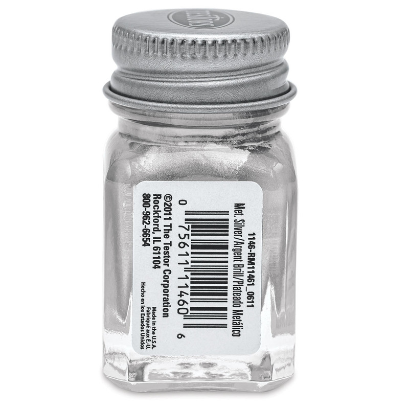

Grunticus Posted March 30 Posted March 30 I use MRP paints almost exclusively, but they can't be brush painted. I am looking for a good covering silver paint to hand paint buckles and other tiny parts. Which do you guys use and what could you recommend? Properties I am looking for is good adhesion to metal and good coverage and the least possible amount of grain, and slow-ish drying time. Fine brush recommendations are also welcome. Thanks for any input! Cheers, Leon
Thunnus Posted March 31 Posted March 31 I like the old Testors Silver for brush painting silver... And I like the W&N sable brush in #00 size... Dragon, A-10LOADER and Grunticus 3
Grunticus Posted April 2 Author Posted April 2 Thank you John, I will order a bottle, and that brush. Thank you for suggesting it, appreciate it much.
LSP_K2 Posted April 4 Posted April 4 I too use Testors silver but with just a dab of black to tone sown the otherwise chrome look of the silver. Grunticus 1
dutik Posted April 5 Posted April 5 On 3/30/2025 at 8:15 PM, Grunticus said: I use MRP paints almost exclusively, but they can't be brush painted. I am looking for a good covering silver paint to hand paint buckles and other tiny parts. Which do you guys use and what could you recommend? Properties I am looking for is good adhesion to metal and good coverage and the least possible amount of grain, and slow-ish drying time. Fine brush recommendations are also welcome. Thanks for any input! Cheers, Leon If you prefer acrylics I recommend Vallejo Model Air 063 silver. Easy to brushpaint, good adhesion, fine pigment, very silver looking. Regards - dutik Grunticus and LSP_Kevin 2
Grunticus Posted April 12 Author Posted April 12 On 3/31/2025 at 7:24 PM, Thunnus said: I like the old Testors Silver for brush painting silver... And I like the W&N sable brush in #00 size... And you were not kidding John. What a joyful brush for fine work, and the paint is exactly what I was looking for as well. Thanks again! chukw, A-10LOADER, Thunnus and 1 other 4
Thunnus Posted April 16 Posted April 16 I'm glad that worked out for you, Leon! I have not found a better brush-applied silver than the OG Testors enamel. It has such superb coverage that it only requires a touch of the brush tip. A-10LOADER and Grunticus 2
