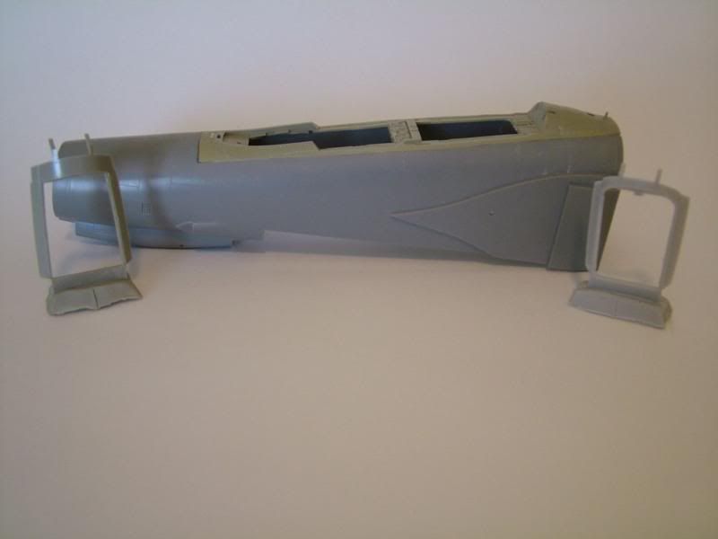

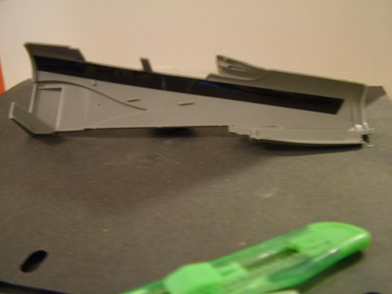

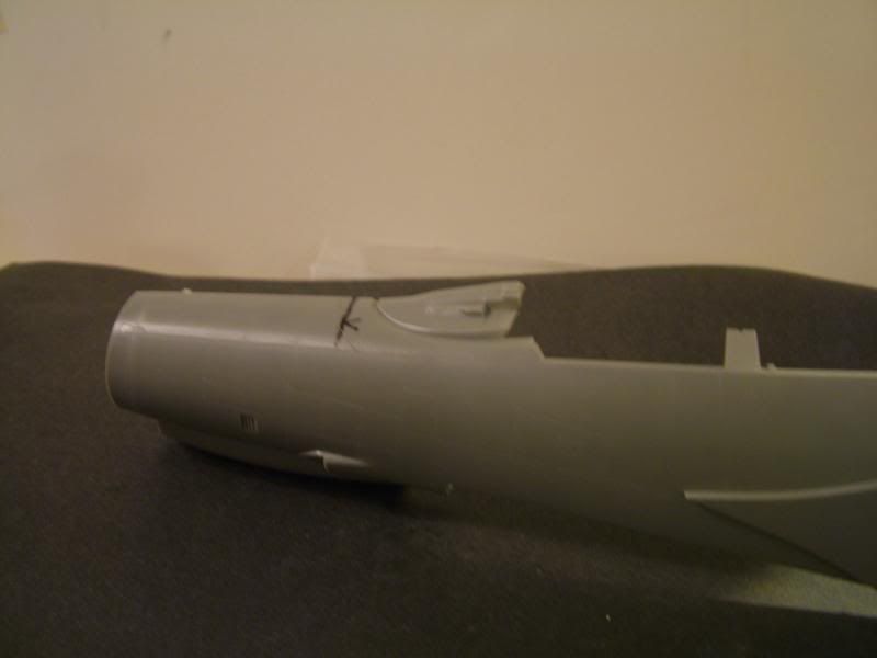

Bruce Posted May 1, 2014 Posted May 1, 2014 (edited) I'm building this a/c in honor my good friend and pilot training mentor. I'll be using the Revell E model with numerous modifications and extra parts that I've either made, borrowed from other kits, bought, or made molds and cast copies here are just some of the pieces. I made a copy of the Tamiya canopy rail area and canopy frames. I have grafted the rail to the Revell fuselage and will use the frames and extra glass from Tamiya. On the Revell kit I cut just under their canopy frame and in front of the instrument shroud. I then grafted my resin copy of the Tamiya area. The reason for doing this is I'm using the more correct canopy glass from a Tamiya kit and am using a Avionix cockpit set Edited January 16, 2018 by Bruce LSP_Paul, Kagemusha and Daniel Leduc 3

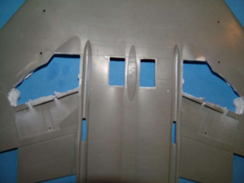

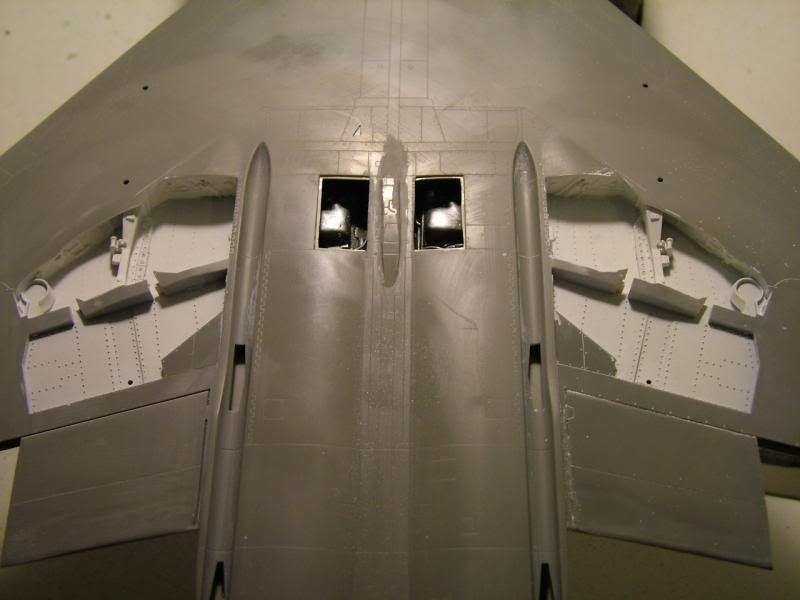

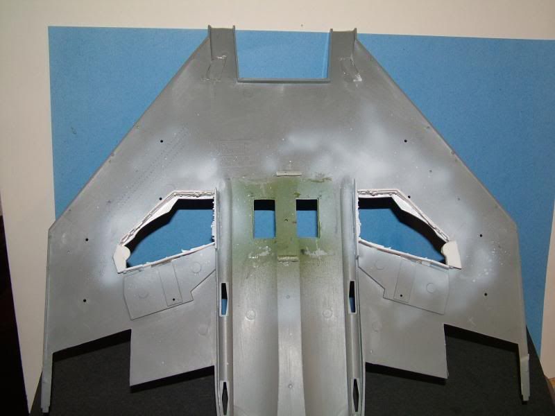

Bruce Posted May 2, 2014 Author Posted May 2, 2014 One of the things I deceded to do was to deepen the wheel wells and add my engine bay set. I cut out the wheel wells leaving only the landing gear mounting points and I cut out the door 81L & 81R locations. I made some molds from the Tamiya wheel well parts (modified a little) and added them to the Revell wheel wells. I painted my engine bay set and added some extra piping using lead fishing line. inside view with Tamiya copy/modified resin parts. from the bottom, not perfect but better than the original LSP_Paul and Derek B 2
LSP_Paul Posted May 2, 2014 Posted May 2, 2014 On 5/2/2014 at 11:47 PM, Bruce said: One of the things I deceded to do was to deepen the wheel wells and add my engine bay set. I cut out the wheel wells leaving only the landing gear mounting points and I cut out the door 81L & 81R locations. I made some molds from the Tamiya wheel well parts (modified a little) and added them to the Revell wheel wells. I painted my engine bay set and added some extra piping using lead fishing line. inside view with Tamiya copy/modified resin parts. from the bottom, not perfect but better than the original WOW Bruce that's a great improvement! Really beings the Revell kit up to par Great work! Paul

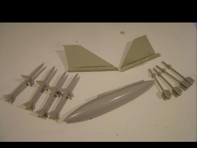

Bruce Posted May 3, 2014 Author Posted May 3, 2014 some of the other parts and such....I'm using the Aim-9s and centerline tank from Tamiya kits and I cast copies of the outer wing section from a Revell RF-4C kit. I will remove the strengthening panels since at this point the F-4E didn't have them. I have also remove them from the horizontal stabs. Bruce
