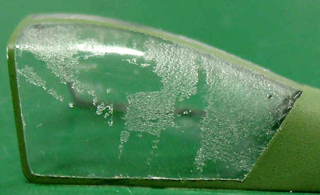

Wurzacher Posted February 26, 2010 Posted February 26, 2010 But... be careful using the black masking material on a futured clear part. Had futured a 1/48 scale Ta 152 canopy weeks before i masked it with the black material from Montex. Than sprayed the model as usual and took it outside to dry in the sun. Wasn´t too long laying in the sun for i was worried about the black vinyl getting too hot, so i took it back in the house after some 10 minutes. Than the surprise: i nearly wasn´t able to remove the mask from the canopy for the mask was sticking this strong to it. Had to use a nipper to rip it from the clear part, and then was shocked: A lot of the glue bonded to the Future! What a mess!

Wurzacher Posted February 26, 2010 Posted February 26, 2010 Struggled some time with me and my fate. Tried alcohol and other stuff that i thought might help to remove this sticky glue from my canopy. No success... Than i remembered an article in FineScale Modeler where someone mentioned a product called "GooGone". Now, this is not available here in Germany, but a friend of mine has a friend with access to a PX store. So i manadged to get a bottle of it. And: As clear as it could be! And the best of it: GooGone did not harm my Gunze paint at all! Man, i was a lucky man again! Conclusion(at least for me): do not let a Future coated clear part bake in the sun or excess heat! The longer the Future has dried before applying a vinyl mask the better. And it is good to have GooGone nearby! Montex masks are a dream to me. Started using them not too long before, but will have a look on them whenever i can.
Out2gtcha Posted February 26, 2010 Posted February 26, 2010 Than i remembered an article in FineScale Modeler where someone mentioned a product called "GooGone"....... AMEN BROTHER! I discovered GooGone about 5 years ago hear in the states and have not ever looked back. It works wonders on most everything including removing bumper stickers, making tape residue, dirt, gum, crayons, and most anything sticky. But as Thomas mentioned earlier, it works by way of some wacky citrus ingredients and doesnt seem to effect paint or clears (smells citrus fuity as well!) Cheers, Brian
LSP_Kevin Posted February 26, 2010 Posted February 26, 2010 But... be careful using the black masking material on a futured clear part. Had futured a 1/48 scale Ta 152 canopy weeks before i masked it with the black material from Montex. Than sprayed the model as usual and took it outside to dry in the sun. Wasn´t too long laying in the sun for i was worried about the black vinyl getting too hot, so i took it back in the house after some 10 minutes. Than the surprise: i nearly wasn´t able to remove the mask from the canopy for the mask was sticking this strong to it. Had to use a nipper to rip it from the clear part, and then was shocked: A lot of the glue bonded to the Future! What a mess! This exact thing happened to me recently on a Minicraft 707 build. I had masked it up and sprayed the lower surface colours, and then left it outside to dry. Not in the direct sun mind you, but it was a very hot day. Anyway, I found that the glue from the masking tape had bonded nicely to my paint job. I won't even bother telling you about the mess I made trying to clean it up... Kev
