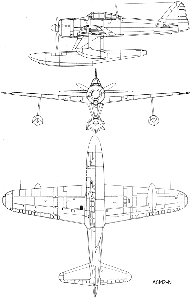

LSP_Kevin Posted October 31, 2009 Posted October 31, 2009 Good work Vaughn. Man, you're off to a flyer! Hmmm.... me thinks a scratch building project is in the offing... any idea if good scale drawings are available Kev ? None that I'm aware of, but I confess to not having looked very hard. Hopefully there's something about somewhere. Kev
spacewolf Posted October 31, 2009 Author Posted October 31, 2009 Good work Vaughn. Man, you're off to a flyer!None that I'm aware of, but I confess to not having looked very hard. Hopefully there's something about somewhere. Kev Guess what I found ?... good enough to reverse engineer I think.

spacewolf Posted October 31, 2009 Author Posted October 31, 2009 Ah yes, I'd forgotten about the MDC Rufe conversion! I used parts of the CMK Zero wheel bay set on my Revell Zero. It's really meant for the Tamiya kit (which honestly doesn't need it), so I don't know how well it would fit into the Doyusha kit. I had a heck of a time making it fit into the Revell kit! Nice detail though. Kev I'm going to scratch the wheel wells and as much of the conversion as I can. My only concession will be the Eduard set if I can get away with it. The clearance for the wheel wells is very tight. These early birds were all but hand made, indeed the first batch of A6M 1's were. In many ways it was like the Spitfire, if it got bent bad it was a lost cause, fit only for parts. I appreciate the info though. While I'm building this I'm also going to work at reverse designing the float and pontoons for the Rufe and see if I build that too. Cheers Vaughn
