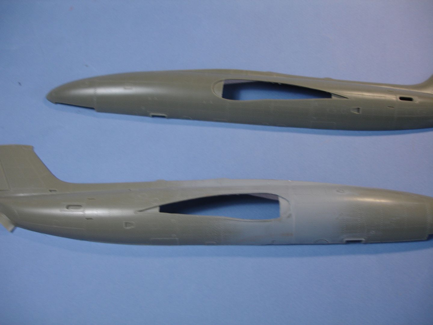

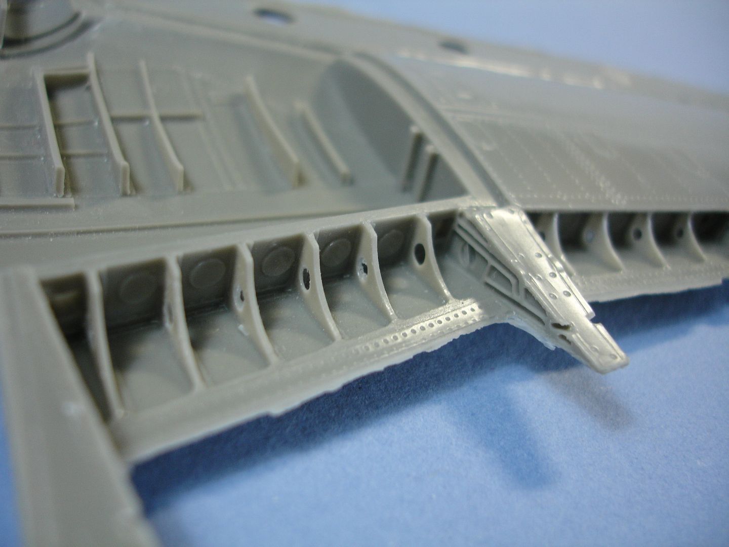

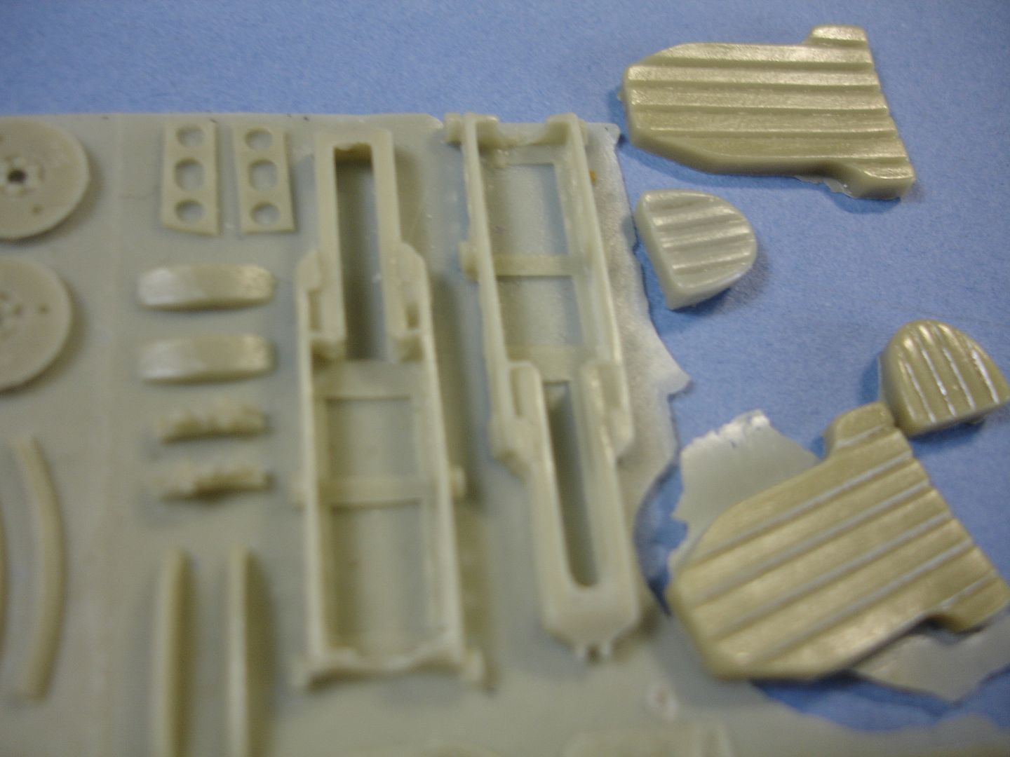

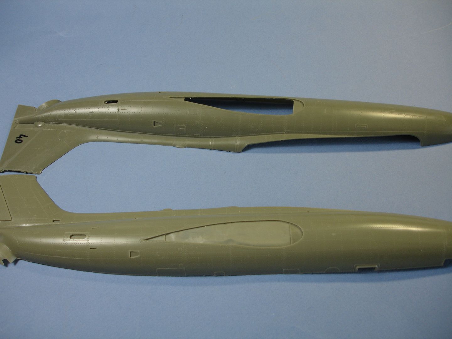

After finishing up the Me-109, I planned to start one of the kits I got for Christmas. The choice came down to the WNW Hannover Cl.II from my parents, or the HpH L-29 from my girlfriend. Both sounded like great builds, but the Delfin created too good of an opportunity to pass up.  I've wanted to build this one for a long time, and I'm excited

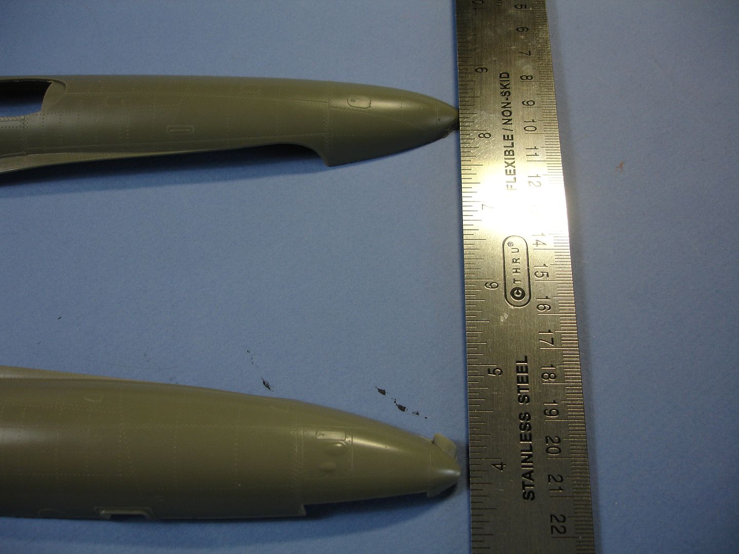

This first build will just be some starting pictures, the build will probably start later on this weekend.  There is one problem with the kit in that one fuselage half is 1.5mm shorter than the other one. So that has been cut and a plug added in to make it the same length.  After a ton of filling and sanding, it should be smooth. Then the beautiful detail will need to be put back on.

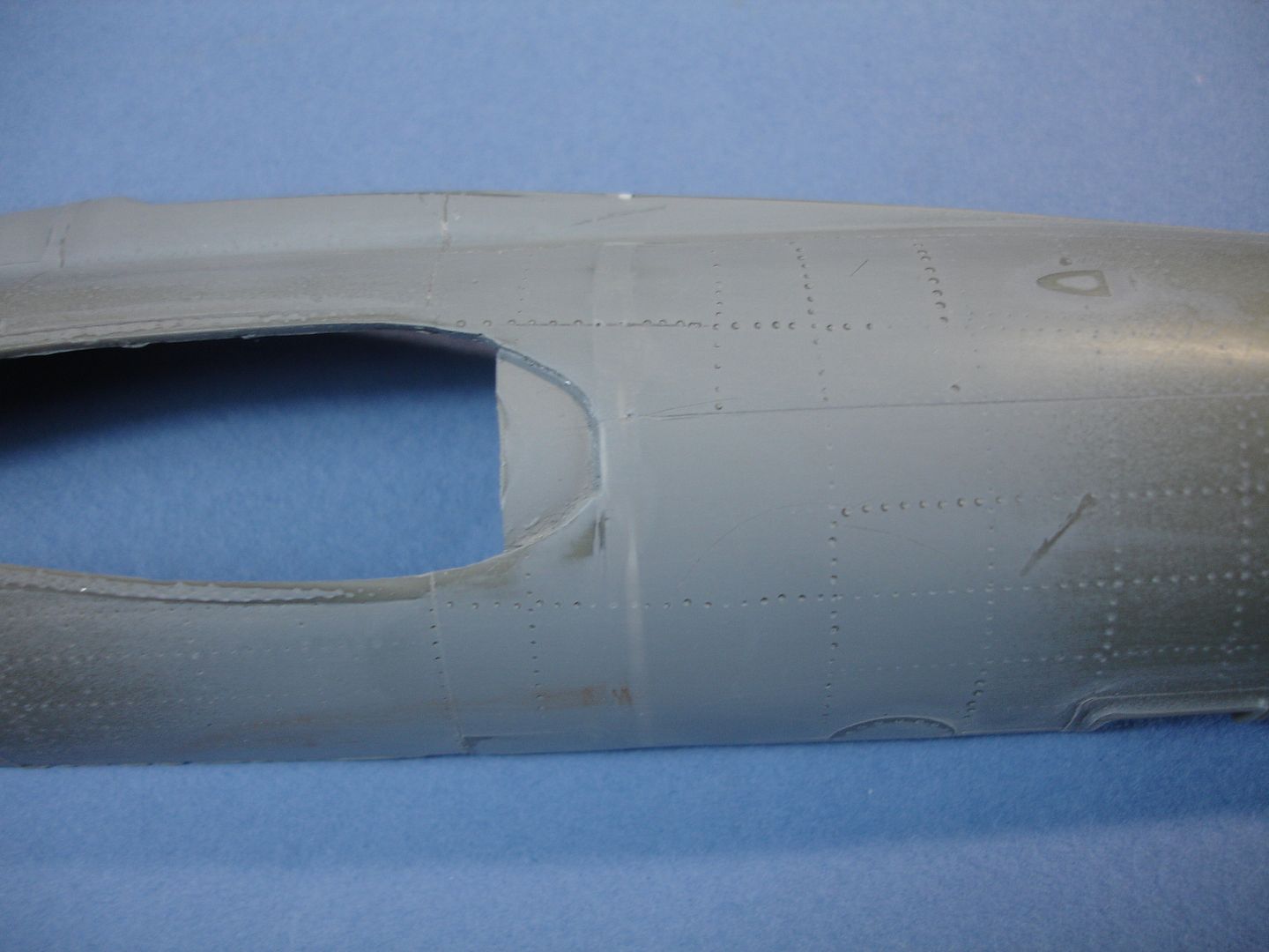

Posted

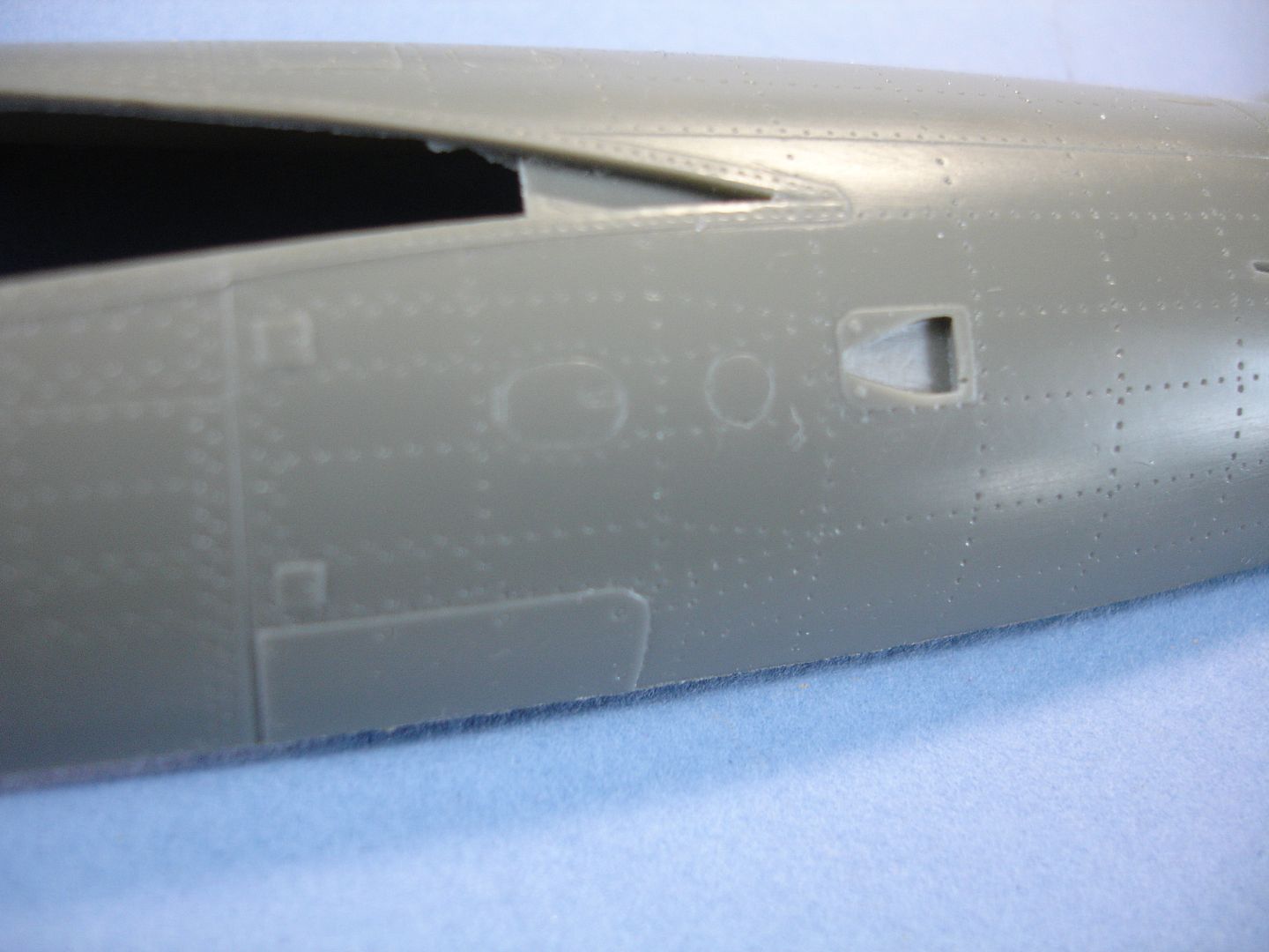

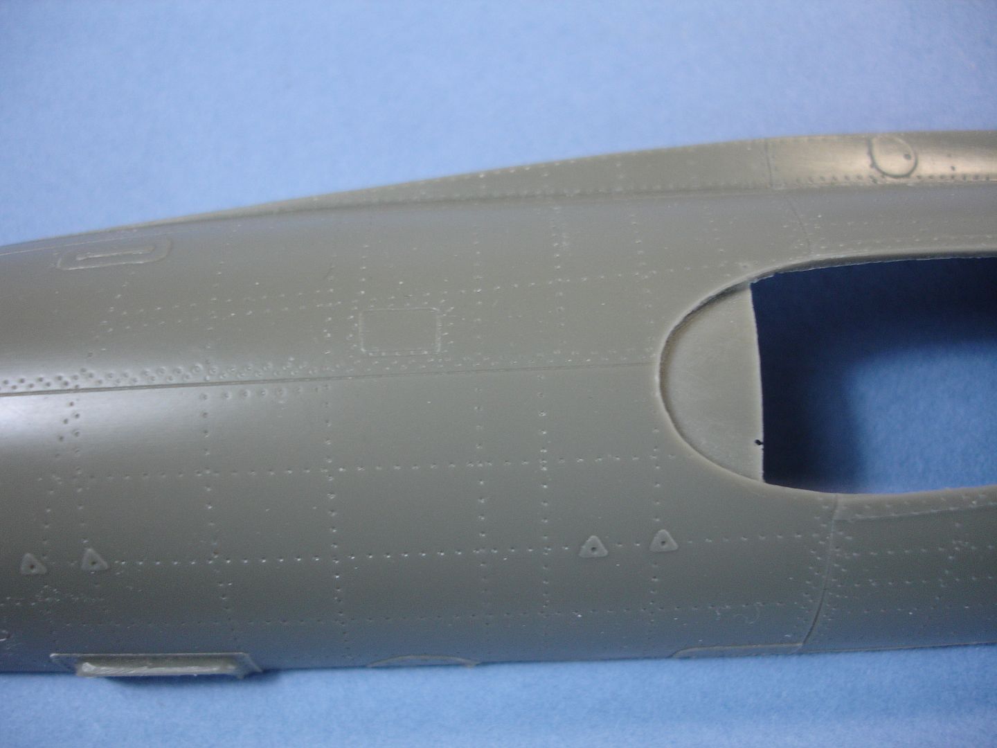

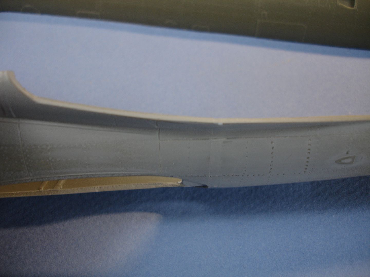

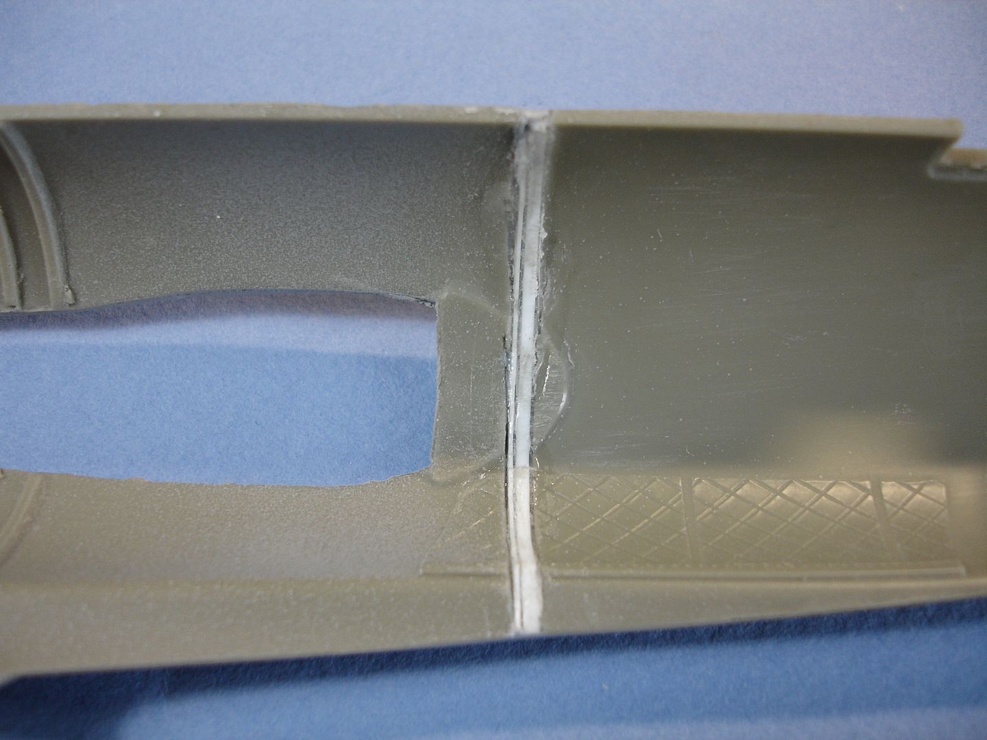

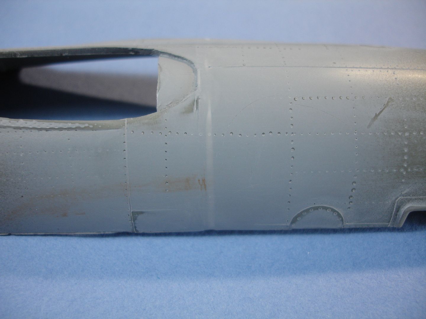

Got started with the stretch process on the right fuselage half.  Sliced it with my JLC ultra-fine saw and then added a plug from 1mm and .15mm styrene sheet.  Looks like the 1.3mm plug fixed the issue nicely.  Now I've spent the last three days trying to fill and sand it all smooth, and it is proving to be a challenge.  Since it will be NMF, it has to be glass smooth. And with the beautiful surface detail, trying to restore that will be a make or break on this repair.  Looks okay so far, but will need more filling and polishing.

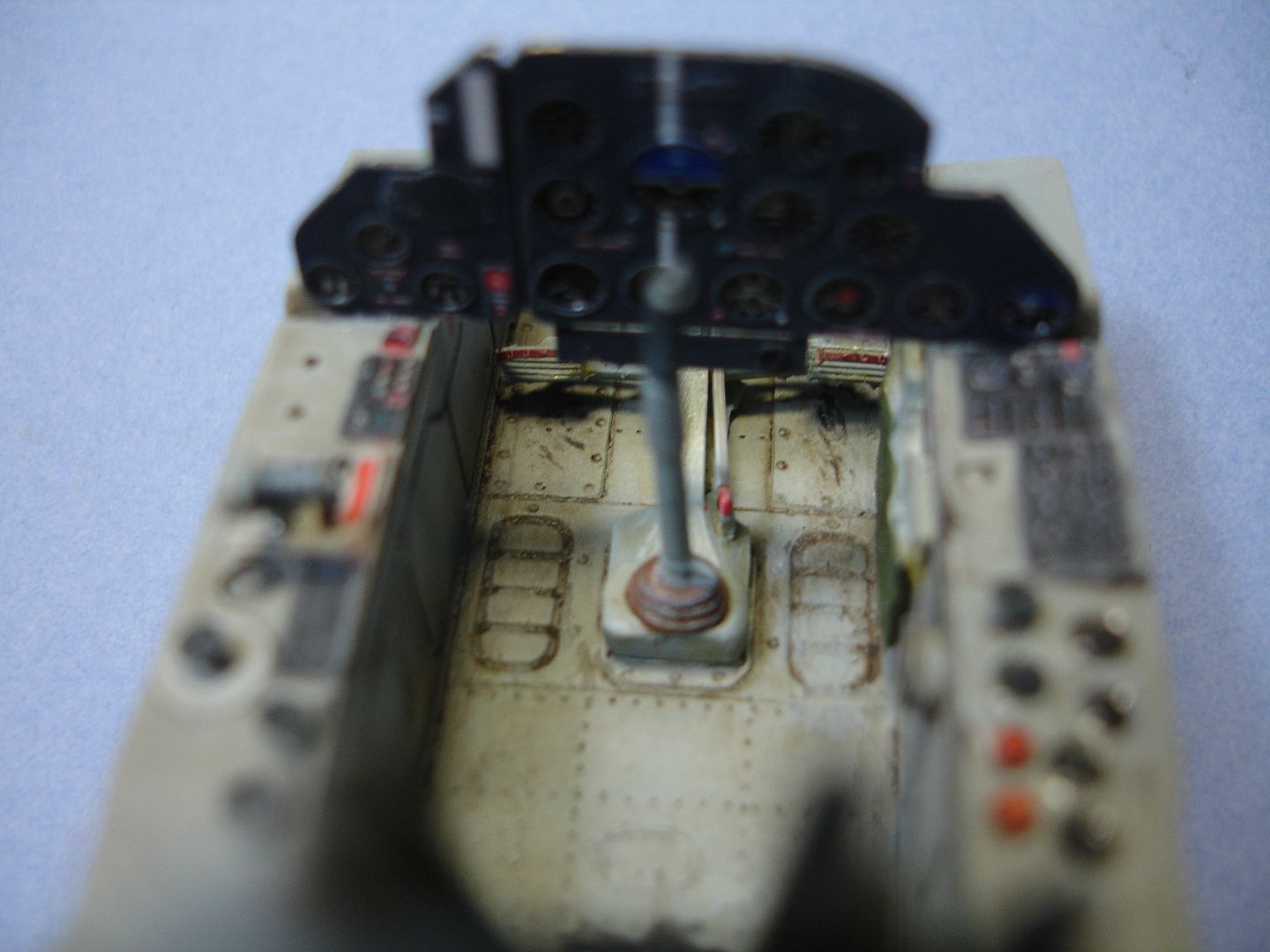

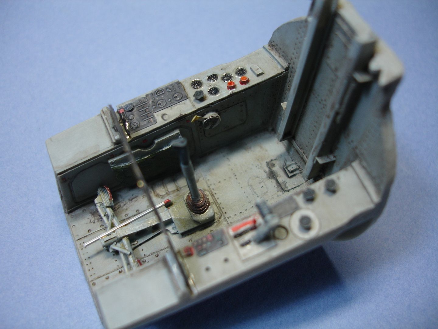

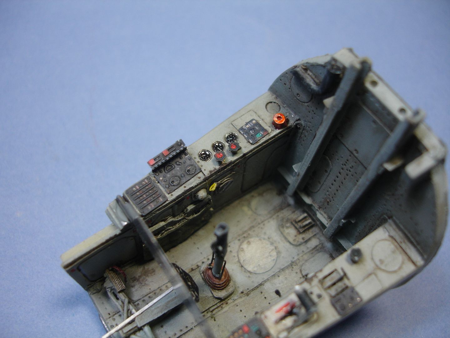

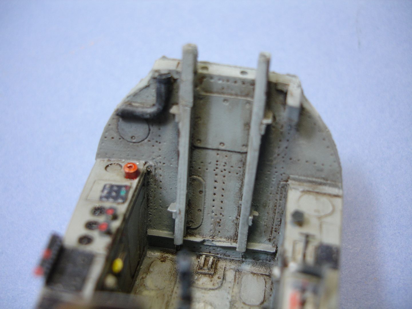

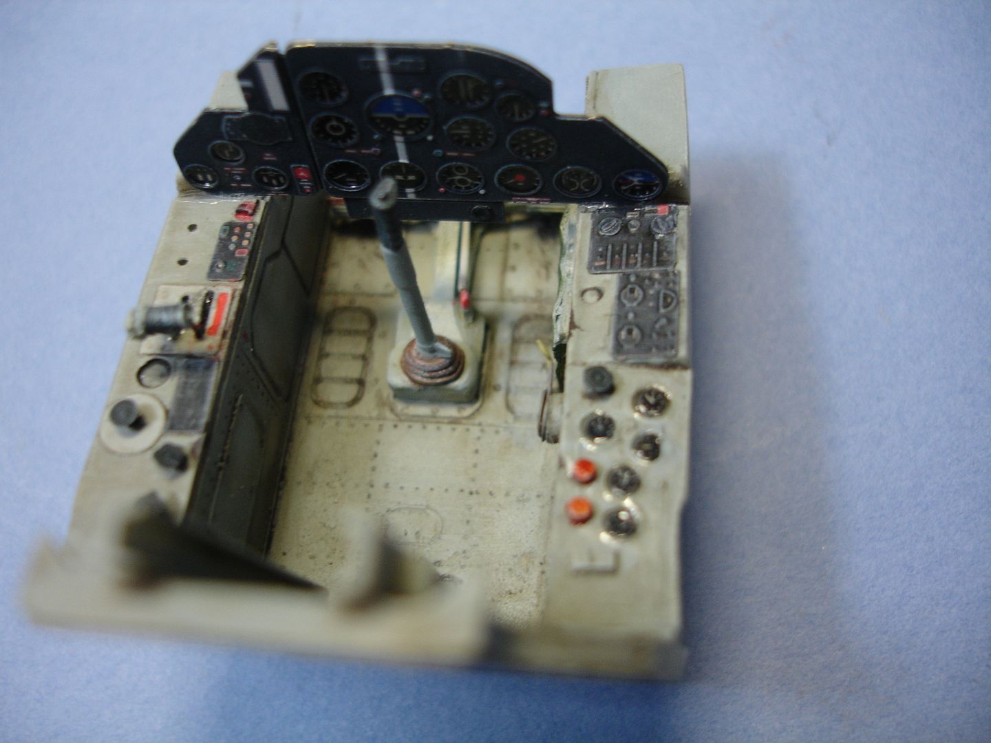

Posted

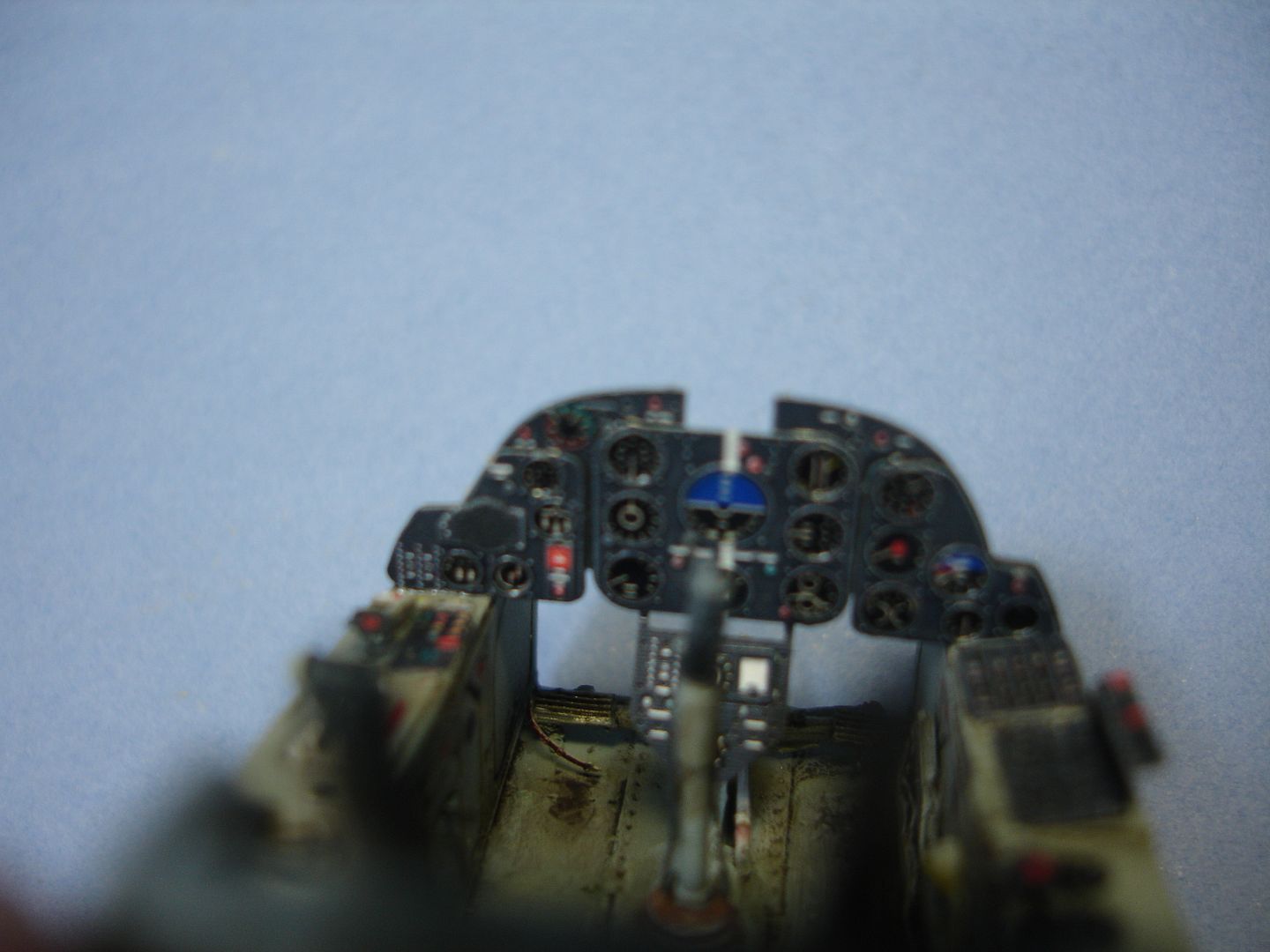

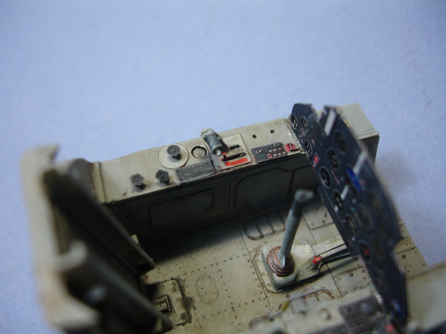

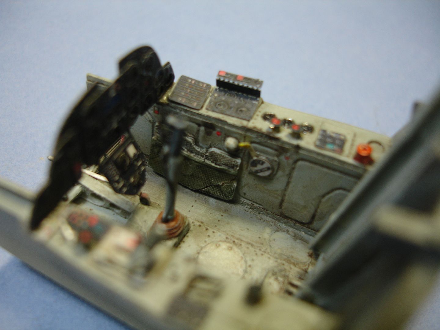

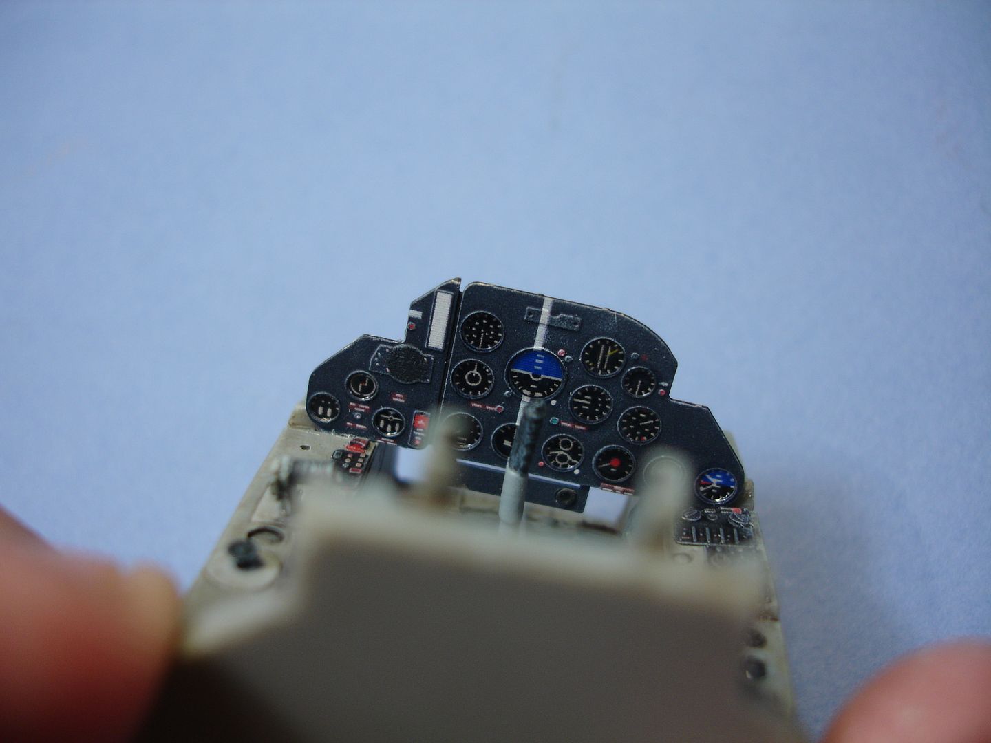

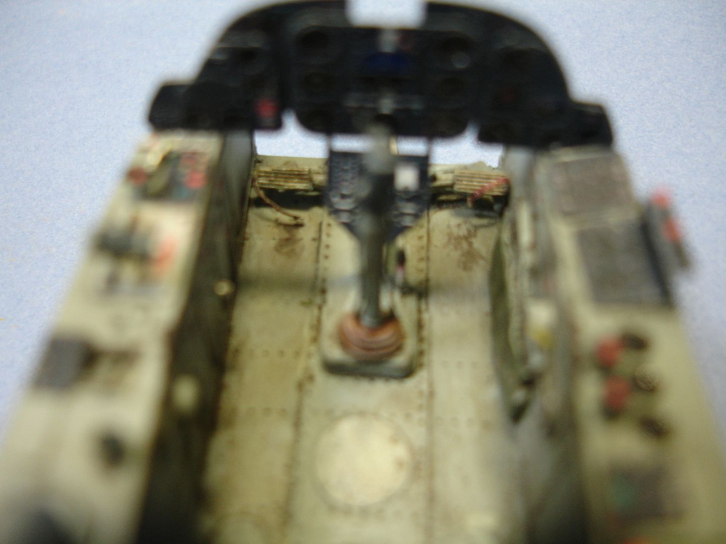

I've moved onto the cockpit assemblies on this kit, since Mirek and I are in talks about a fix for the short fuselage.   The cockpit assemblies are really great, as everything you could need is in the box or prescribed in the instructions.  I did find a great walk-around on ARC that showed every inch of the cockpits, and was really instrumental in helping me paint this.  Did also show a couple of tiny errors in the color instructions in the HpH instructions, but nothing that would change the model if you didn't do it.
