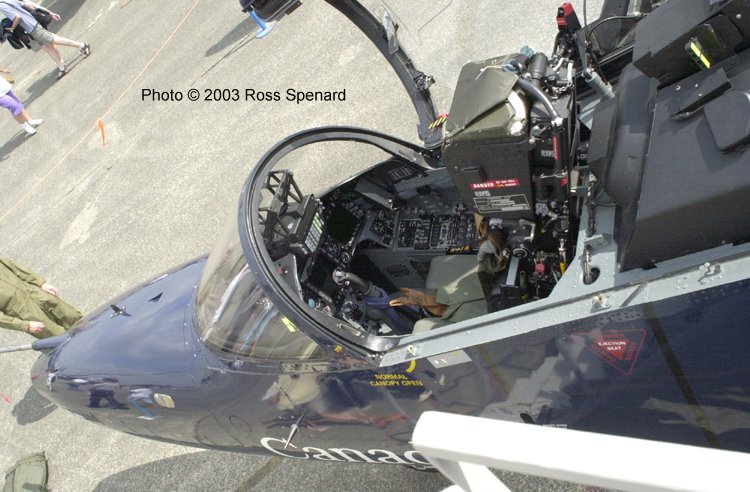

Derek B Posted February 5, 2013 Posted February 5, 2013 (edited) Hi Derek, I thought you might like this build. So far, the best bit of advice would be around the colours for the aircraft. The paint callouts are a bit sparse. Not as bad as the Dragon BF-110 kit where they're pretty much non existant but close. Also, the paint suggestions are all Vallejo numbers which has made it fun. Between using Vallejo's website and the LHS who stock Vallejo thankfully I wa able to figure out what most of the colours are. Annoyingly, Vallejo doesn't group/list their paint in numberical order which made it even more fun Here's where I am and hopefully, it's not too far off. The cockpit is straightforward and simply a tub with a pair of pedals front and back along with sticks and throttles. I painted the cockpit sky grey with black panels, clear green over the black for the MFD screens and a light drybrush: I checked beforehand and the coamings and bang seats can be fitted after the fuselage halves are together. So, would the seats use the same belt configuration as on the Hawk T1 (Revell kit)? I have a PE belt set for that kit and might use it if they are the same. Hi Carl, The seat should look similar to this: Link to CT-115 walk around: http://www.aircraftresourcecenter.com/awa01/401-500/awa459-CT-155-Spenard/00.shtm Although not a Hawk Mk.10 lightweight seat, the above does provide some useful colour references (numbers are for Humbrol paints). Another walk around link: http://www.vaq136.com/lacrosse2/hawk.html The Hawk cockpit, from memory, is dark Admiralty grey BS 381C (I will confirm this for you when I can check the aircraft build drawings tomorrow). Useful colour link for dark Admiralty grey here: http://www.e-paint.co.uk/Colour_alternatives.asp?cRange=BS%202660&cRef=BS%209-097&metallic2=False Canadian wings link: http://www.e-paint.co.uk/Colour_alternatives.asp?cRange=BS%202660&cRef=BS%209-097&metallic2=False Hopefully, that will help you for now. Cheers Derek Edited February 5, 2013 by Derek B Uncarina 1
BloorwestSiR Posted February 6, 2013 Author Posted February 6, 2013 Hi Derek, Thanks for posting the photos. Looks like my cockpit is a bit on the light side. Oh well, doesn't look off too much. I'll compare your pics to the PE belts and see how close those are before I make a decision. Found this photo over on the RCAF website and thought it was great: http://www.airforceimagery.forces.gc.ca/netpub/server.np?original=4666&site=casimages&catalog=casimages Nice formation but sadly I missed it even though they're only 45 mins away from where I live. Carl
