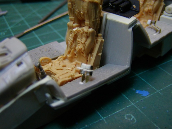

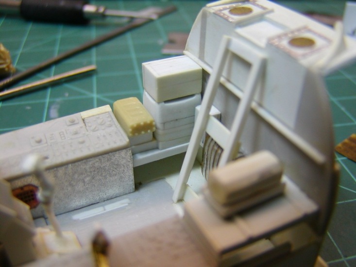

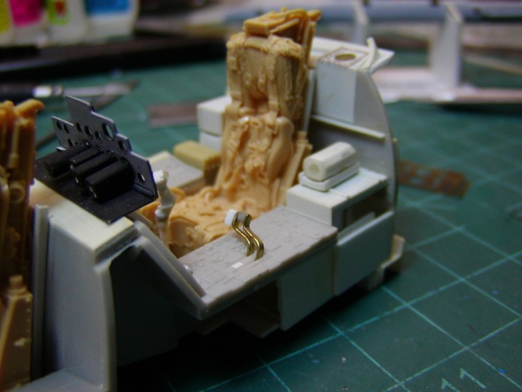

Barry Posted May 25, 2009 Posted May 25, 2009 (edited) I have not been happy with any after market Phantom Cockpit.I am not saying anyone's is bad just all have the same problem aft cockpit is too short.The main differences you will see are in the shelves on either side of the aft cockpit.All the current after market kits chop them off thus causing or allowing the rear bulkhead to be slanted to match the seat angle.For the most part the rear bulkhead is actually nearly vertical.I have been kit bashing/scratch building one on and off for "years".I am attempting to make it adaptive to both Tamiya and Revell kits.What you see here is fitted to the latest Revell F-4E kit.I have considered working with Harold to see how it would cast up.I would like your thoughts. Edited December 16, 2013 by Barry

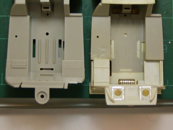

Barry Posted May 25, 2009 Author Posted May 25, 2009 Photo 6 Difference in length too Tamiya's cockpit.

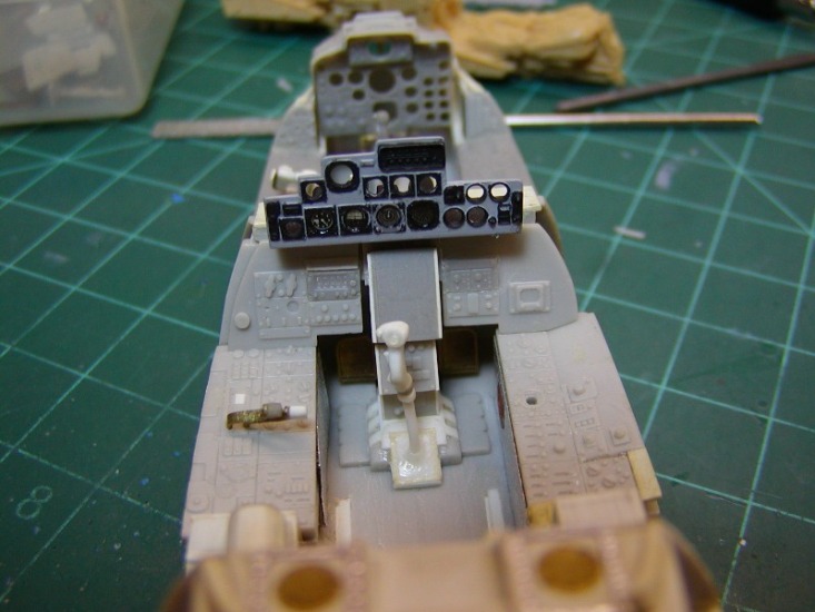

Barry Posted May 25, 2009 Author Posted May 25, 2009 Here is what I see as the most glaring error in Tamiya's cockpit. The Fwd Instrument Panel; it's too small causing the main instruments in the center of the panel to be too small. Revell's panel is much more accurate in size.
Harold Posted May 26, 2009 Posted May 26, 2009 Here is what I see as the most glaring error in Tamiya's cockpit.The Fwd Instrument Panel; it's too small causing the main instruments in the center of the panel to be too small. Revell's panel is much more accurate in size. Hi Barry, Do any of the AM resin have the IPs correct?

Barry Posted May 26, 2009 Author Posted May 26, 2009 Hi Barry,Do any of the AM resin have the IPs correct? The real answer is no. The Legend kit for the Revell F-4E comes closest but it's not. It has several other oddites that I am not sure where they got their references. Looks like a mis-mash of different details. The Revell kit panel scales out closest to the actual panel. Barry
