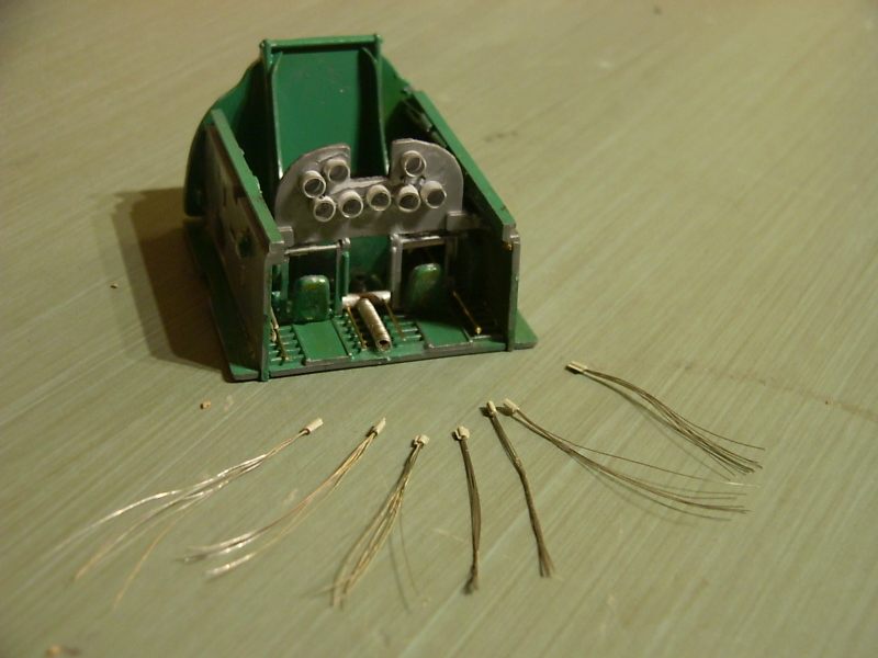

Chris/Germany Posted March 30, 2004 Posted March 30, 2004 Ok, one more box opened, starts as usual with the pit, out of the box, adding a little wiring, instruments are selfmade from small rings of brass-wire, glued on to the panel ( after sanding it down), painted them black, then instruments hand-painted with a 5/0 brush, then filled with a drop of gloss-laquer
Chris/Germany Posted March 30, 2004 Author Posted March 30, 2004 Not to forget the cylinders of the instruments that can be seen on the back of the instrument panel! They are small pieces cut from a aluminium-tube ( 2,4 mm inner diameter) an glued on to their place, they will be filled with 2-component glue and the wiring, made from tiny electronic cables where the plastic cover was removed, will be inserted.

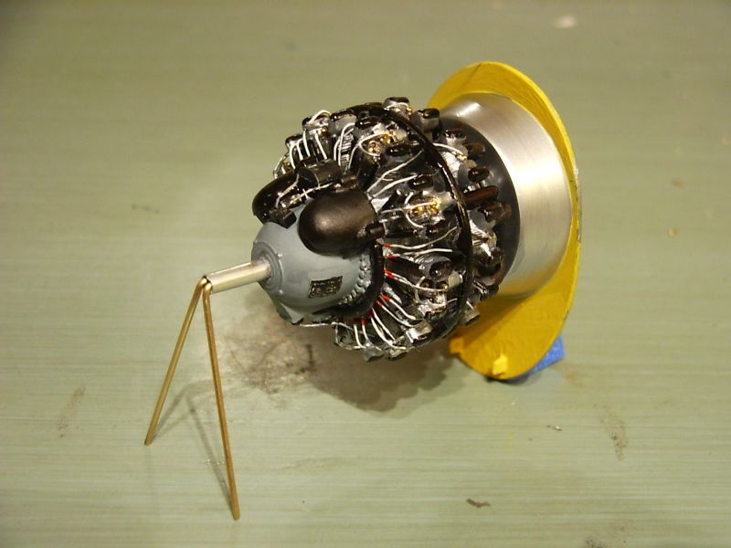

Chris/Germany Posted March 31, 2004 Author Posted March 31, 2004 started motor detailing today: glued the cylinder-halfs together, sanded down the molded wiring very carefully without ruining the cylinders itself, drilled wholes where the spark-plugs are mounted and inserted small pieces of brass-tube. These tubes make it very easy to insert the final wiring from alu or brass wire
Chris/Germany Posted April 1, 2004 Author Posted April 1, 2004 elktro-motor also installed, no problem in a Jug, enough space left. for those who want to know: I normally use motors from scrapped Disk-players or computer harddisks: good rpm ( 5000/7000), don't need much voltage ( 1,5 Volt is enough and turns down the rpm a bit ) and have enough power to turn even a big-prop.
