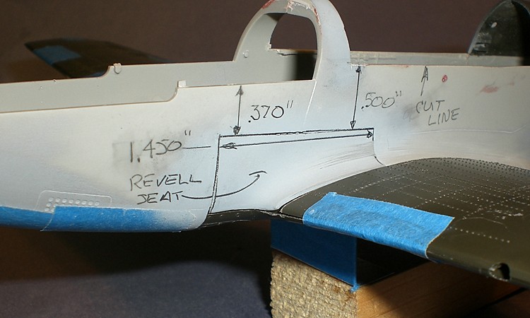

Ironwing Posted September 20, 2008 Author Posted September 20, 2008 Greetings All, Ive been splitting my time between the B and the D. I thought I would post some progress pics ... As shown in the pic, the forward section of the Revell fuselage wing root was removed from the Revell kit and installed in the Hasegawa fuselage using the dimensions shown. The ensuing fit, while not perfect, is plenty close enough to make repair quite easy. I used the curve in the wing fillet as the primary alignment point to eliminate the need to repair/replace the curve. The splice was also done with the wing clamped/taped in place to ensure a good close fit. I think it worked out pretty well and overcomes the need rework the LE of the Hasegawa wing which IMO, would be really really hard because of the way its shaped. Doing it this way does away with all of that and puts the proper size ELE in place.

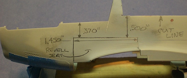

Ironwing Posted September 20, 2008 Author Posted September 20, 2008 The aft cut out to fit the Revell wing into the Hasegawa fuselage is very straight forward. Just make the cutout look like the cut out in the Hasegawa wing
Ironwing Posted September 20, 2008 Author Posted September 20, 2008 Looking at the wing root LE. Not much of a gap to fill and the ELE is already corrected with no other surgery needed. There might be a better way to do this. This method however, IMO, seemed to fill all the requirements with the least amount of fuss. The next effort will go into rebuilding the wing... for you fans of Montey Python.."and now for somethying completely different" Ill be back. Hope everyone is well, Regards, Geoff

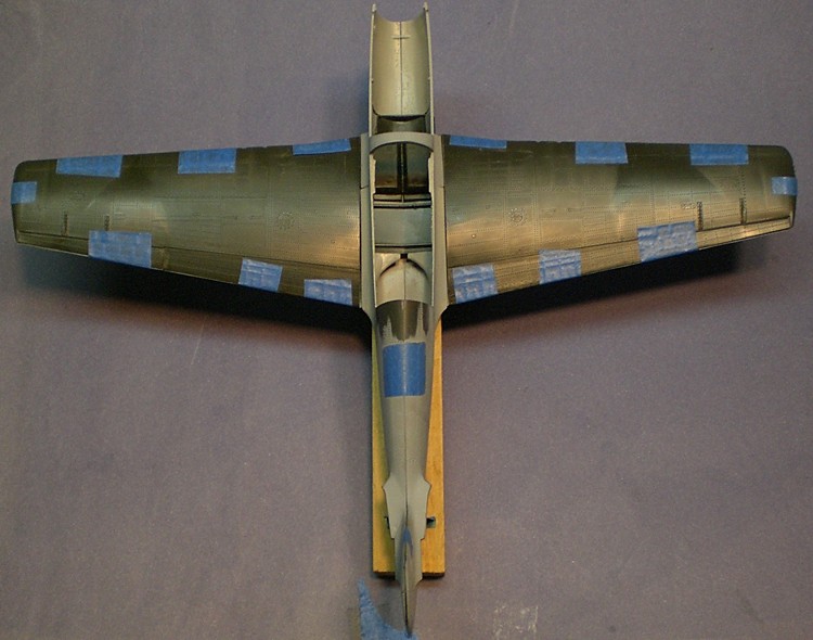

Ironwing Posted September 20, 2008 Author Posted September 20, 2008 forgot this one...Its amazing how close the two wings really are to each other.

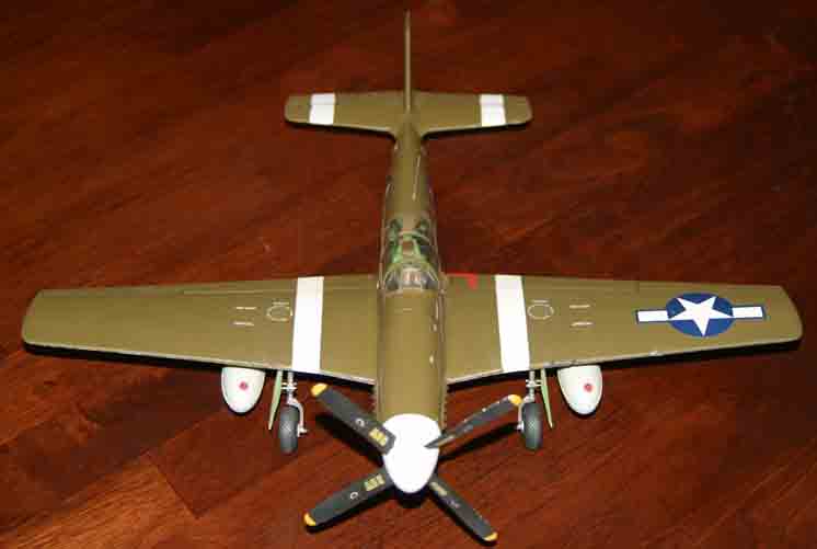

fastzx Posted September 20, 2008 Posted September 20, 2008 Excellent work very nice to see this approach - very different from mine. You are going to attack the Revell wheel wells right? After all the other work you are doing it just makes sense if I missed something I apologize about mentioning the wheel wells. Found a Pic of the other mustang chop job the "Shangri-La" is on hold right now after converting the "Ding-Hao!" This one is a little more complicated. This state shows it before the exhaust shrouds were removed for the Moskit un-shrouded exhaust....AND I just found that here is a new release of the Shangri-La decals!!!! - This one has the Monogram F-51D nose to be grafted while the Ding-Hao! has the Hasegawa nose. I will get back to this after I finish two or three other builds in progress - one thing that stopped me was the God awful red painted wheels for Gentile's plane. Jon
fastzx Posted September 20, 2008 Posted September 20, 2008 More encouragement Geoff Here is the Hase/Revell Ding-Hao! top view much better looking nose than revell puny/pointy thing. This looks more like a b model to me too. The nose really defines the "look" Keep up the great work I can't wait to see your conversion approach. Jon
