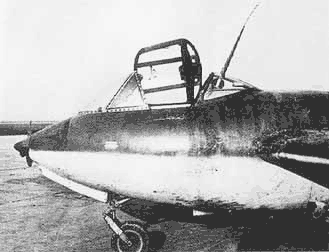

mattlow Posted February 15, 2008 Author Posted February 15, 2008 Thanks for the encouraging words. James - this is the old ID Models vacform - kindly given to me by Iain over at 32nd SIG. All I shall be using from the kit is the fuselage halves. Wings and possibly tail will come from a donor Me 163 kit. All else has to be scratched. Does look like it used Me 262 mainwheels and tires. One prototype was completed and flown (allegedly not under rocket power). Parts of others found in closing weeks of war. This will be the V-1. Matt
mattlow Posted February 17, 2008 Author Posted February 17, 2008 Hi all Camera batteries charging so just some words and a side view. So far fuselage halves removed from sheet. Arthur Bentley's excellent plans have been scaled to 1/32 using some measurements found on a factory drawing. Fuselage slightly too long so 4mm section cut out in front of wing. Made up a couple of bulkheads and starting work on the Hasegawa 163 wings (163 wings used as on the real aircraft). Mainwheels appear to be Me 262 size and it makes sense that already in production parts would be fully utilised. Nose wheel/tire are same diameter as the tailwheel of the Me 110. Profile below is of a production a/c (none known to have been produced) which differs from the V-1 in having gear doors - the V-1's u/c was locked down for test flights and featured closed and faired gear doors. Will try to get some pics up tomorrow.
