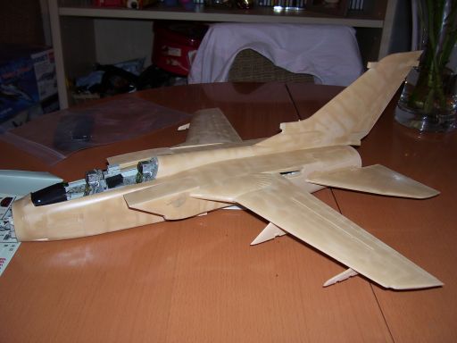

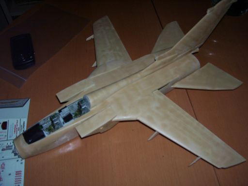

Ian Aylmer Posted October 26, 2007 Author Posted October 26, 2007 Hi all, I am on with the paint job to the fusealge. I took these pictures whilst it was still a bit wet, so It isn't actually all that dark. I mixed four colours in varying amounts to come up with the base colour of salmony deserty colour than darkened it a little to start adding that worn filthy look. Hopefully I pull it off??? I am going to let this dry for a couple of hours then go and see what it looks like. I think then I will seal it and start panel lines etc. Thanks for looking guys. Ian
DaveJ Posted October 27, 2007 Posted October 27, 2007 I hope it keeps that sorta splotchy look when dry, it's just right for the sun-beaten look! But please keep in mind, you should add your decals first before panel lines. Paint, gloss coat, decals, gloss again and then weathering. This will help the decals look like they're painted-on because you can accentuate the panel lines over the markings as well. You're really trucking right along on this one! Nicely done.....

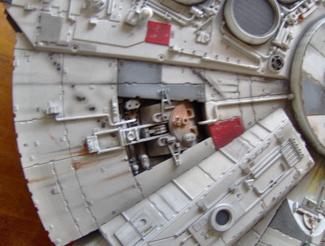

savvy Posted October 28, 2007 Posted October 28, 2007 Hi Ian, You could give pastels a go for your weathering, this is my FM Falcon all done with pastel. Sav

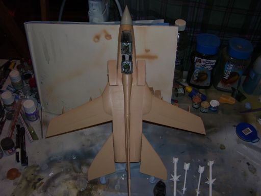

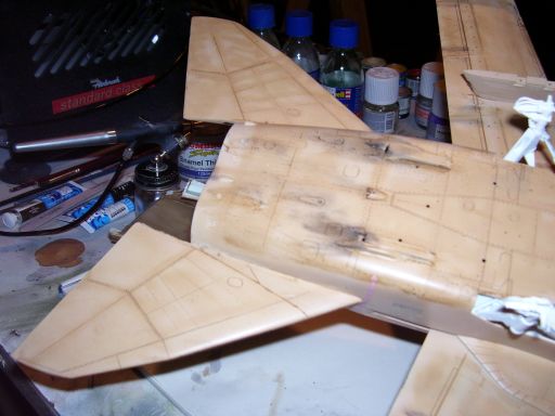

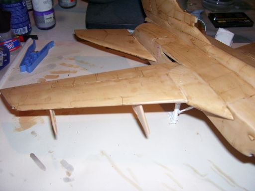

Ian Aylmer Posted October 28, 2007 Author Posted October 28, 2007 Hi all, Some of the progress of my Tornado. I have been applying dirt in general, and also doing panel lines. As this is my second model ever doing this technique I got the jitters just before starting, but carried on anyway. I think it looks pretty good so far. I now need to do the same to the bottom and then seal it all in. Then I can continue with the build. Hope you agree? Thanks Ian
Ian Aylmer Posted October 28, 2007 Author Posted October 28, 2007 Hi all, A couple more shots at the same stage of painting. I can't wait to get a matt coat on it! I am going to be using pastels after sealing this lot in to add more of a dirt feel to it. I have to do the exhaust stains on the tail too. Thanks for looking guys. Ian

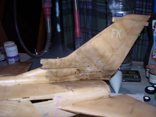

Ian Aylmer Posted October 29, 2007 Author Posted October 29, 2007 Hi all, More progress shots. I have added the huge exhaust stain to the tail. I can see where I will need to soften it now I have seen the photo. This is no problem. I used a mix of dark grey and brown pastels to get an exhaust colour. I have also weathered the bottom of the aircraft. For this I used artist water colours. I used solely brown for this. I mixed in a little washing up liquid as the paint wouldn't stick to the gloss coat. Worked a treat. There were more available panel lines on the bottom than there were on the top. This is amusing as how often do you turn over the model, or even display it upsaide down? I think this is because of the faintness with which the factory puts them on. So for my next trick I will have to learn how to scribe. Marvelous. I am enjoying the heck out of this kit, as I think I am beginning to learn and use more of the methods that I see used here everyday on this site. Brilliant! Its great to see truely inspiring work by others and then learn how it is done and apply it. One step closer. Thanks Ian

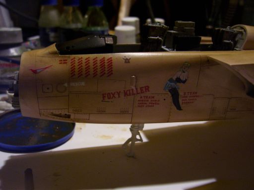

Ian Aylmer Posted October 29, 2007 Author Posted October 29, 2007 Hi all, Some more gratuitous shots of my Tonka! I can't take a decent shot of the front of this bird to save my life!!! Maybe the camera is cursed? Also, now I see where I have misplaced the rescue decal at the front. Grrrrrrr. :angry: Thanks Ian
Ian Aylmer Posted October 29, 2007 Author Posted October 29, 2007 Hi all, And finally, the tail. How to get that swirly exhaust note??? Thanks Ian
