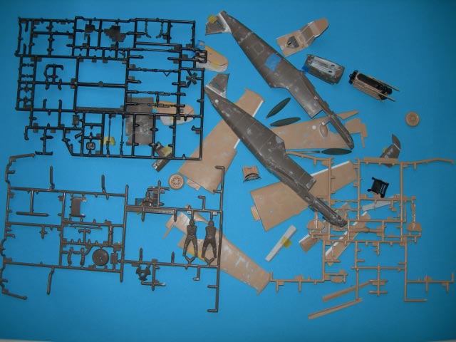

Hans Posted August 25, 2010 Posted August 25, 2010 (edited) Well another group build, another chance to get it finished. This is the kit I entered in the clear the bench group build, but lacking the inspiration I didn't do any work on it. The Aires set I had bought to replace the Matchbox pit didn't fit in so the only option was scratchbuilding, using the kit parts and parts of the old Eduard set for the Hasegawa 109E. These are the parts of the kit at this moment. As told in the other thread I already have rescribed the panel lines, cut loose the control surfaces and built the engine. Edited January 16, 2011 by Hans

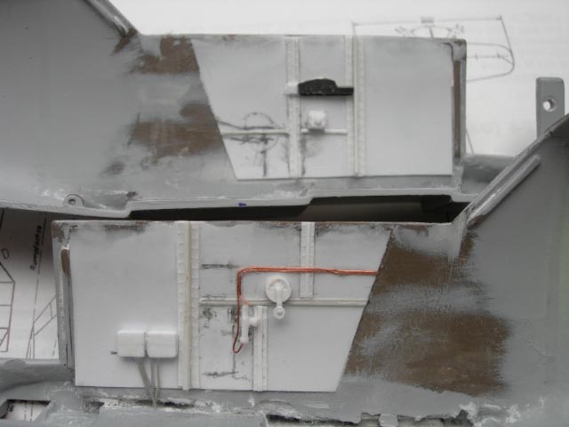

Hans Posted August 25, 2010 Author Posted August 25, 2010 Last week at long last I made a new start with the cockpit. So far I have replaced the inaccurate Eduard side walls with plastic card and have made the stiffeners and ribs for the cockpit walls using photos and drawings of the real thing and the Aires cockpit set as a guide. I also made new rails for the seat and added some details to the floor. More to follow soon Hans

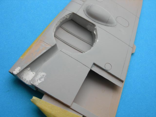

Hans Posted September 1, 2010 Author Posted September 1, 2010 I have also begun working on the wings. The wheel wells have been boxed in using plastic card and parts of the Cutting Edge resin replacements for the Hasegawa kit. I improved the look of the underwing cannon bulges by adding a strip of plastic around the edges and filling in and rescribing the panel lines The transition between the bulge and the plastic strips has been made more fluent using putty. The part of the well where the gear leg goes was taken from the Cutting Edge wheel well. Each well was cut in two pieces and the "leggy part" was modified to fit onto the Matchbox wing The other part was discarded as it didn't fit into the wheel well) (too small) and also proved to be too shallow.

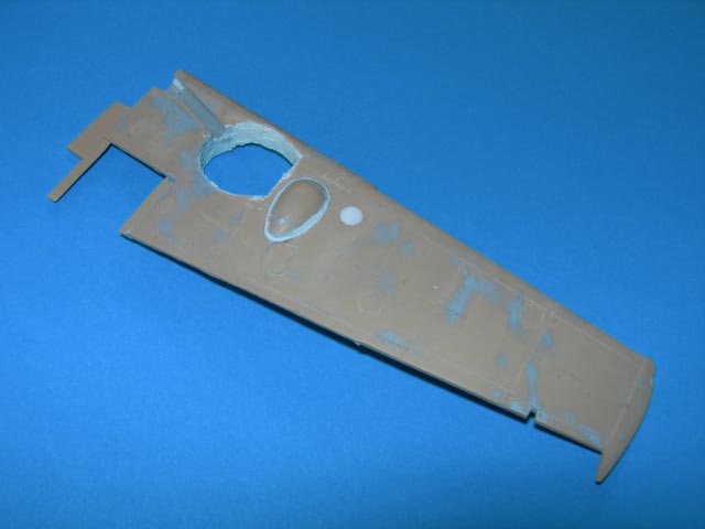

Hans Posted September 1, 2010 Author Posted September 1, 2010 The outside of the wing. That will be all for now. Thanks for looking. Hans

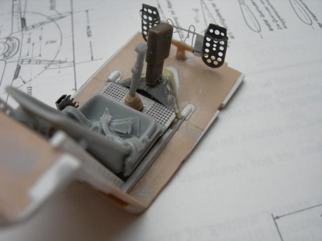

Hans Posted September 7, 2010 Author Posted September 7, 2010 Done a bit more work on the interior using kit parts, Eduard photoetch and scratchbuild parts. The seat is from Cutting Edge, the stick comes from a Hasegawa 190 kit.
rafju Posted September 7, 2010 Posted September 7, 2010 Hi Hans be careful with the stick, it looks like it is in the wrong direction ... raf
Hans Posted September 7, 2010 Author Posted September 7, 2010 Thanks, Rafju, I'll have a word with the mechanic Cheers, Hans
