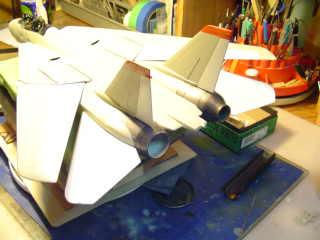

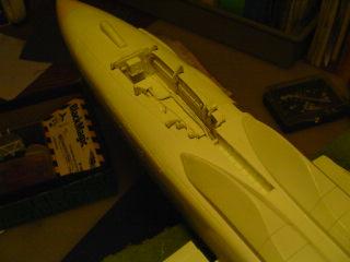

John B Posted October 1, 2008 Author Posted October 1, 2008 Here are some in progress shots. It's a start, I have the intakes on and the forward fuselage figured out. More pics to follow. I am going on vacation tomorrow for my father's 90th birthday in Bradenton Florida. Will be back at the bench next week. JB Luca 1

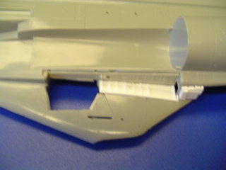

John B Posted October 10, 2008 Author Posted October 10, 2008 Here is some more work done I have opened the fan blade area so I can install them from the other side, it will make painting the inside of the intakes white easier and closer to the real thing. This is the front wheel bay from the Tamiya kit that will be used for the Revell kit. The center piece will still be required for the Tamiya Resin cockpit set. I put together a plastic-card base that will be used for the well whell roof with slots to accept the Tamiya well. Luca 1

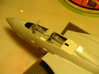

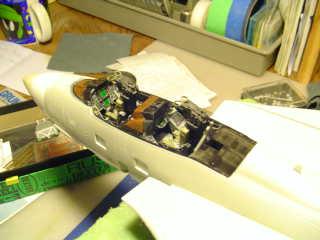

John B Posted October 11, 2008 Author Posted October 11, 2008 More cutting and thrashing the parts into submission. Tamiya cockpit parts being utilized for the forward- hood and after-hood. The Revell sections were removed. Miliput will help fare all parts in later. The after console is stock Revell part that has been cut into sections much like the Tamiya part. Got Waldron Punch?, you bet. Here is the forward well being checked for fit. I had to add plastic shims to make the well butt up under the cockpit floor for a tight fit. I just had to sand the surface of the Revell well area to accept the Tamiya parts. No Sweat! The area aft of the well will be extended so it can accept the hydraulic actuator for the forward gear later. That area will be cut out of the Revell fuselage and plastic card will be utilized to re-build it to match-up with the forward well. I hope I'm not rambling too much here. J.B. Luca 1

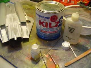

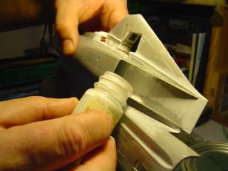

John B Posted January 4, 2009 Author Posted January 4, 2009 Well it has been awhile since I last posted. My free-time schedule for hobby stuff was cut way back due to work, Holidays and my father's passing. Here are some progress pics of what I have completed so far. The first pic is the intakes getting prep'd for the coating of Kilz / Denatured alcohol / water mix. I saw this method posted I think on ARC, it was a Dave Roof tip and I thought I would give it a go. It wokred okay, but I think due to the size of the intake, it took a lot of applications. Each application requires a little more time to dry before moving to the other intake. If you don't you will pour out the previously poured paint from the other intake. So it added up to a lot of time for drying. Luca 1

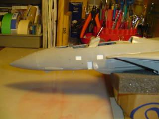

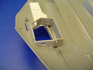

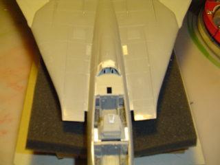

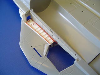

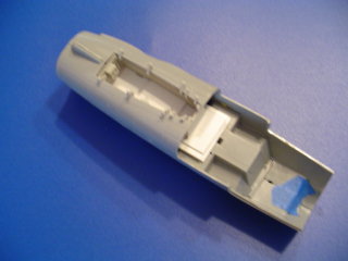

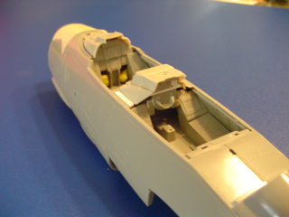

John B Posted January 4, 2009 Author Posted January 4, 2009 Greetings again, This picture shows the forward fuselage fared in with miliputt. I had to cut the height of the turtleback to get it to line up without a huge step between the aft fuselage joint. Here is a different angle showing the hinge attachment part from the Tamiya kit attached. It fit to the Revell fuselage with minimal adjustments made. Scratch-built forward wheel well, I wish my camera was more hi-tech It really is hard to show all the detail added with styrene and wire. Main wheel wells, widened, scratch-built, you can see the widened area aft of the well fared with the aft fuselage area. Again milliputt to the rescue. Forward fuselage with steps and boarding ladder cut out and boxed in. I am currently getting the landing gear, ejections seats detailed up and painted The fuselage, tails and the stabs are ready for the paint shop to apply the white for the VF-1 1974 paint scheme. I will be using Cam decals. I will try to get more pictures up in the near future. Thanks for all comments. John B Luca 1
