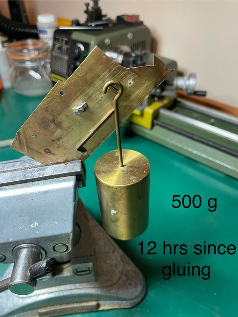

Paulpk Posted December 2, 2023 Posted December 2, 2023 (edited) For brass to brass, I did a number of tests a while ago and found Permatex Steel Weld 84109 had my best results. My first test with it failed but luckily I did additional tests and was extremely impressed. It is not as fast as soldering, actually a slow process but very strong once cured. 5 minute working time, 10 minute setup, 24 hr full cure according to the instructions. Edited December 2, 2023 by Paulpk Adding images
