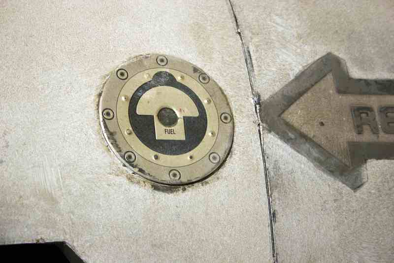

I was all set to either do the same or hit the hobby shop to see if I could find a race car photo etch set with something close but then I found this promo pic from the first season, and saw a few screen caps that show it in the first season.
So.... I was off on the hunt and this is what I found;
The kit very accurately depicts the CGI Viper
As far as I know the CGI version was unchanged throughout the run of the series except for fuselage numbers.
The full size prop was painted and detailed very close to the CGI Viper for the pilot.
The fuel point was just a decal as per whats in the kit, but changed either at the start of, or mid way through season 2.

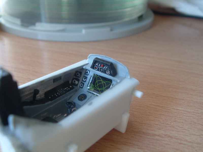

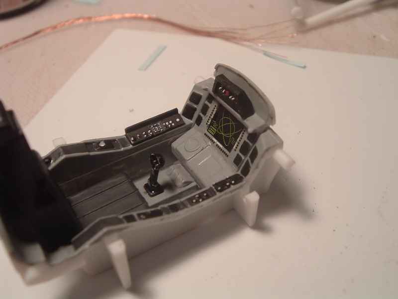

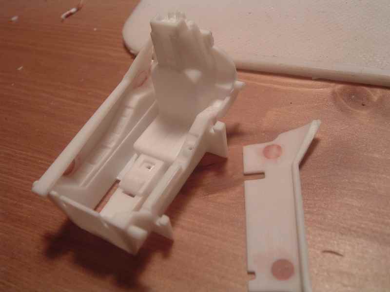

The cockpit is interesting. It is accurate to the CGI version but needs help to do the prop version. Moebius molded the outer sidewalls separate and of course put two ejector pin marks on the side that's visible....
The upper console needs to have the area molded for the CGI scope opened for the gauges and switches on the prop version.
The pilot is molded in resin (result of a mix up in communication between Moebius and the manufacturer) and is very nice, however you only get the faceplate not a face and while the figure is holding the stick you can see it's a bit high....
Posted

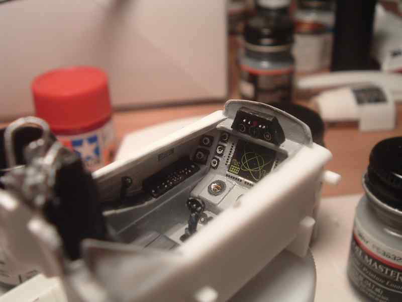

Overall interior color was dark ghost gray, panels in flat black and armrest area in engine gray I added the keypad on the left panel by nipping off tiny squares of sheet and gluing them in.
The upper console was filed open and a shaped lower section cut from sheet and glued in. The red warning light in the top center was a bit of sprue cut and glued in. The switches were stretched sprue carefully glued into position. The gauges were robbed from another kit.

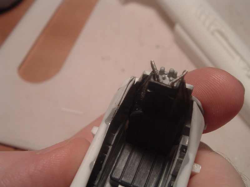

The seat has two hoses at the top, there are holes for them but the hose is not provided. I made mine by again wrapping fine wire around a larger one and gluing them in with super glue.

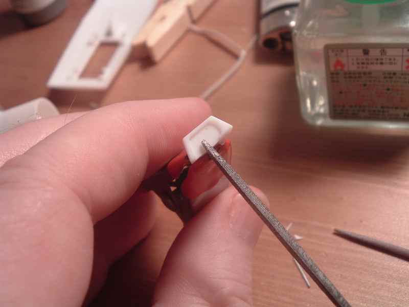

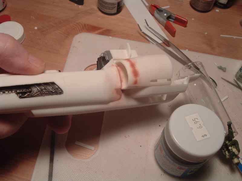

The worst problem I found was the rear corners where the sides of the panels do not meet the seat edges and the upper rear corners don't come close to the fuselage edge.
I used bits of scrap sheet to build up and fill the gaps. I added more to thicken the top edge as it would be needed to be filed back.
I positioned the cockpit and marked the upper edge with a pencil as a guide to how much to remove.

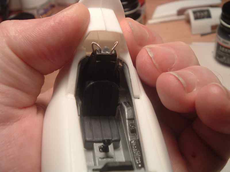

Posted
Once both sides were done it looks MUCH better.
The decals are ok but are not accurate to the gauges used in the prop. If you want them to be accurate you are going to have to get aftermarket ones. Also, the decals do not respond to setting solution very well (I had a hard time with getting the main screen to tuck in at the corners) and the carrier film is a bit thick.
It does build up nice though and looks good.

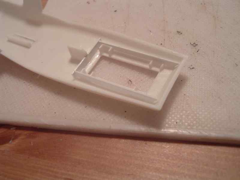

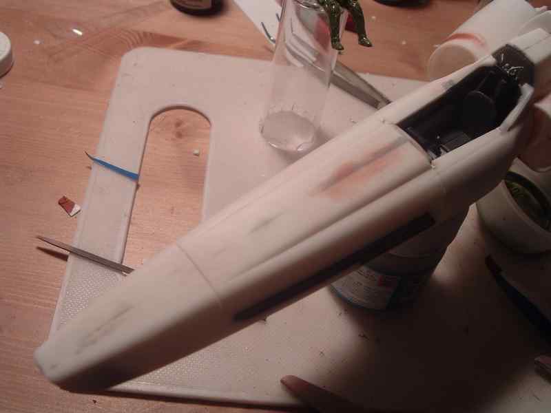

Time to get out the glue and putty. The intake grill fits into an angled slot and locked in place when the two sides are put together. I painted it with MM chrome and Tamiya flat black.
In gluing the hull together I found I had to clamp the top turtle deck just behind the cockpit but other than that there was no problem. I filled the slot in the belly plate as this one will be on her gear.
I boxed in the nose bay with a bit of sheet, it goes against my grain to be able to see gaps into the interior of a model.
Posted

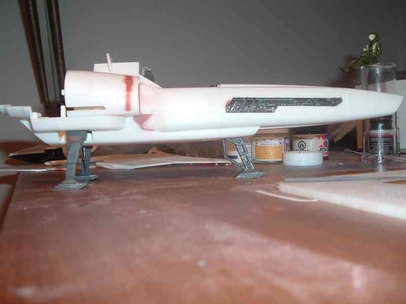

After I got the fuselage together I couldn't help myself... the rear fuse is like a jigsaw puzzle and holds together without glue so I fitted everything together... D*** it looks good !
The fitting of the rear sections brings up a bit of a problem. It has to be built in sequence or it's very difficult to get it together. The intakes go first, then the wings followed by the base plate which helps set the angle of the wings as well the vertical pillars lock the wings in place.
The problem was that in fitting the intakes and belly plate I found the seam at the front of the intakes would need filling. As well there was a 'step' between the belly plate and fuselage that would need filling as well... trying to do this with the wings in place would be a royal pain. I verified that I could squeeze the wings past the vertical posts and get them positioned ok, then glued the intakes and belly plate on.
Posted
Filling and sanding.... the upper joins are not too bad.
The bottom has some sink marks and a bit of miss alignment but a bit of putty and Mr. Surfacer fixed it up quick.
The biggest pain was these seams, the intake ones cleaned up easy, the 'step' under the intake took a bit more work but all the filling and sanding only took an hour or so to clean up.
The intakes have a bit of a sink mark where the 'intake fans' meet the outer skin. Again, very easy to fill and clean up.

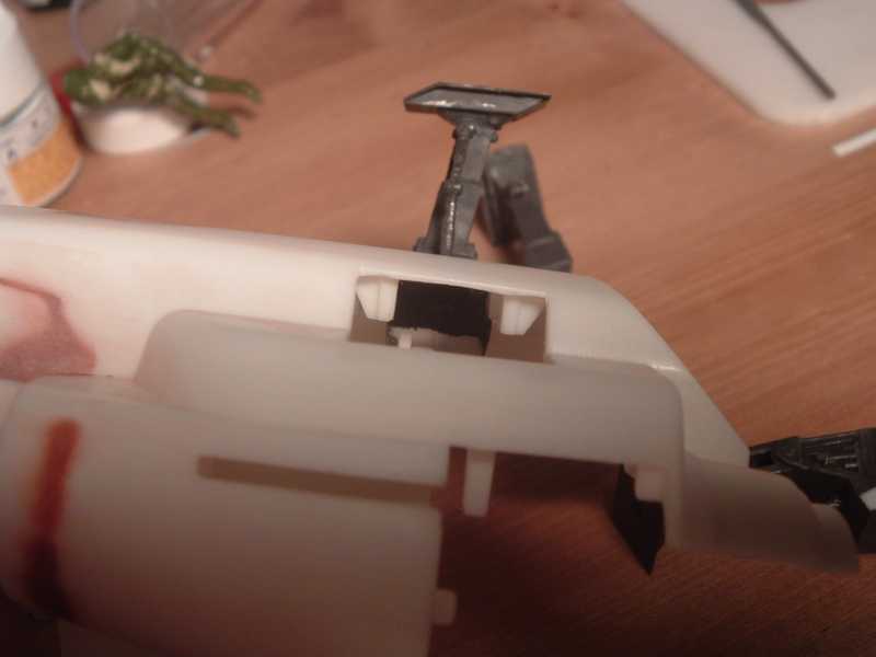

With the belly plate on, next thing was to fit the gear and see how she looks. Not bad but there was a problem with the mains.
The plastic of the gear opening is rather thick and holds the gear up off the mounting pins.
Shave the plastic down about half way and everything fits. The raised tab on the top of the gear leg glues to the wall on the rear of the fuselage helping to support and position thing correctly.
