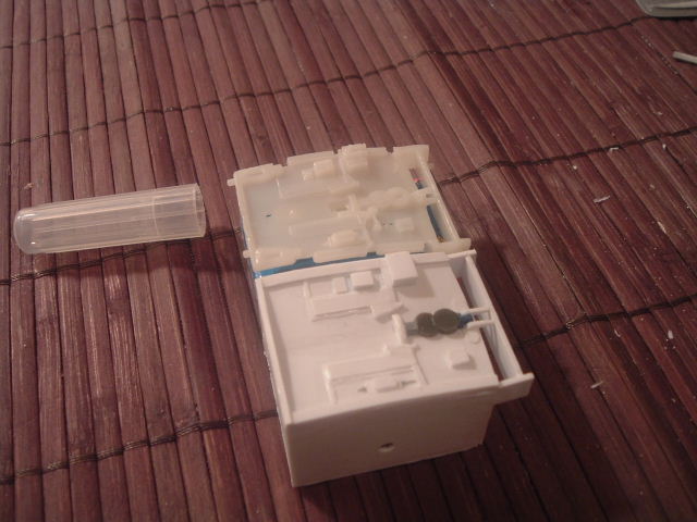

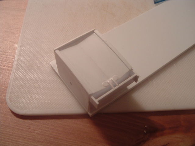

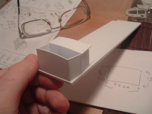

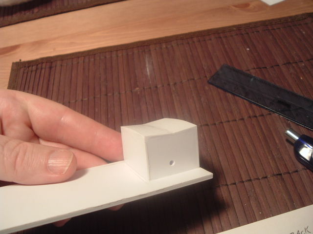

spacewolf Posted October 31, 2009 Author Posted October 31, 2009 When I heard that the cockpit on this kit was no good I decided to try copying the one out of the 21st C. kit and I got the bottom of the cockpit/top of the wing pretty much built. The Doyusha 'pit is good enough that I can fix/ build on whats there but I think I might add the floor I built. I started out by building a box that would give me the curves and angles to build the top of the wing where the two wings join. Two sheets of plastic were glued on and the center seam blended. Detail was then copied from the 21st C. kit using strip, rod, streched spru and discs cut from large scale spru.

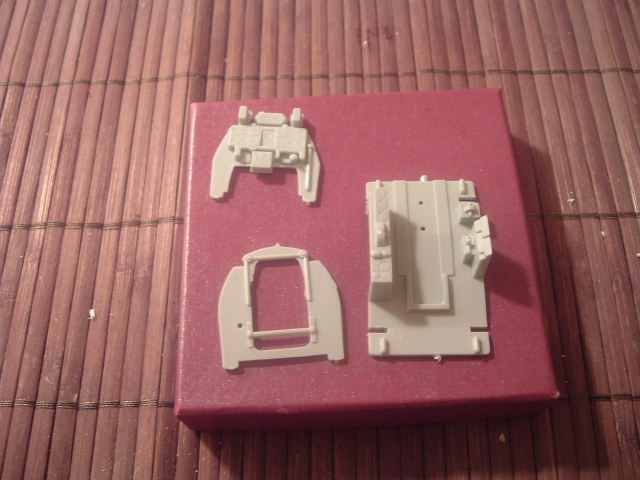

spacewolf Posted October 31, 2009 Author Posted October 31, 2009 Here is the kit cockpit. The insturment panel isn't bad at all and the kit gives you decals for the panel. The right side console is pretty good and this item is missing on the 21st C. kit. The bungie cord for the seat is well rendered... other than the floor this kit cockpit can be used with some scratch building.
