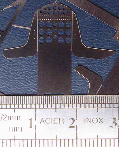

Guest canuck63 Posted September 7, 2008 Posted September 7, 2008 I can't be of help as far as the cowling is concerned because the kit I own depicts an early machine!If you think it could be of help I'd compare the wings and fuse to the ones of an un-built 1/48 Zero. Cheers Manny
Loic Posted September 7, 2008 Author Posted September 7, 2008 Hi Manny, thank you so much my friend, you actually have no idea how helpfull this is to me It does answer so many questins I had like was the cockpit built on the top of the wing like a Zeke or a P40, etc... This is the most detailled info I managed to get on this area of the bird. As far as the external dimensions and shape are concerned, I think I had managed to collect enough info but if it happen I need some checking out, I will drop you a PM. Thanks again very much! Cheers, Loic

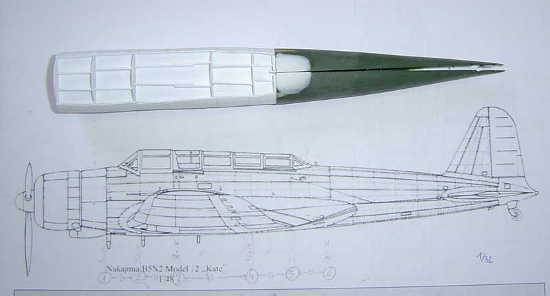

Loic Posted September 7, 2008 Author Posted September 7, 2008 Hey guys, been working on the bird most of the afternoon and I managed to complete starboard side of the fuselage. I have also ripped off the "now useless" pieces of the cockpit skeleton, applied putty in between the construction pieces and sanded verything until it look smooth enough... I shot an other couple of pics so you can see how it looks. From top...

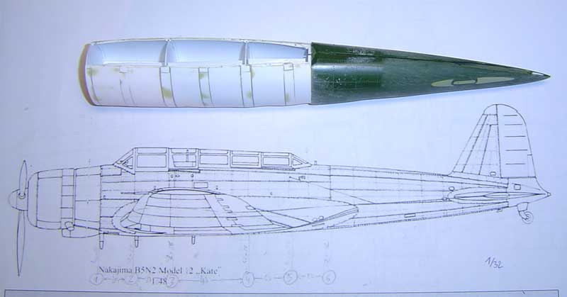

Loic Posted September 7, 2008 Author Posted September 7, 2008 from bottom with details of the skeleton build...

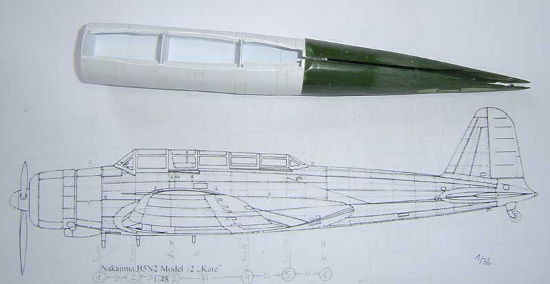

Loic Posted September 7, 2008 Author Posted September 7, 2008 and from top again after putty and sanding action. I am not quite sur the difference is that obvious on the pics but it is quite noticable on the real thing. I would not say it is as beautifull as if it was an injection kit but that will do the job. Next step will be to apply the final external layer of styren and cut both top ends according to plan to claim the fuselage sides built. Details (internal and external) will follow sometime later... Thanks for following. Cheers, Loic
