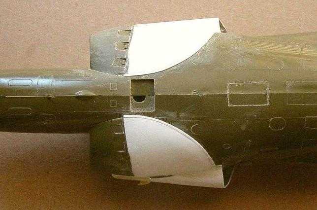

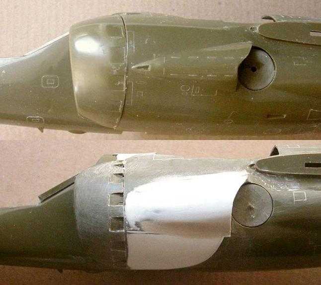

Gene Posted February 17, 2007 Author Posted February 17, 2007 Some styrene 'plates' were added with CA, blended in and then further feathered in with styrene putty. Martinnfb 1
Impatient Pete Posted February 17, 2007 Posted February 17, 2007 Ohhh...nice catch. Looking good. Want pics of the nozzle areas? Nice fix for the fatter intake. I never really looked at the Revell kit closely but yah, it just looked like it needed alot of work and you're doing a good job of proving it. Keep it up, Pete
Gene Posted February 17, 2007 Author Posted February 17, 2007 Thanks Pete! You have nozzle pics - that would help out and maybe of that heat shield just aft of the rear nozzle - those would be very helpful, thanks!

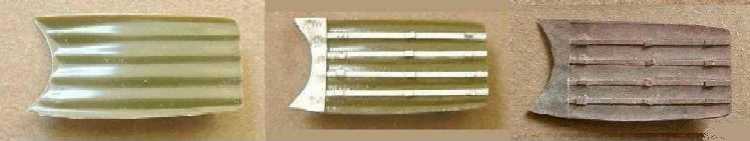

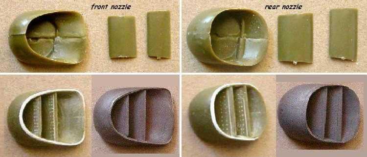

Impatient Pete Posted February 18, 2007 Posted February 18, 2007 Ask and ye shall recieve. Here are some good pics of the rear exhaust area: Pete Martinnfb 1
Gene Posted February 24, 2007 Author Posted February 24, 2007 Thanks Pete for the great color ref! Gives me an opportunity to divert and move along the front and rear nozzles.The front nozzle feeds off the Pegasus' first stages of compression and is relatively lower heat (but is sufficient to boil water) and of coarse the rear nozzle is fed the full-blown hot exhaust gases. The photos seem to show somewhat of a metallic finish but strongly discolored with 'rust' and 'soot' colors depending on front or rear positions. To simulate that I've painted them with a base of Model Master 1785 Rust and then misted some Model Master Metalizer 1405 Gunmetal and 1404 Titanium (both of the 'buffing' variety - though I won't be buffing).And then the rear deflector plate, looks a bit flat in the over cast light. Dany Boy and Martinnfb 2

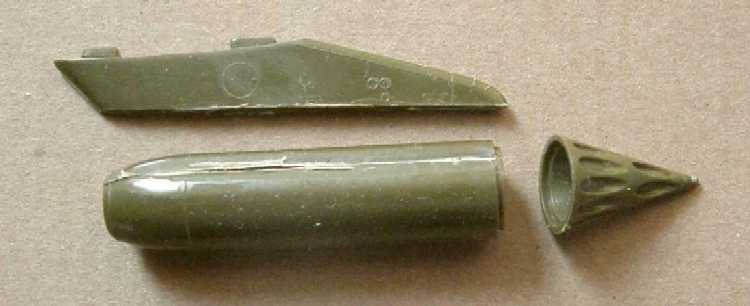

Gene Posted February 28, 2007 Author Posted February 28, 2007 Work continues with little advances being made in diversed areas of the model.Since I really wanted to show this AV-8A with Sidewinders and they are larger than a main gear leg (rule 3e), they had to be scratchbuilt. Luckily finding a plastic rod about the right diameter all that remained was to cut and apply the fins.

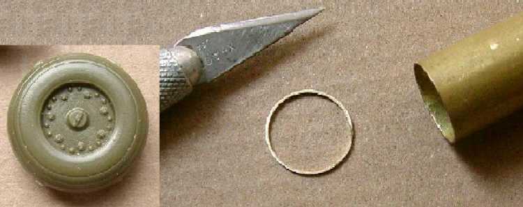

Gene Posted March 14, 2007 Author Posted March 14, 2007 Thanks Ian and ggc - very encouraging and thanks for looking!It is no surprise, the kit's main wheels could use some embellishment. Unlike the other wheels in the kit, the division from wheel rim to tire is without definition and for me is an essential guide when painting. My photo ref also shows more definition, so my first thought was to see if a 'rim' could be cut from a brass tube and applied to the surface.The brass ring was rough-cut from the tube using an X-acto medium size razor saw. The trick to not collapsing the ring was once I broke through the tube with the saw was to continue the sawing on just one side so the saw was almost at a right angle to the tube wall (as opposed to sawing all the way across against two walls). With the rough-cut ring, files and then sanding sticks (supported flat) were used to thin the ring. Bad news, the ring proved to be a bit too large in diameter. But all was not lost!
