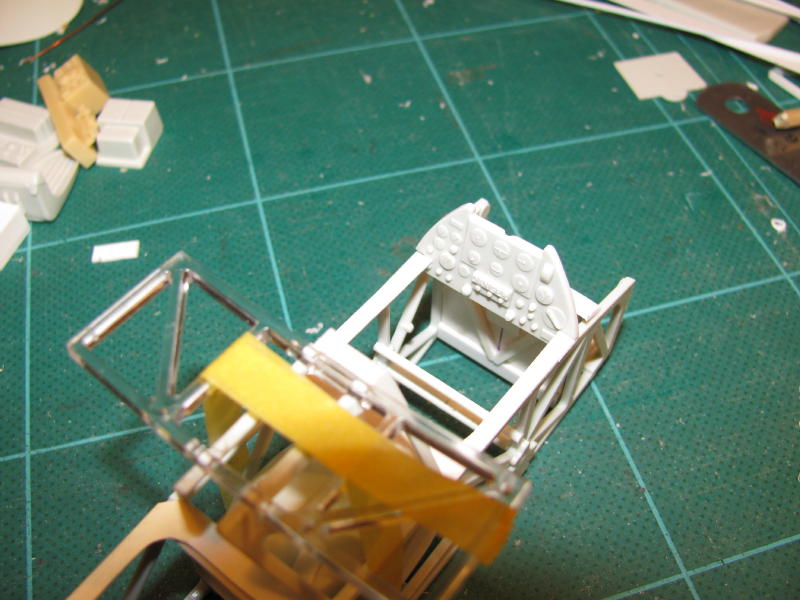

branchline Posted August 29, 2010 Author Posted August 29, 2010 Here's a view of some of the work I've done today, I've cut out upper deck framing for the pilot's and Observer's cockpits, and there is added bracing around the fuel tank and also across the rear frame behind it.
branchline Posted August 29, 2010 Author Posted August 29, 2010 This is the front of the inner fuselage framing showing the combing around the pilots position, and just visible is the bottom of the forward bulkhead I've made (might have to replace the cross framing it's a little heavy). I'm not using the kit's pilot or Oberserver seats as they are wrong, so I'm remounting the control column and rudder pedal mount hence the two bars across the middle of the pilot's cockpit area - more to come on this. The pilot's seat is going to be a real challenge as it's made of tubular framing - but hey, it's just all in a day's work - yeah right!
branchline Posted August 29, 2010 Author Posted August 29, 2010 Last pic for the night, I said those dam slats would annoy me, so off they came this morning, just need to figure out how to fill the large hole and how to make the slat tracks. As much as I wanted a quick build, I'm actually enjoying this... Until next time...
