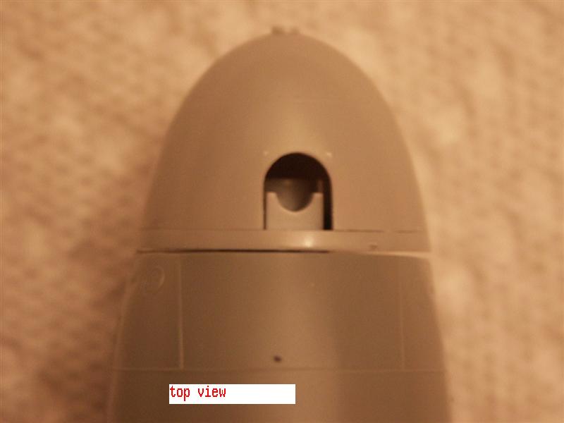

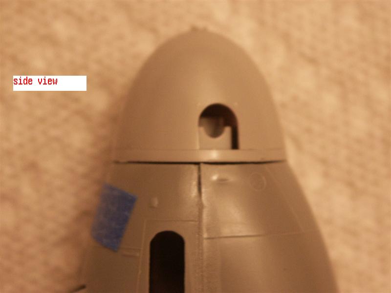

CharlesMetz Posted July 7, 2008 Posted July 7, 2008 --snip--I checked the kit spinner baseplate against a Hasegawa Me-109G spinner baseplate and they were the SAME size! They're even correct scale size. Hmmm, that means if somebody wanted to swap out spinners/props, or add resin replacements with an even more scale profile to the stock kit nacelles....it's a drop-on replacement! Sweet! --snip-- Russ, The Revell '110 G and Hasegawa '109 G/K spinner baseplates are indeed almost the same size ... but not quite: the former is approximately 3/64" (1.2 mm) smaller in diameter than the latter. Unfortunately, this difference is too great to allow a "drop-on replacement," and the discrepancy can't be eliminated merely by sanding the aft part of the Hasegawa spinner without altering its profile appreciably, in my opinion. I hope you'll accept this observation in the constructive spirit with which I offer it. Charles Metz
ruzlkampf Posted July 7, 2008 Author Posted July 7, 2008 Ahhh, cooking up some steak 'n eggs for dinner and I decided to pop in and see if any new info has shown up. Glad to see you're still following this build Charles! Of course I'm taking your views constructively. PLEASE feel free to doubt anything I'm doing, I value your opinion Sir. I am also free to disagree. On the internet, that sounds like a snide remark, huh?! Impossible to tell the inflection and tone of my voice, or see a passive look on my face, or anything. Kinda makes communicating tough without any emotions involved. I am not a combative person Charles, far from it, so I hope you don't read anything into whatever I say. My spinner(s) are not 1.2mm off, and I looked at a tape measure to be sure. That's a HUGE difference in size, and I agree wouldn't fly. Mine are off by the thickness of 2 pieces of 20#bond paper, don't have my micrometer handy, but thats a few .001's of an inch. I really had to squint to see a difference. I can't explain the size difference between yours/mine spinners, but that's what I have in front of me. BUT...I was wrong to say they're a drop-on fit. Why? Because I haven't assembled the nacelle for the "G" kit to see if it really will. This kit doesn't just fall together, and that nacelle might be COMPLETELY different in size smaller/larger than that spinner. This is all a moot point anyway, as the cowl is wrong to begin with, and the Hasegawa spinner is shaped wrong also!. Just want to see if anybody could do this, as I've read that others already have resin replacement spinners and for whatever reason don't want to change their cowls. Information is what this thread is all about, so I'm going to post pics of my results. Be back in a few. Russ
ruzlkampf Posted July 7, 2008 Author Posted July 7, 2008 Okay, experiment went WAY better than I expected. I was using macro extreme magnification so everybody can see that the Hasegawa(or I guess replacement resin spinners?) spinners are a BETTER fit than the kit spinners on my "G" kit engine cowling. WHOA. Of course, this won't work on the "C" kit cowling as the spinners are much smaller. I didn't shave anything down, or make any mods to get these to fit. Just slapped glue on them. Here's the pics;
ruzlkampf Posted July 7, 2008 Author Posted July 7, 2008 Lemme see if I can get all 3 pics together here.

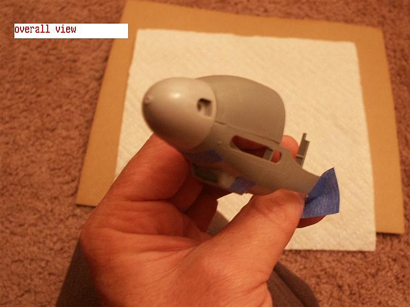

ruzlkampf Posted July 7, 2008 Author Posted July 7, 2008 Shoulda tapped the spinner over just a literal hair in the top view as the glue was still wet, but it is an exact fit width-wise as well as vertically. Here's an overall view if somebody is wondering what it would look like. Wish I had my replacement resin spinners so I could see how it would affect the contours. Not too terrible the way it is, sure is an improvement on the kit spinner.(IMHO) So, it appears to be possible to do this. I want to emphasize that this is not a "I'm right, everybody else is wrong", as I will be the first to say I don't know a damn thing about ME-110's, but I'm a fast study. I'm only going by the information I have in front of ME. As an example, I now have 7 sets of plans. 3 of them say that the wingtips are squared off more than the kits, 4 say the kits are correct. Do I say they're correct cause most say so? Phhht!, they might ALL be wrong for all I know. So I'm looking at pics of the real thing(hard to find a top view BTW....Charles, ya got any info to bail me out?...I'm stuck) So if Charles, or anybody else has ANY information/dis-information, good or bad, let's kick it around... it ALL helps! I'll be the first to say,"whups I'm wrong", and everybody is free to doubt my changes. I want them to pass the LSP Test!!! Gotta get back to my (probably wrong) engine cowl mods! Later, Russ P.S. If anybody wants more pics of this spinner/cowl thing from other angles/magnifications for your build, let me know,OK?

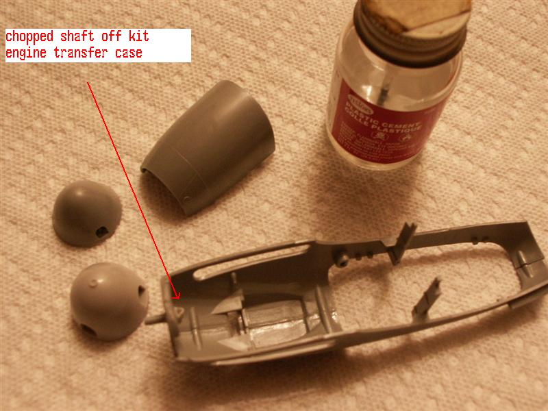

ruzlkampf Posted July 8, 2008 Author Posted July 8, 2008 Shot of my dummy engine and spinner to show what I'll be working on tomorrow night. Whoohoo! This is a crude attempt to show ya'll what kind of profile I'm going for. Getting to the fun part now.

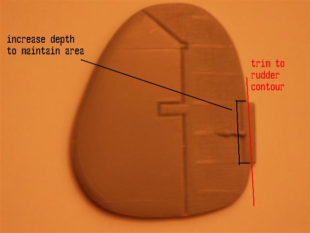

ruzlkampf Posted July 10, 2008 Author Posted July 10, 2008 OK, after all the quibbling confusion I just put everybody thru , I had to show ya'll something that I KNOW is amiss. Bwhahah. If you're doing a 'small rudder' AC, you need to trim off the trim tab to conform to the rudder profile, and add re-scribe more surface area into the rudder itself. Also, in my previous pics I showed adding external trim tabs on the ailerons. This is correct for a 'G'(hmm, maybe a late 'F' also?), but is not needed for the earlier versions. I always like showing at least one pic if I add to this thread. This is pretty pitiful, but useful info nonetheless. The nacelles are going great, and I wish I had more time to post pics, but real-life has intervened, and I won't be able to post until Friday evening(SoCal time). Blast! See ya'll then! Happy modelling, Russ
ruzlkampf Posted July 10, 2008 Author Posted July 10, 2008 Dooooh, You beat me to it Dan! , You speak words of power and truth. Was looking at yet more pics of this plane before going to bed, hoping they'd talk to me and reveal yet more secrets....or SOMETHING. Wanted to edit my last post, as I'm wrong about the above rudder mods, sorta. I have seen pics of these enlarged trim tabs on DB-605 powered (late F...early G's) ME-110's. Maybe an interim solution to the increased torque before going with the larger rudders? I don't see them on any of the early versions, and sporatically on the late. Aaaaagh. I'm going to run out of here screaming now!!!!! I used a razor saw for the vertical cuts, and a hooked/scooped dental pick looking engraving tool that sucks for that job but works great for curved cuts on the horizontal. The plastic on this kit cuts like a bar of soap literally, and it only takes a coupla swipes/cuts to do anything. Kinda cool for a change. I'm still going to be doing a lot of cutting /mods on this kit to follow known dimensional differences, it's just too complicated to explain everything in any detail...except as I go along. So if anybody is interested in how to screw up big time on chopping up a perfectly good me-110 kit, stay tuned! Hah!
